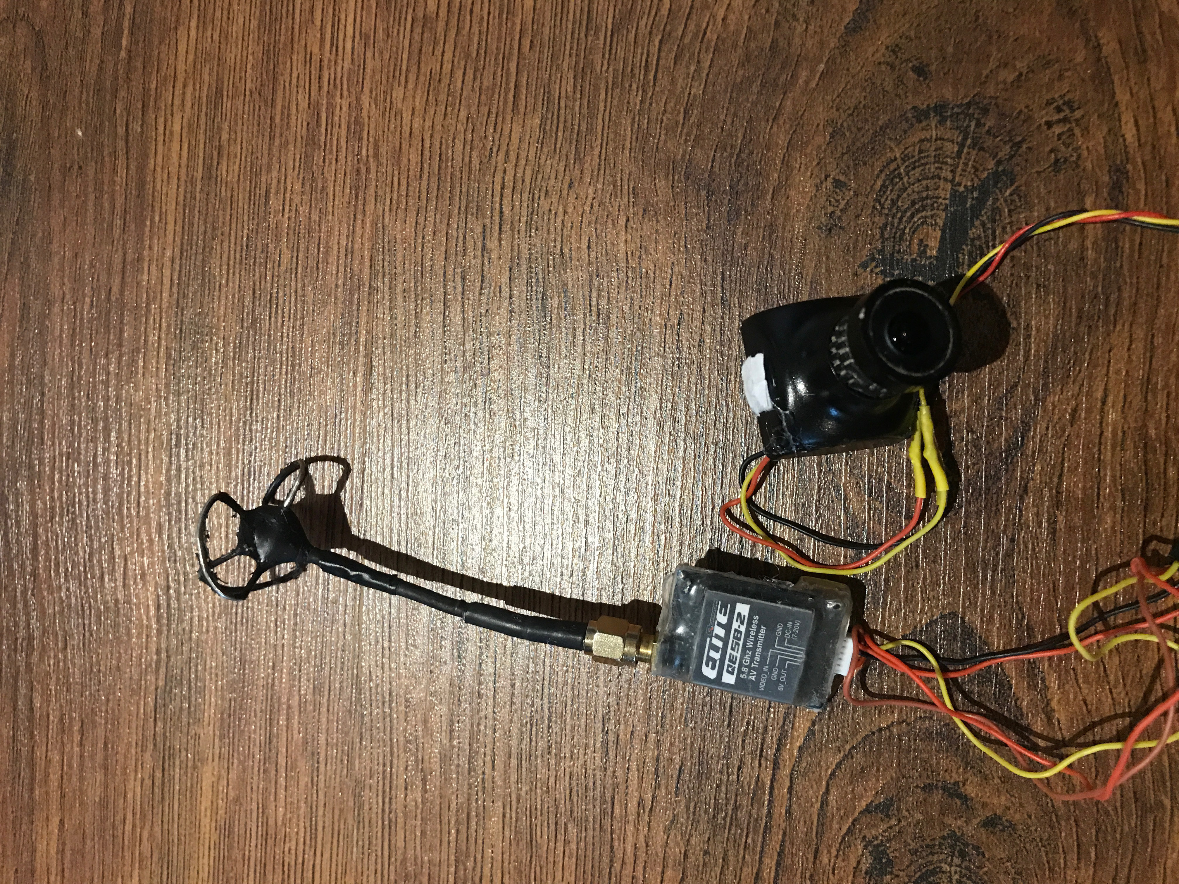

are the VTX and monitor antennas compatible?
because I have a patch antenna but I'm afraid to use it on my monitor (don't want to burn it because I used the wrong type of antenna).
@LitterBug ?
You won't kill a receiver by using the wrong antenna. The worst that will happen is you could have reduced reception/range if it doesn't match the polarity of the antenna on the transmitter.
You can kill a transmitter by running it with no antenna or shorting it out.

Will the antenna with the red work for the monitor?
