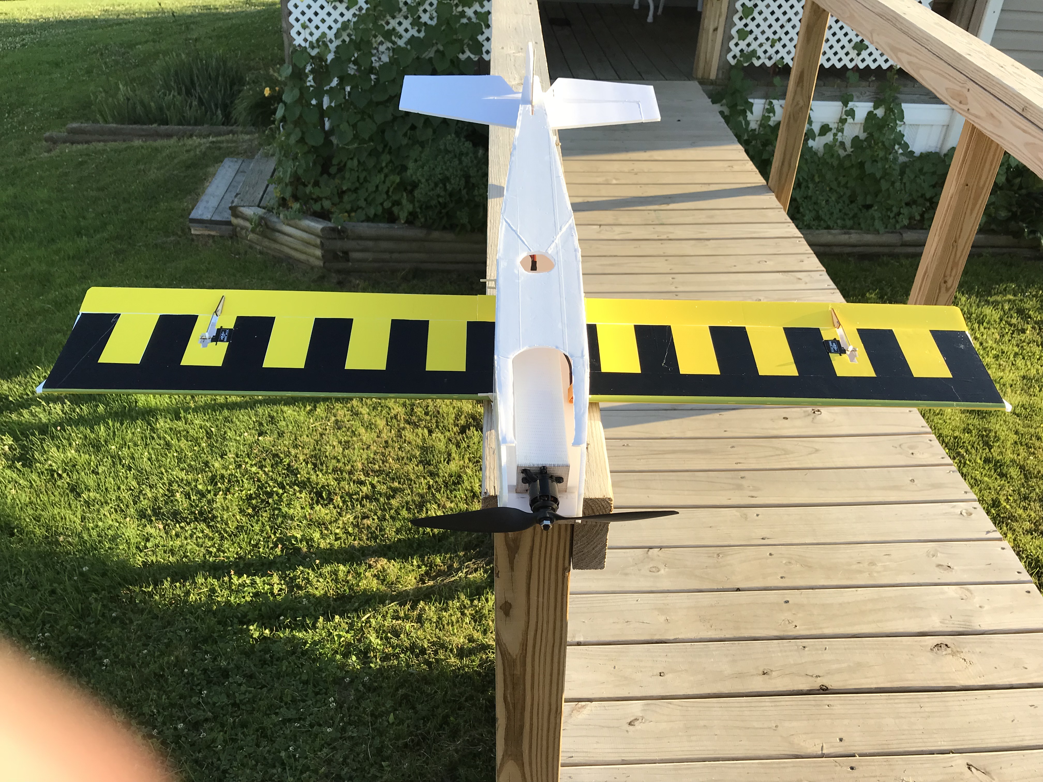

Zimbotiger
Check out this modified version.
That is , a lovely mod. Thanks, for sharing. I will certainly try those mods for my Bushwacker. Thank you. Esp. The better wing. Both my wing tips, are bent and warped, and I need to change, mod them like you have done. 1. Full length spar. 2. Bottom of wing extend to the wing tips. 3. Wing tip caps like your.
