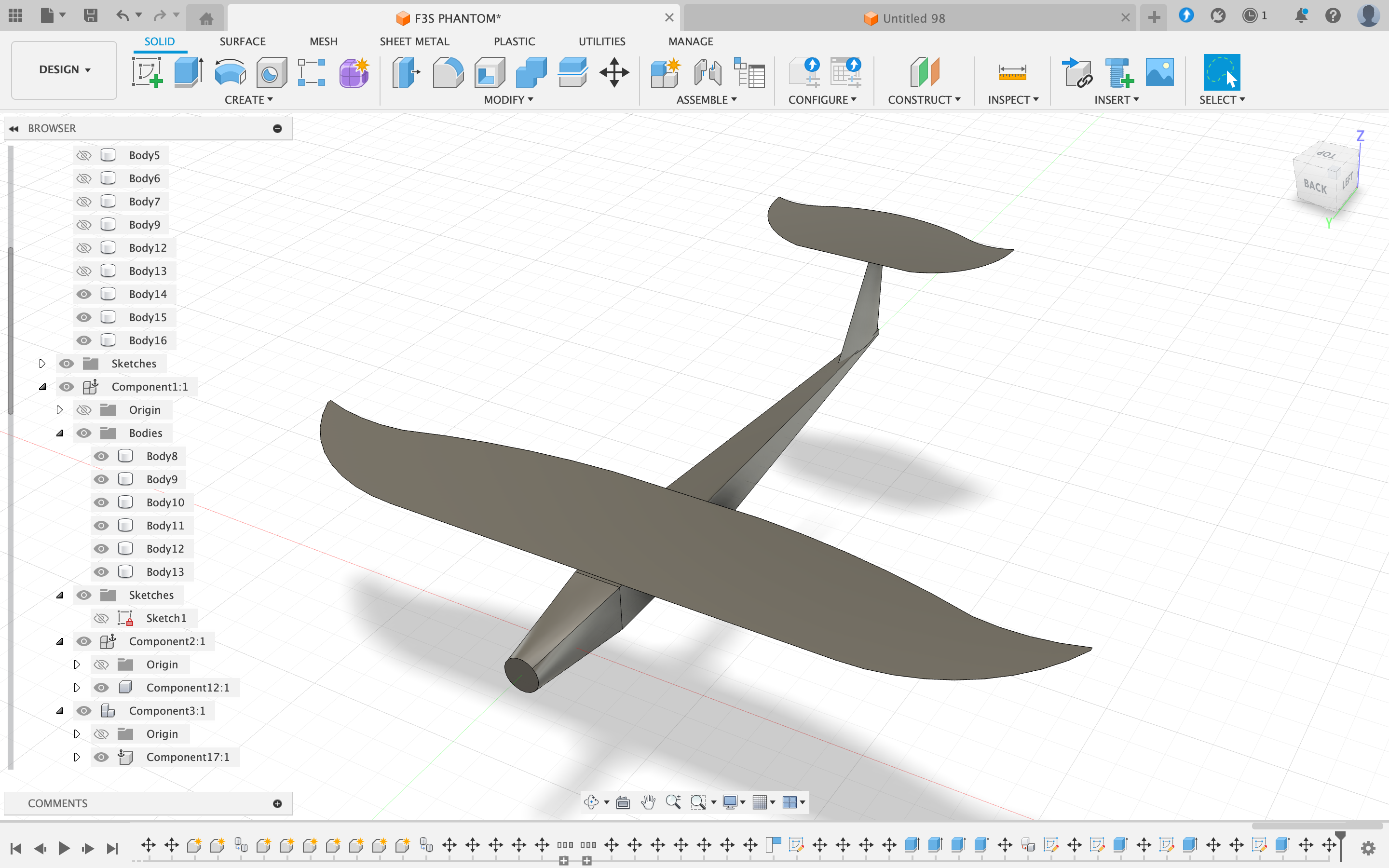

And also question is it easier to make a large rc plane go fast or a small one ? If the answer is small then why are all high speed rc airplanes relatively large for example.
I know these airplanes aren't MASSIVE but they are still quite large I was looking at my design and saw that my airplane is actually a bit smaller then the above aircrafts.

Mostly going really fast means it gets really small really fast and you want to keep orientation. Can't fly it if you cant actually see which way it's going, or if there are things in the way. Really big takes longer to lose that orientation. Unsure if FPV changes the small fast problem as I haven't flown that way. It might as long as you have signal and control
Wouldn't say bigger is more stable, but bigger does tend to be less sensitive to odd wind gusts. Then there is Einsteins law E= Mc2
Maybe, I guess it’s because when you scale up, wing loading generally goes down, resulting in a more stable plane. Bigger planes can also hold the massive motors these speed guys use @Zoom Master
