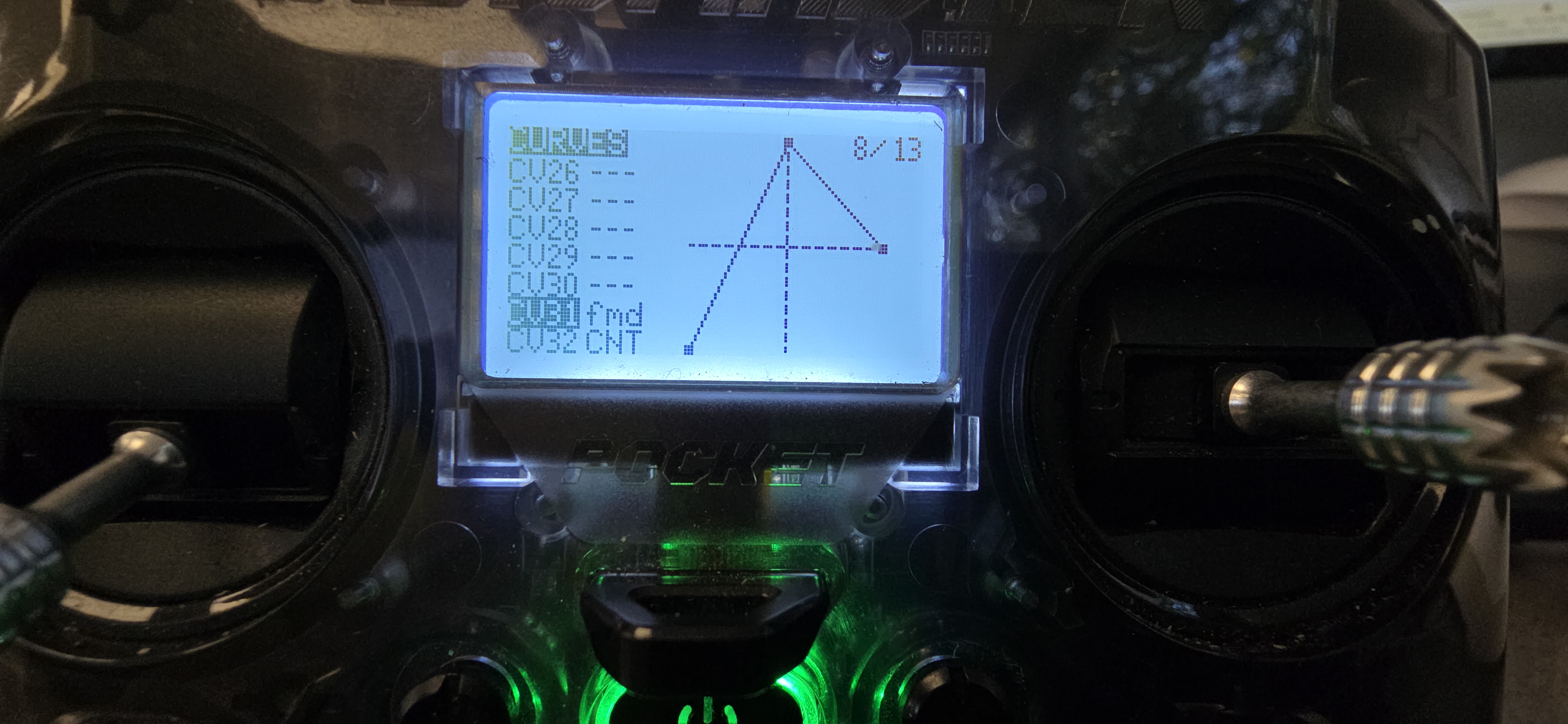

Example with a curve in the radio.

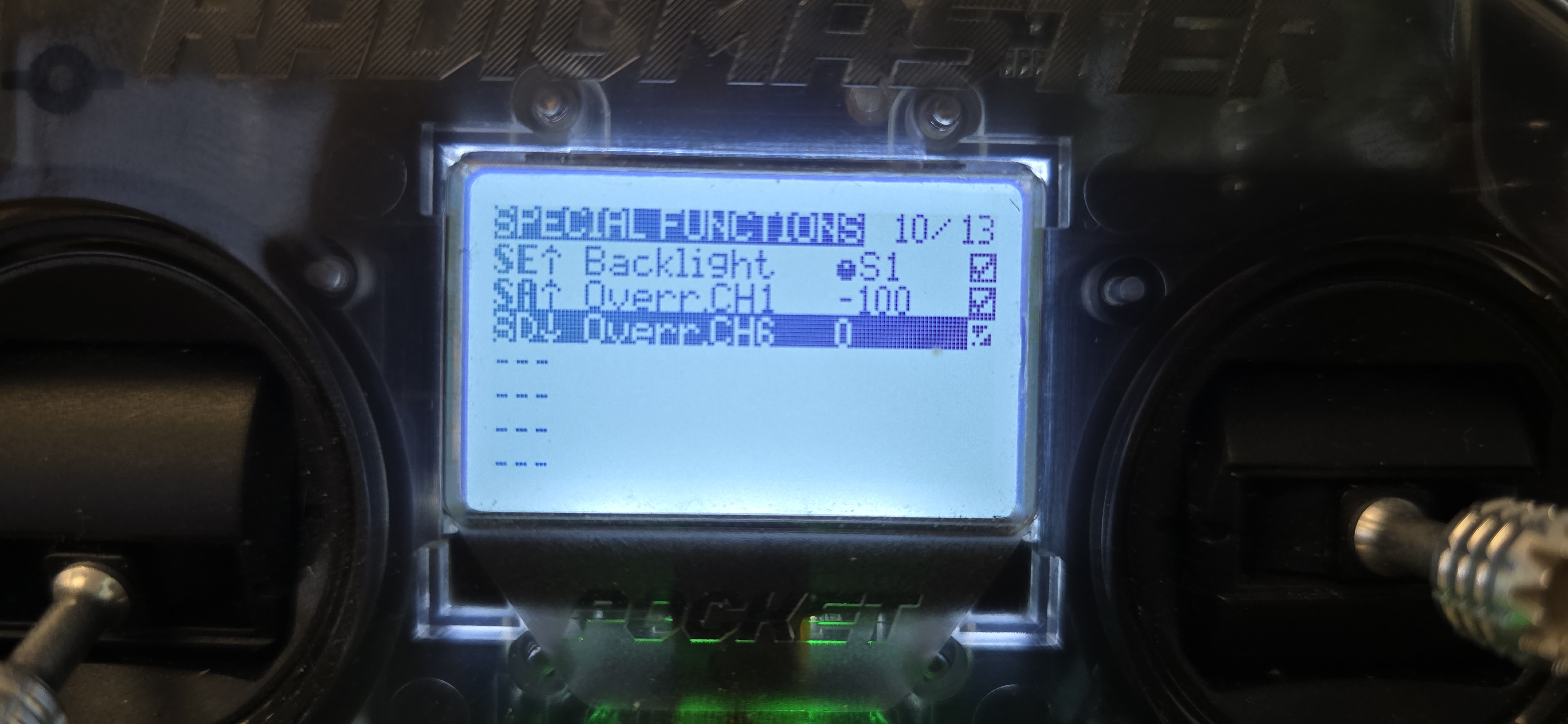

Here I did a panic switch override. When SD is flipped, it overrides my Flight Mode switch to the mid point.
You can also see my throttle cut on SA which is my arming switch. It overrides the throttle with -100 when not armed.
