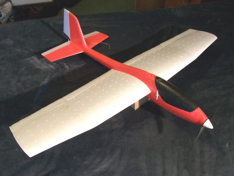

I did a power conversion on the big Lidl chuck glider.
My aim was not to see if it would fly but just how good a glider it could be. In other words I modified some of the basic Lidl features that would effect its glide performance and then added a power unit that would give the least interference to the glide.
This what I ended up with.
The light 18g motor is fully faired in with the folding prop spinner. It uses an 850mAh 2s LiPo.

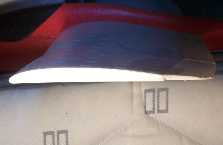

The other notable changes are the printed "extensions" to bring the wing and tail trailing edges down to less than 1mm compared to the 3mm of the original mouldings. For maximum efficiency an aerofoil should taper to zero at the trailing edge.;)
Theses extensions also increase the wing and tail area slightly particularly for the small outboard ailerons.

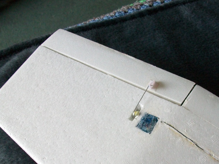

The 3.7g aileron servos are imbedded flush into the wing as is the servo wire.

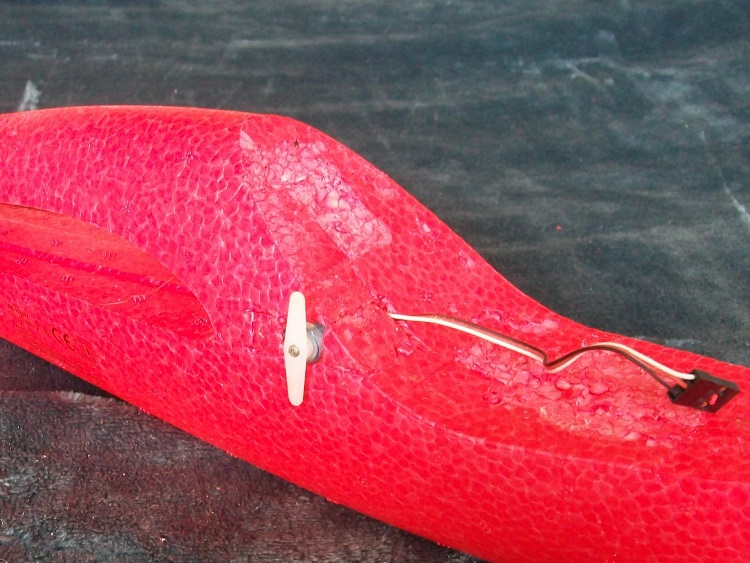

To save tail weight the elevator servo is also embedded in the fuselage just ahead of the wing with long pull/pull nylon lines to the double sided elevator horn.
Very light and mechanically efficient. The Lidl is flown AET so there is no rudder.
The end result is it only weighs 220g ready to go.
No rocket ship it flies quite slowly but has sufficient power coupled with its reasonable aerodynamics to easily perform simple aerobatics.
