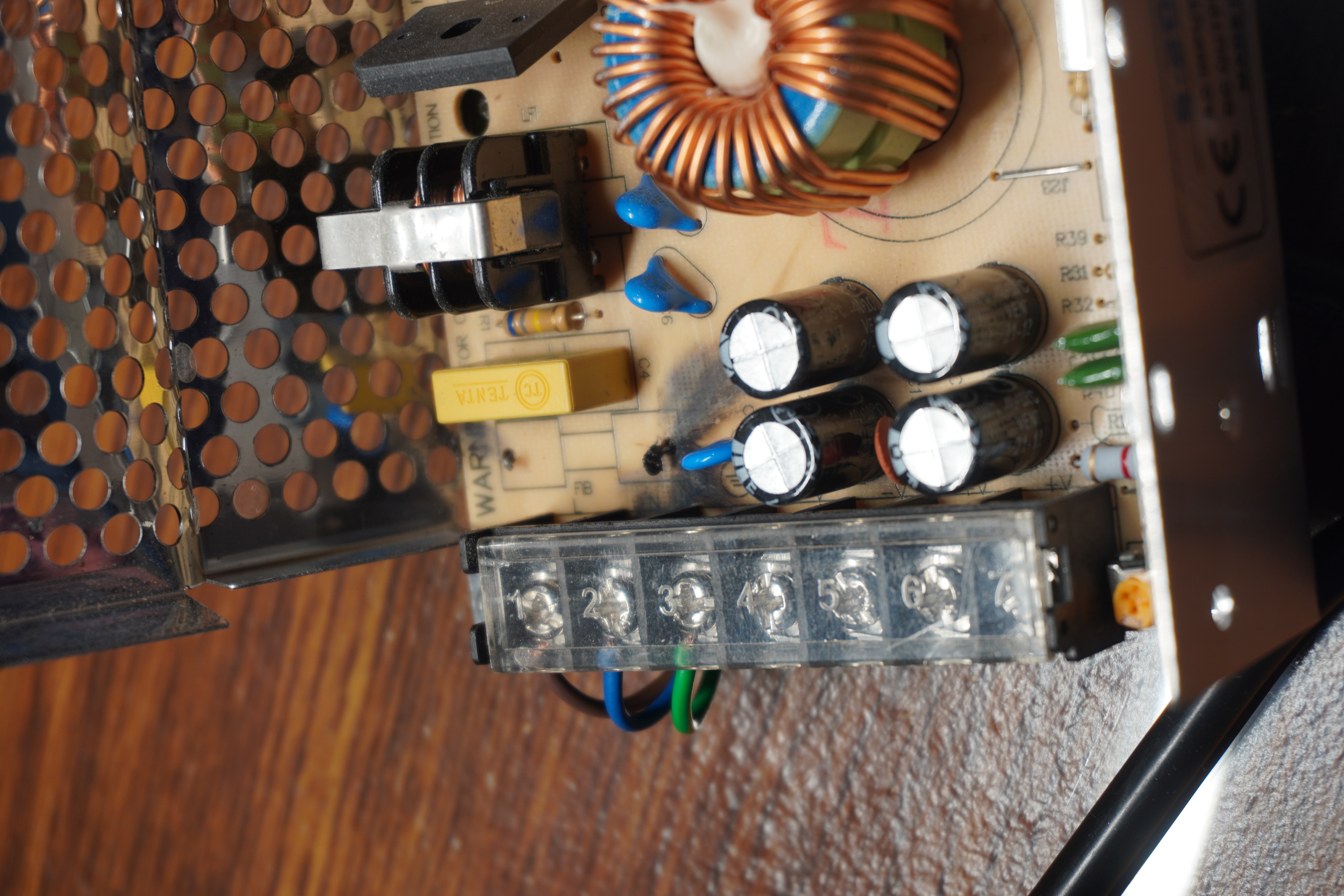

Rats! Looks like my power supply is a return😆😆

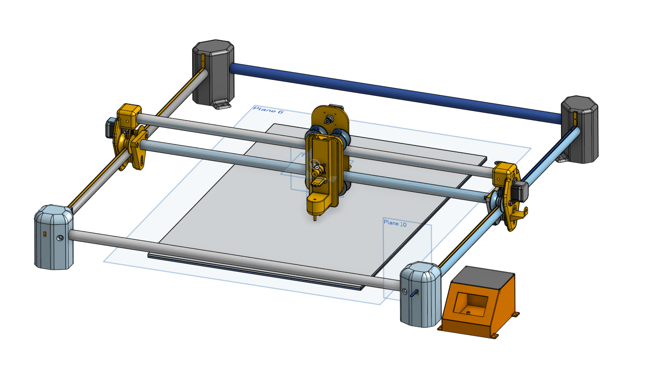

So, a little change of plans....This was getting too expensive for us and we were considering calling the whole project off then we remembered that we have about 50ft of 3/4" gas pipe from when we did some remodeling in our house a few years ago.....We are going to use that for our CnC rails as that's free and will knock about $50+ off! Also we won't need V slot wheels as I will be printing out custom wheels. So this is what I have so far with the new design:
So I have tried that, and I can tell you, it only works slightly. It is hard to make such rollers precise enough for no shake. I have taken to borrowing tolerances from airsoft balls. 3 lines of them gripping they pipe would be better I kind of planned on making something like that but with 1 1/2" for the main frame. Would you happen to want to collaborate on this?

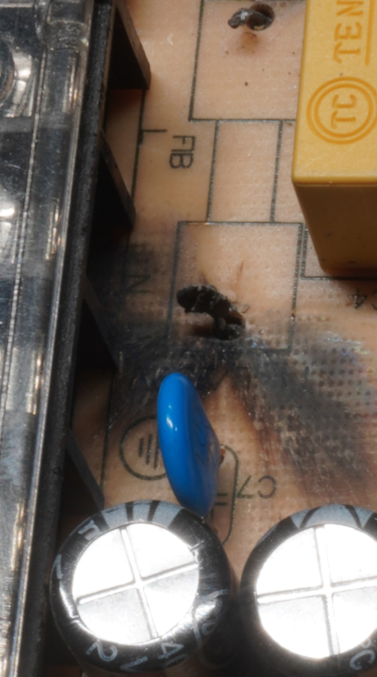

I kinda wanted to try plugging it in and see what happens....But then I might be able to get a refund😂😂
Looks like something was shorted out if it blew that hard. Possibly hooked up wrong by the previous "tester" or hooked to bad hardware. The missing part could be a Fuse looking at the board.
Working on printing out one of the sides of the gantry so I can test it👍
