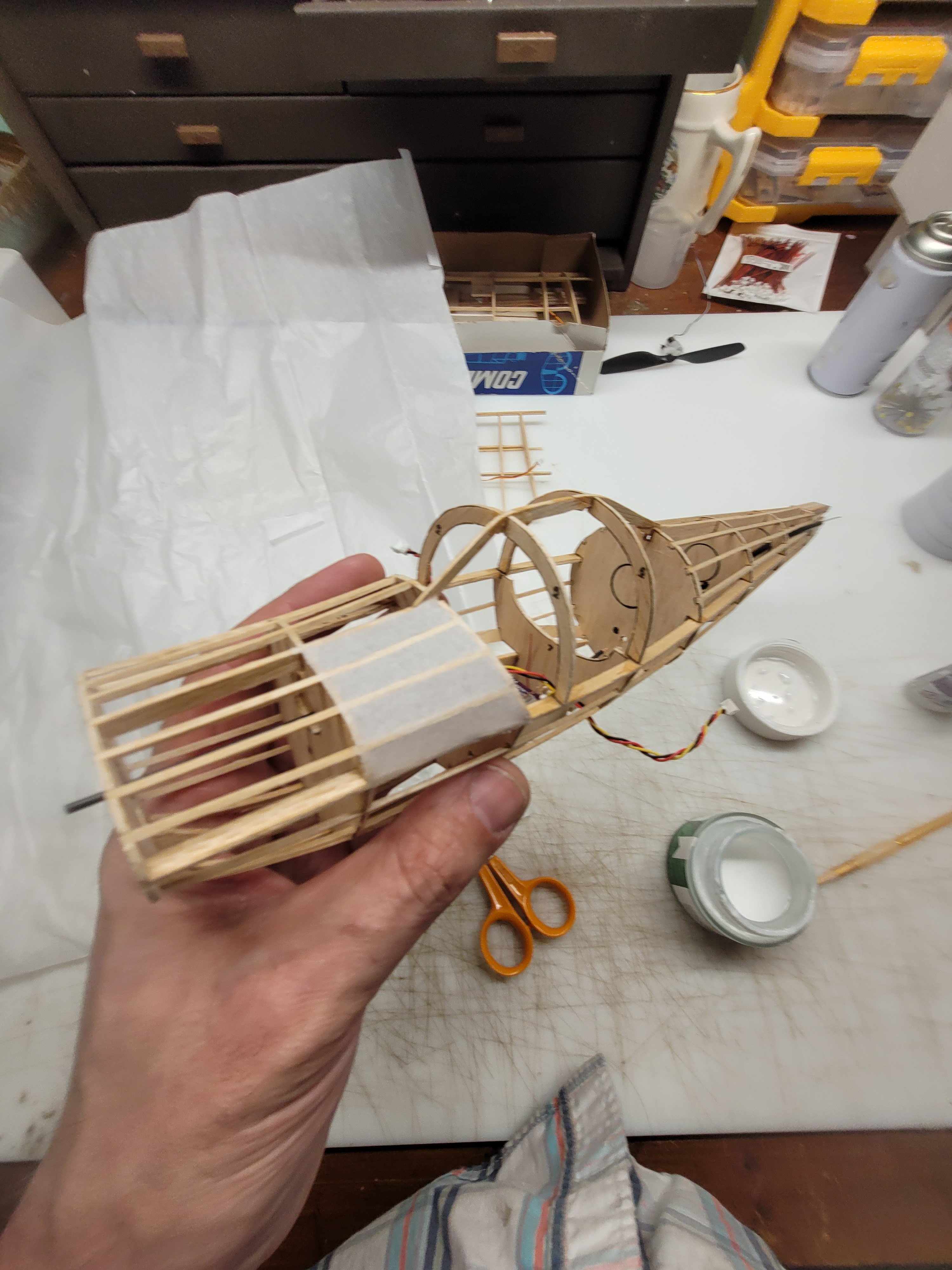

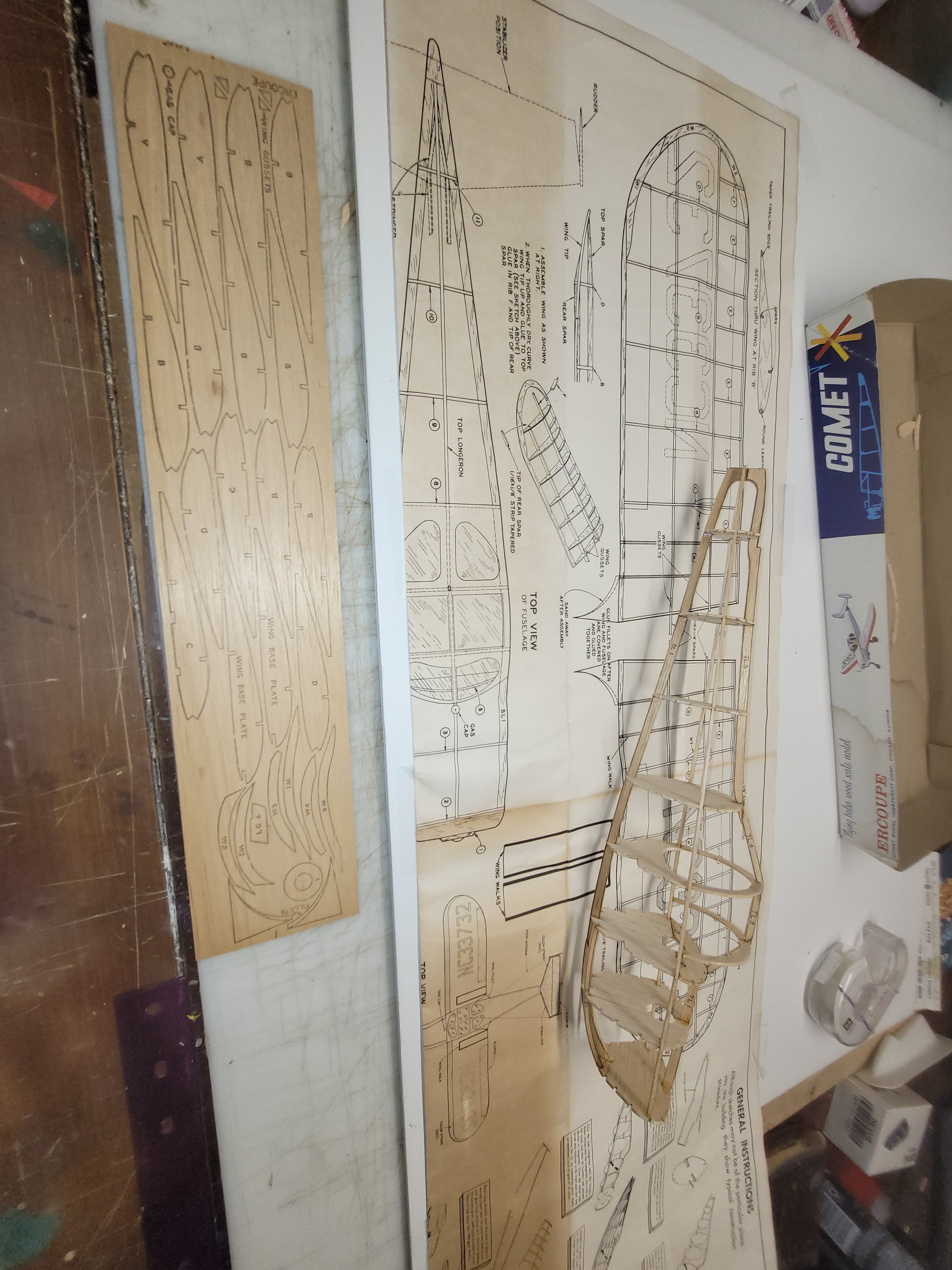

Fuse is started, but I'm waiting on radio gear before I stringer it up. It will be substantially heavier than the aeronca, I think. More formers and bigger ones at that, but also a longer chord, so more area. Let's hope it's a wash. Time to cut some ribs...

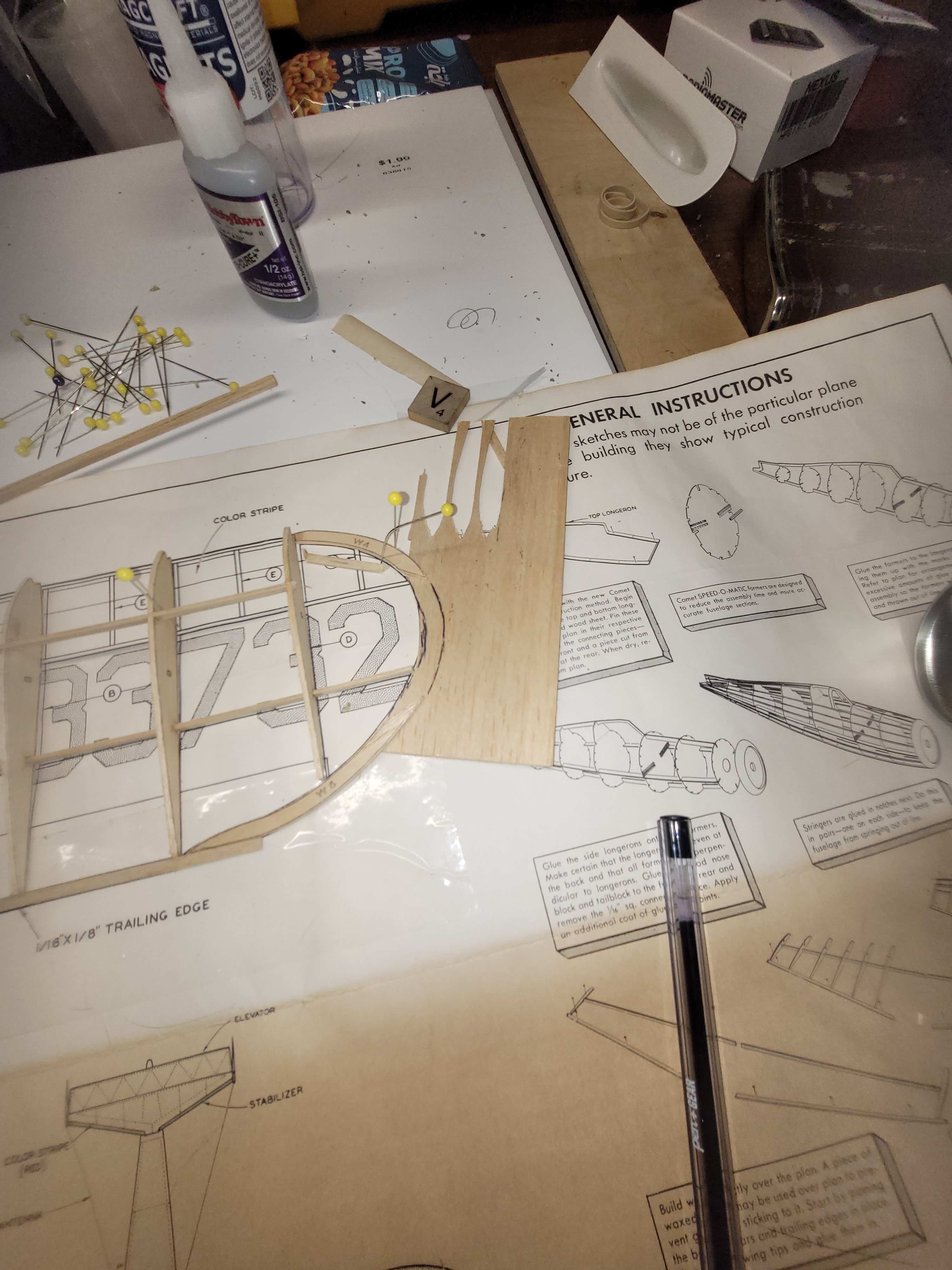

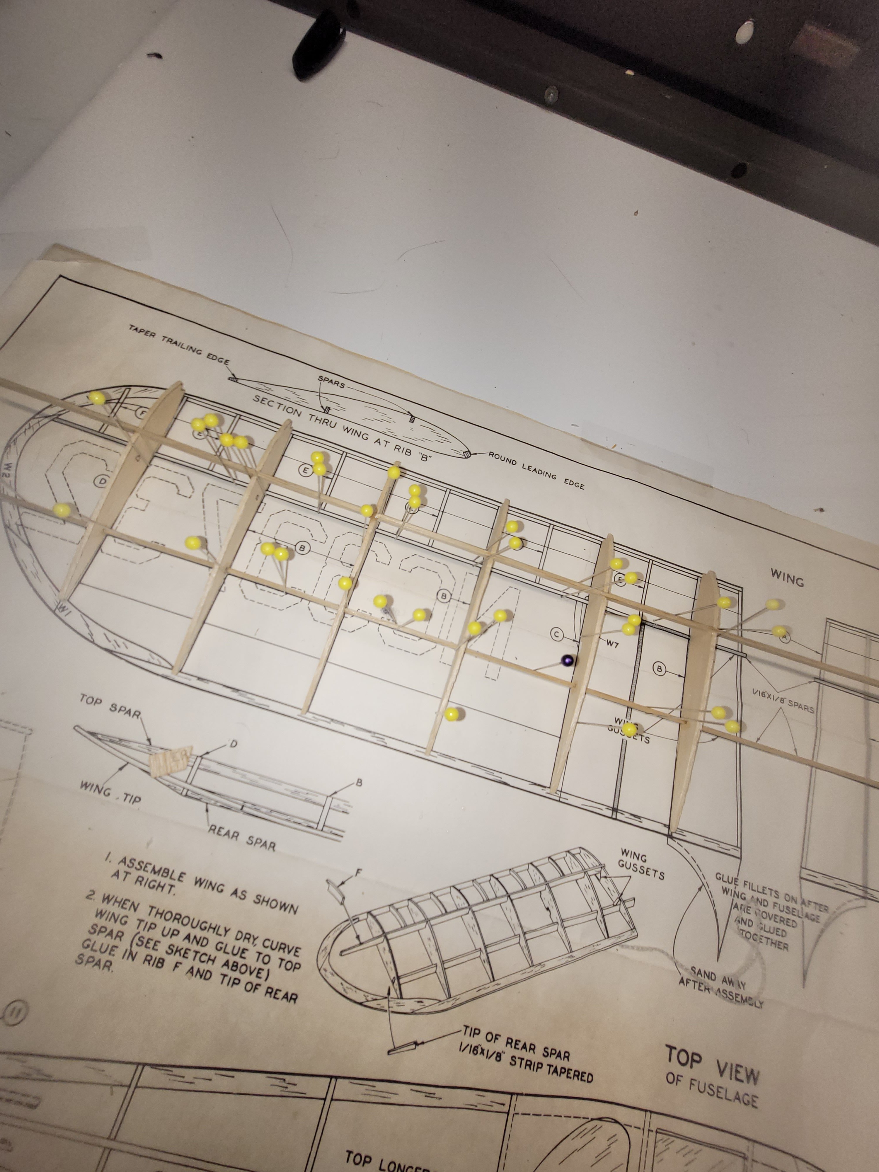

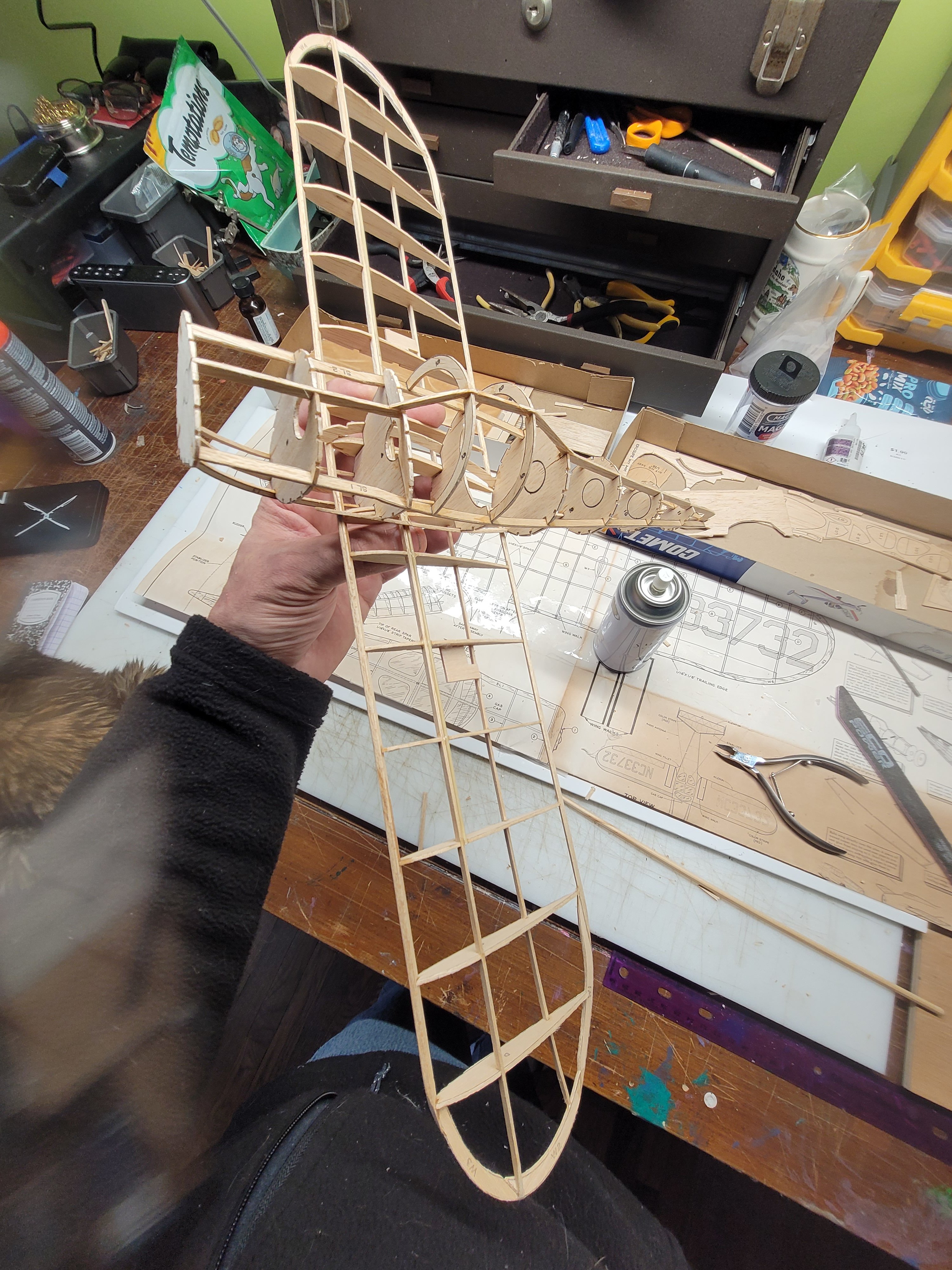

She's coming along, just a few hang-ups, like my misplacing of wingtip piece #5 (not ruling out feline intervention) so I had to fudge out a new one. I use the Scrabble letter as a mini square for the ribs. Look how on the tissue you can see the chemical shadows of the wheels and the rubber string. I find this foamboard to be a far superior pin-holding platform than corrugated cardboard like I used to use. I use medium and thin CA with "Zip Kicker" accelerator. It does not damage the plans or finished tissue, but it does mess up the celluloid and the scent annoys the wife.
If you look closely in the last pic you can see the fiberglass rod that I use to double the upper spar to the 4th rib. This is actually called "tracker rod" and it is from a mechanical pipe organ, which is what I built for the first 20 years of my working life. One job's worth of tracker cutoff scraps will supply an aeromodeler with pushrod and spar stock for life. You can also burn the end briefly and it will become a mini brush.
