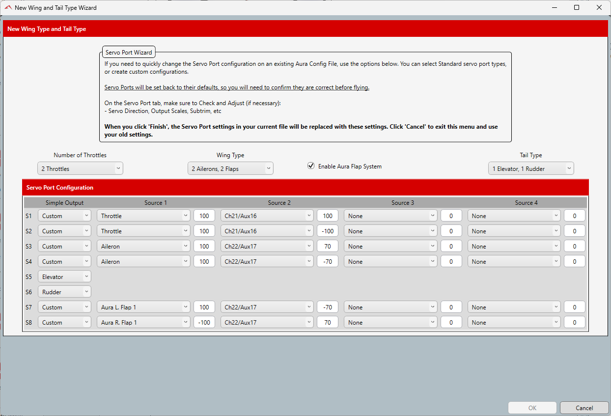

Flex does have some planes with crow. They have aura 8 boards in them. Looks like they do it with a crow enable switch and mixing throttle from 0 to 50%. 0 throttle being full deployment. half throttle and above no crow. Would you want to set it up like that or on a separate slider/knob?
We could probably reverse engineer the config files from one or more of those planes, or swag our own mix.

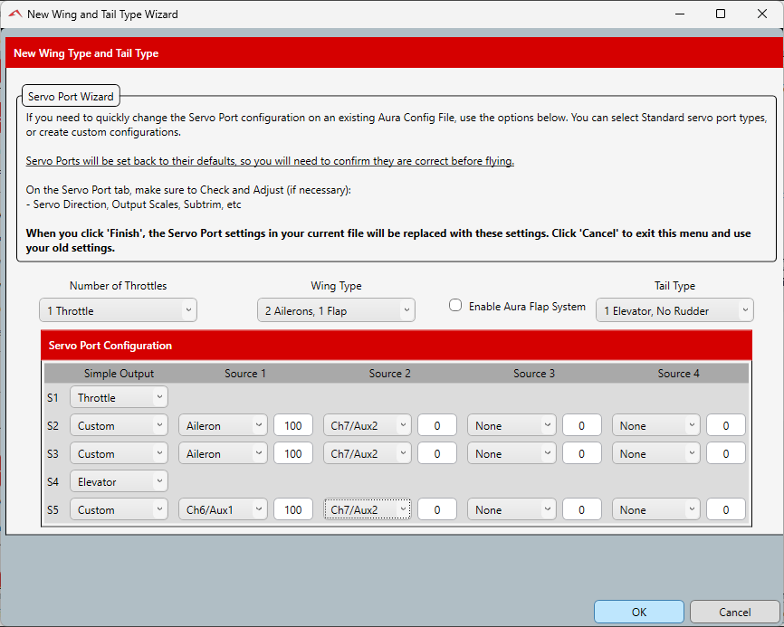

I'll try to swag it over the weekend on a 5 that I use to mock up and test with. I don't have an 8 at home.
1) Thr
2) L Ail
3) R Ail
4) Ele
5) Flp
Should be similar to Elevon mix, just with flap instead of Elevator. So Flaperon going up instead of down. Hmmm.....
Just a quick jab before going to bed. Need to adjust weights and actually test it out. Could ground test it on my Phoenix 2400 glider after mocking it with some servos.
Played with this a bit on an aura 5 and the aileron part is easy. I could easily do it with a hybrid aura/radio flap mix, but would like to figure it out all inside the aura. Going to look at some of the aura setups for Flex Innovations planes that have a crow setup to get some more insight.

There really are a lot of possibilities. I like the way flex does it on their own aircraft they make it where if you’re over a half throttle there’s no crow and then it’s proportional down to zero throttle. I think if I get where I understand flexes logic as well as I do edge Tx there’s not much you can’t do with it. There just isn’t much documentation.
So I think using aura flap instead of assigning and RC channel to the flap servos is part of the crow setup.....
