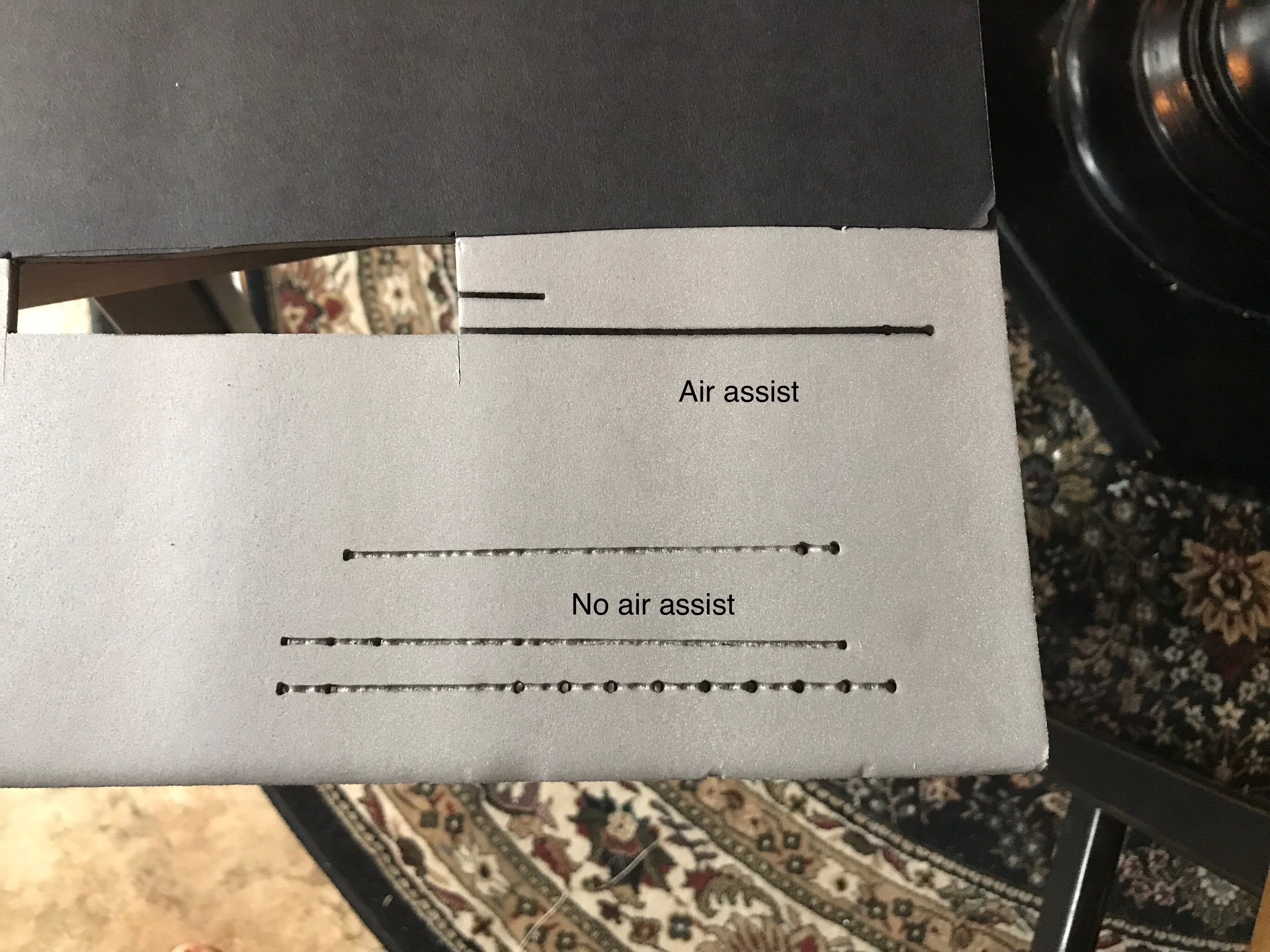

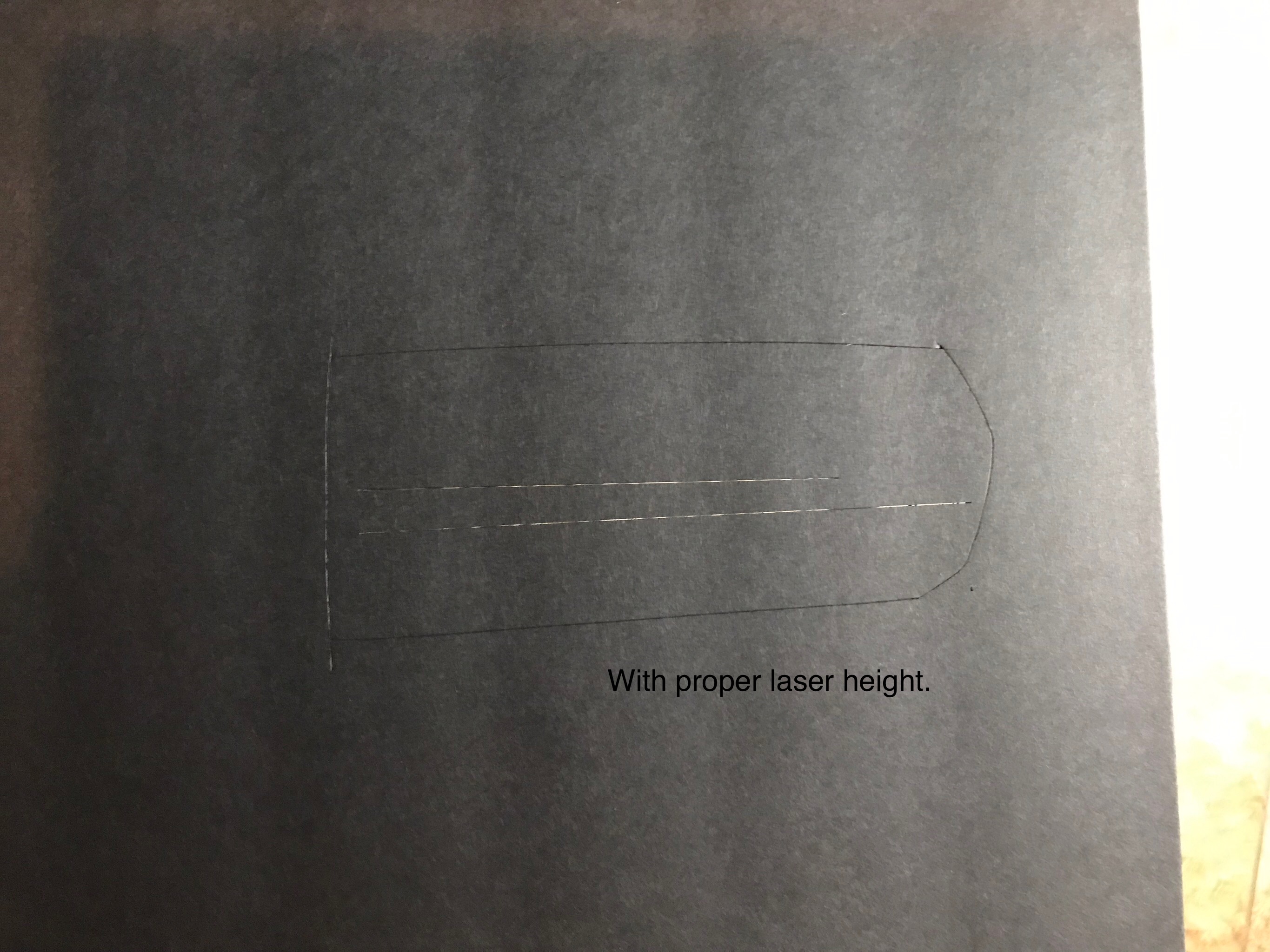

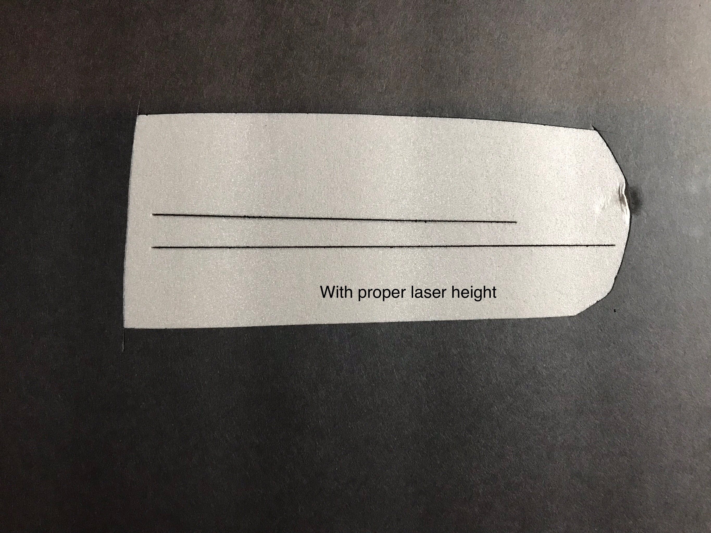

Cool! (BTW as far as the lasregrbl...I have heard that Orca slicer can help with that! JKWell folks, it’s time for an update…. I manually did some testing today (my laser has a touch screen control panel) and tried cutting some black dtfb. I first did some testing with and without air assist at 100% power (see first pic) and then remembered to set the laser height. And tried it at both 50 and 100% power. Both cut cleanly. (with air assist on) So now I just gotta figure out lasergrbl 😂
Glad you peeled the paper back and it looks clean. Some of my results (pre air assist) looked good with the paper on, but horrendous under the paper. Cutting on honeycomb helps too so the air has somewhere to go other than lifting the FB.Well folks, it’s time for an update…. I manually did some testing today (my laser has a touch screen control panel) and tried cutting some black dtfb. I first did some testing with and without air assist at 100% power (see first pic) and then remembered to set the laser height. And tried it at both 50 and 100% power. Both cut cleanly. (with air assist on) So now I just gotta figure out lasergrbl 😂
I made stone 1” risers for the foam 👍 works the same as a honeycombGlad you peeled the paper back and it looks clean. Some of my results (pre air assist) looked good with the paper on, but horrendous under the paper. Cutting on honeycomb helps too so the air has somewhere to go other than lifting the FB.
