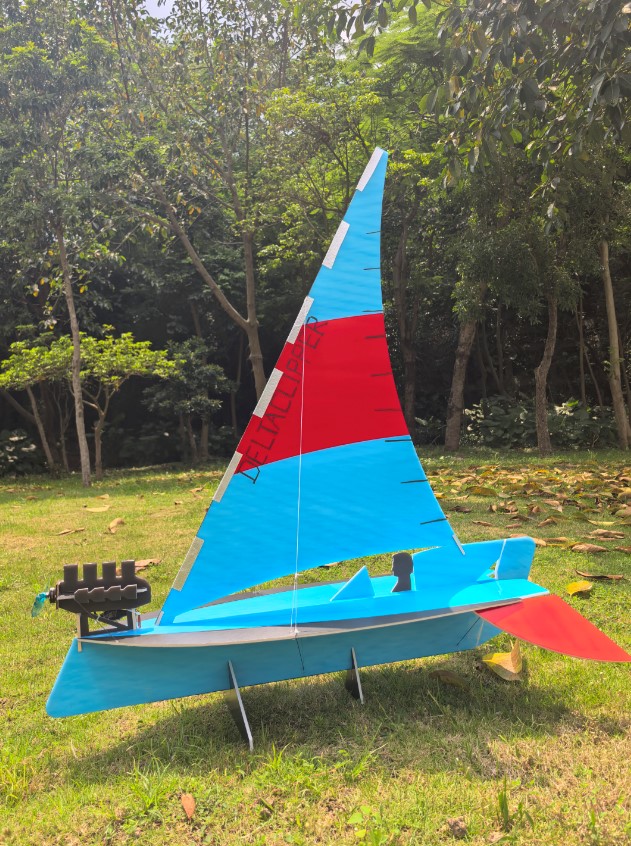

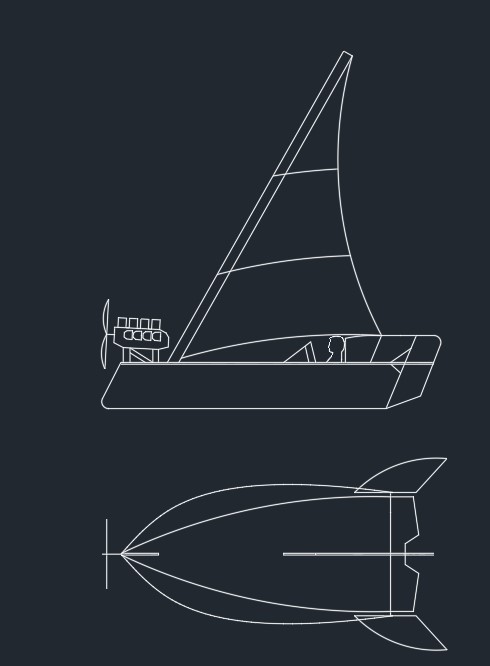

图纸见附件,用600*400mm KT板切割拼接。
建议用更大的板子整体切割。
Video:
【【飞行帆船】柴油朋克风格的运动飞机DeltaClipper三角快帆】 https://www.bilibili.com/video/BV1e...eb&vd_source=20725c427f2b96843114abb46d4b4663
This is a Crazy Mad Aerobatic Flying Ship.
it will never stall, never wing rock,ultra stable and high manuever.
Add some magic to aerodynamic so a sail ship can fly.
Huge sail makes big lift at turn, and low aspect ratio ship like wing makes very high stall aoa.
weight<300g
span 550mm
length 930mm
AM40 motor with T/W ratio>2
Only rudder and elevator,3CH is enough.
