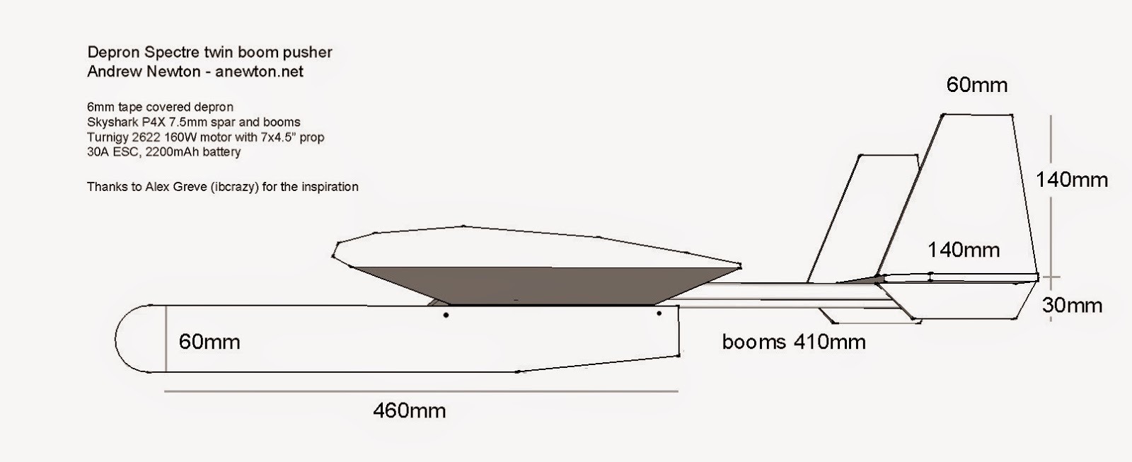

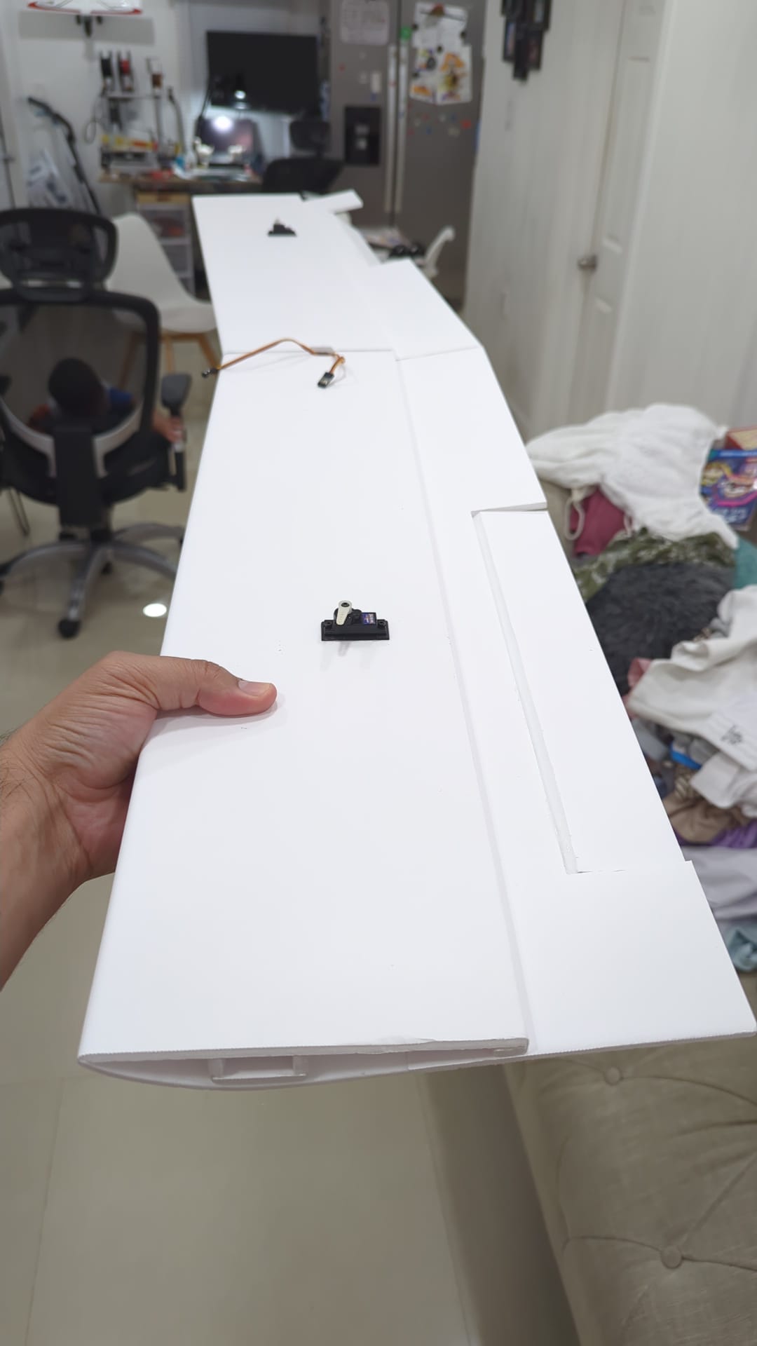

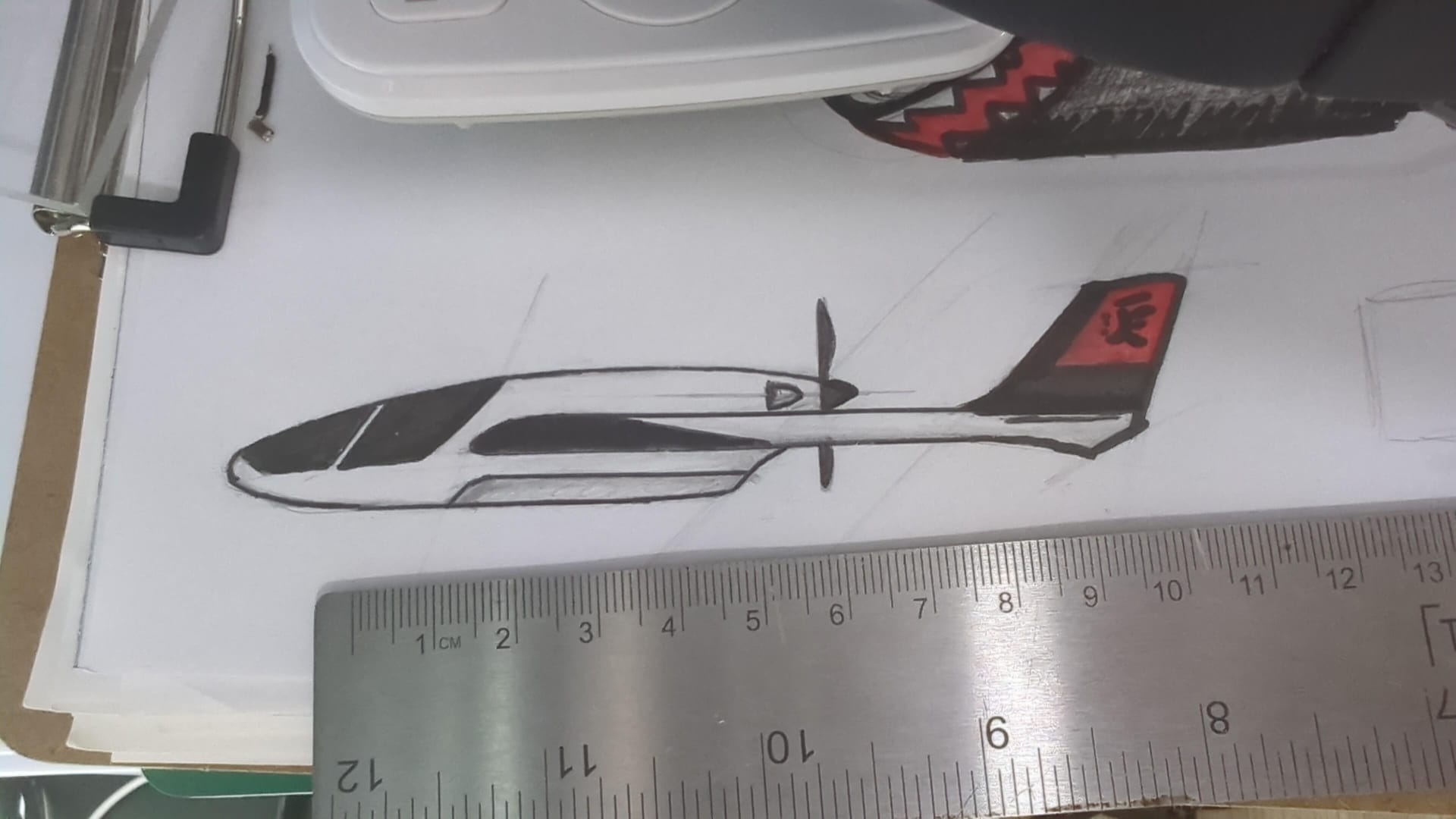

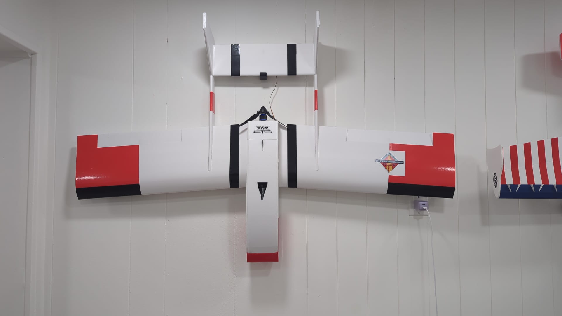

Hello friends, it’s been a while since my last post. A little while ago, I was searching for a pusher‑style FPV model that combined stable flight characteristics with agility. After some digging, I came across the Depron Spectre, which seemed perfectly adaptable to foamboard, so I’ve been working on it for the past few weeks.

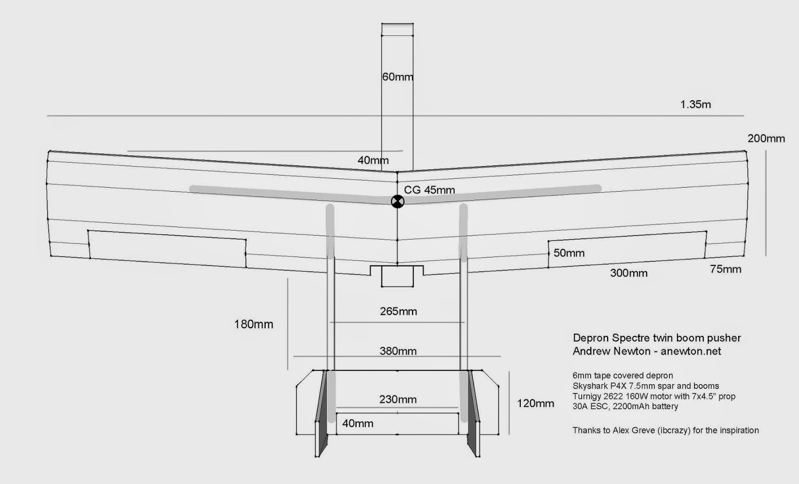

I haven’t taken many photos of the build process itself, but this is the model I’ve been following. You can find more information here: https://newtonairlines.blogspot.com/2014/07/13m-twin-boom-pusher.html

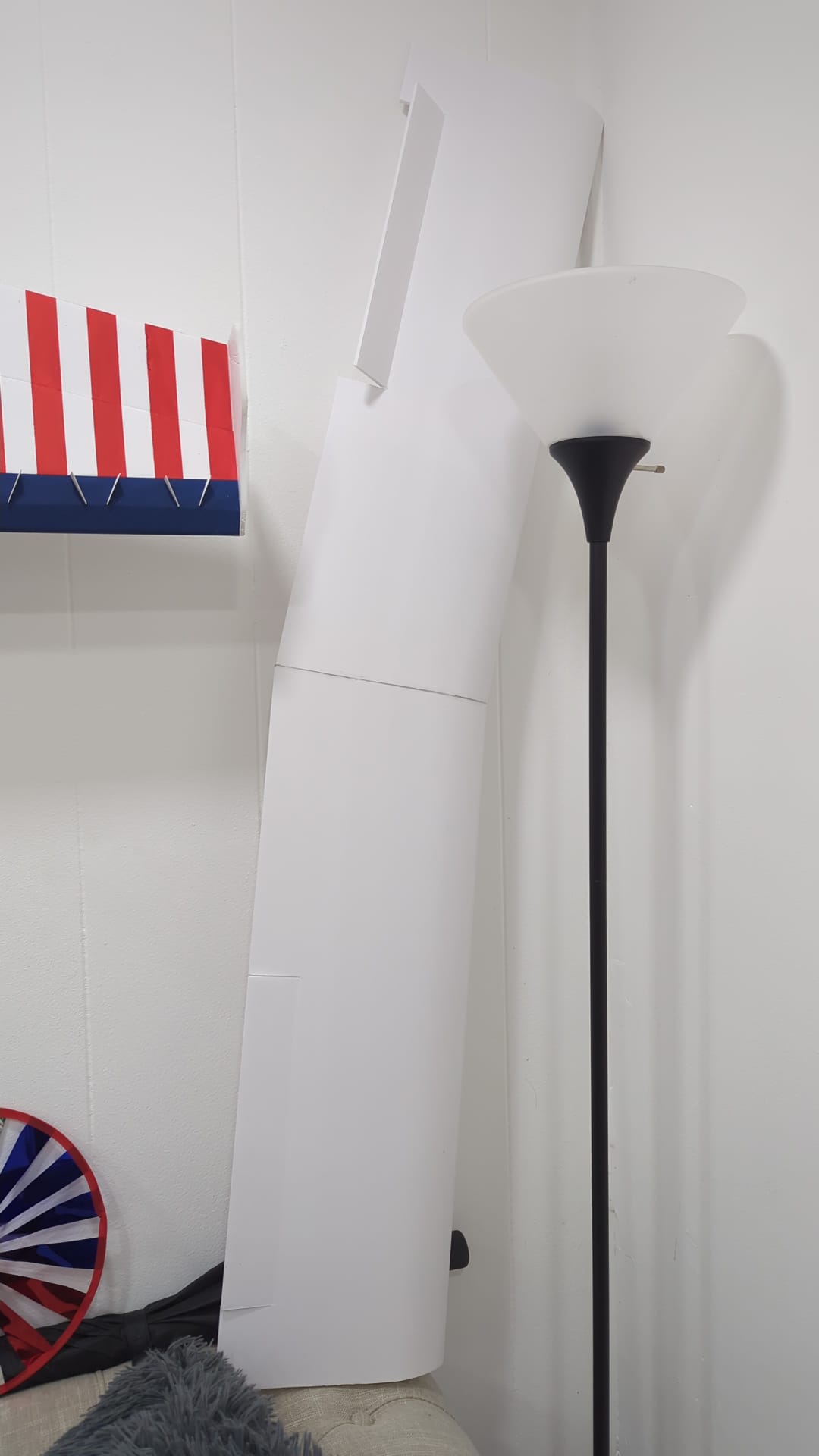

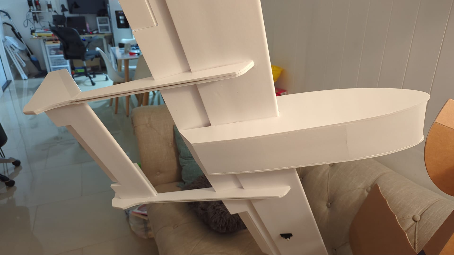

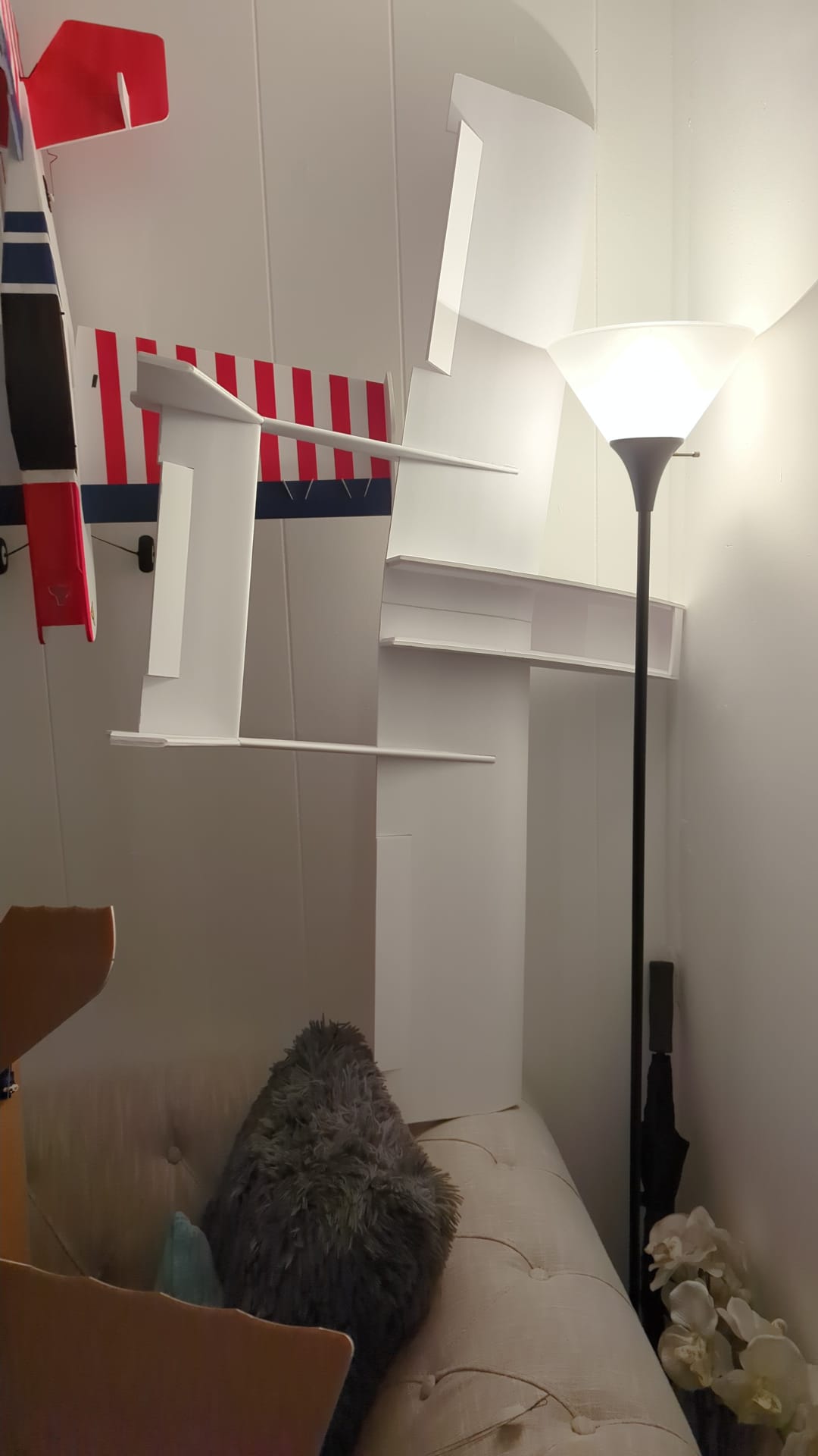

Pictures
cdfigueredo

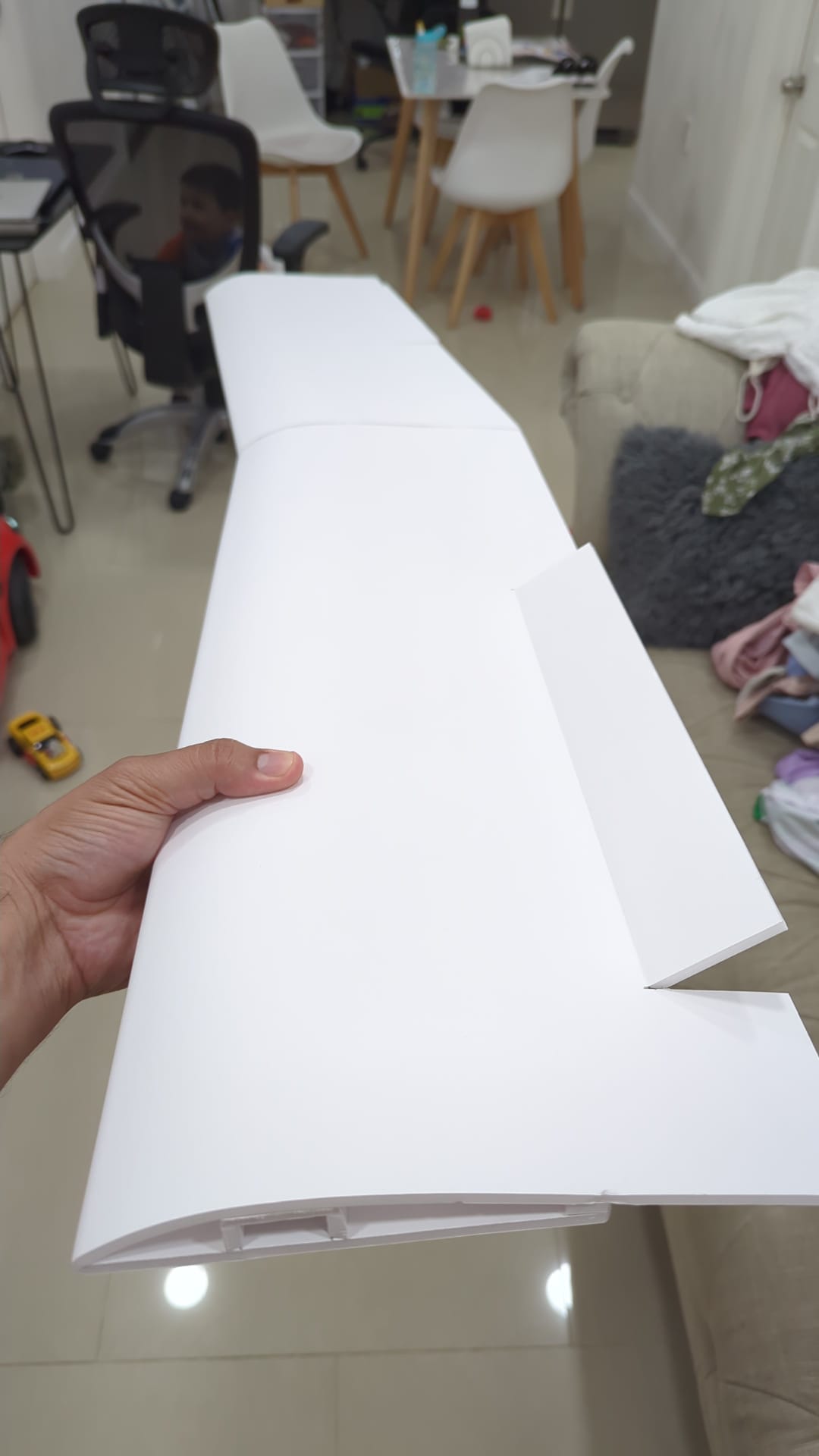

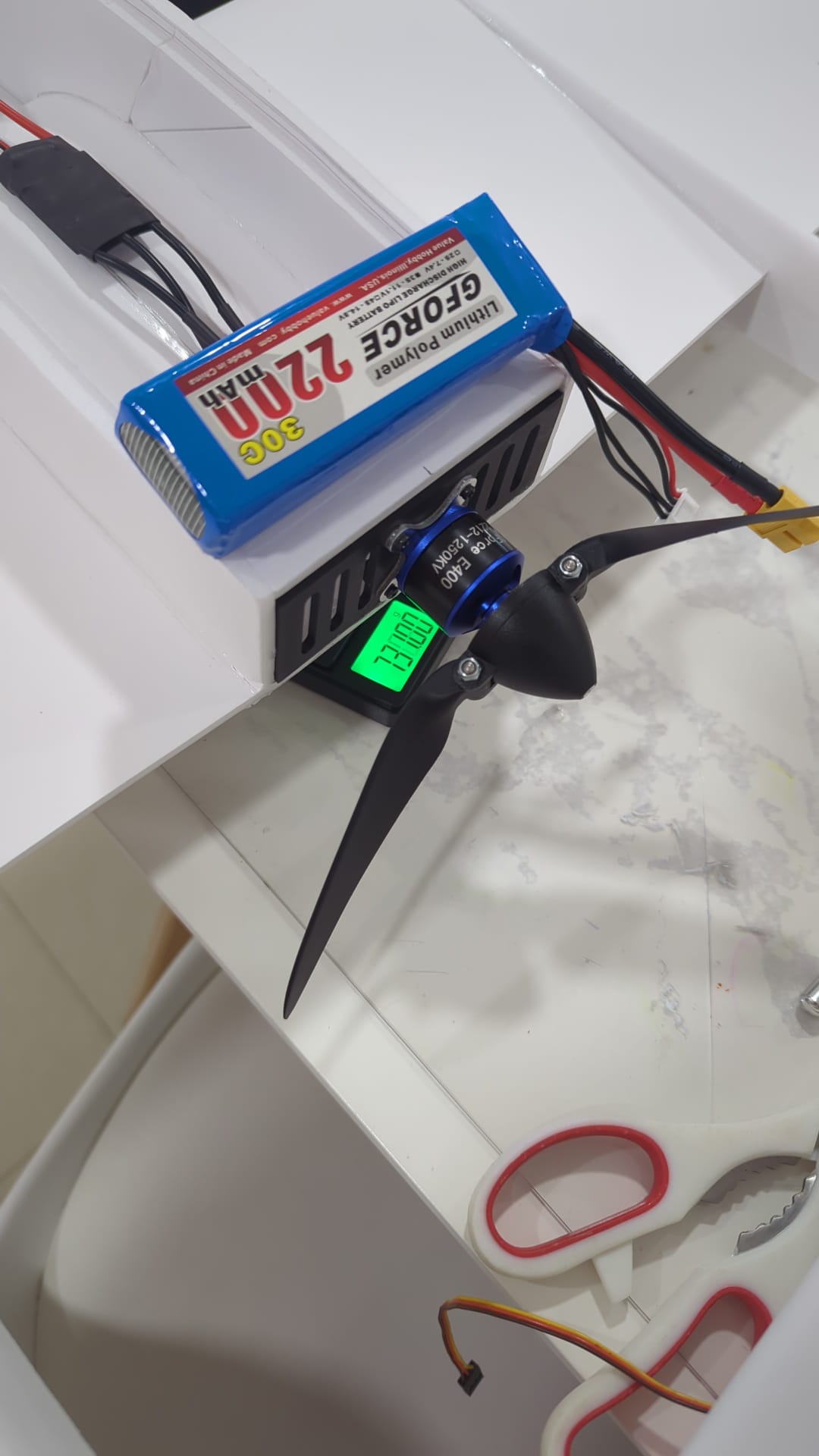

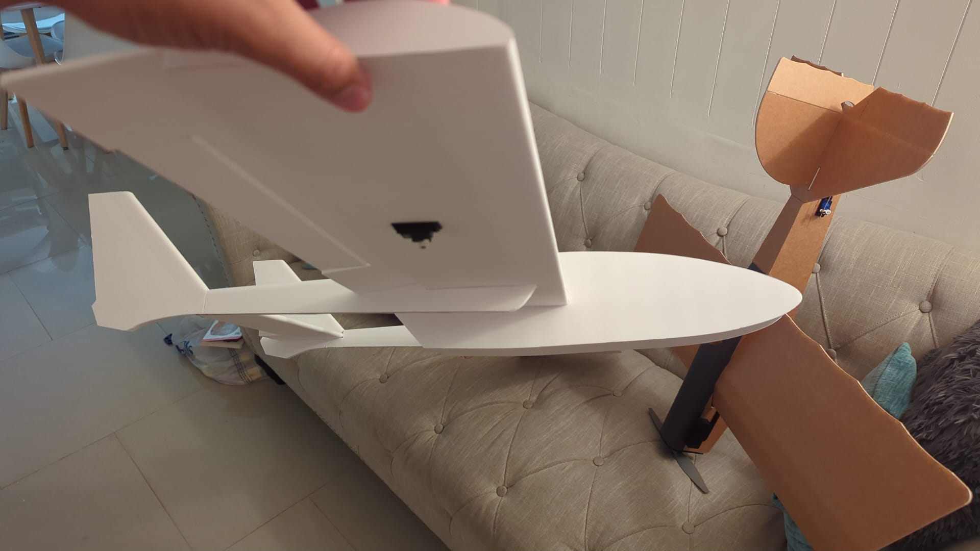

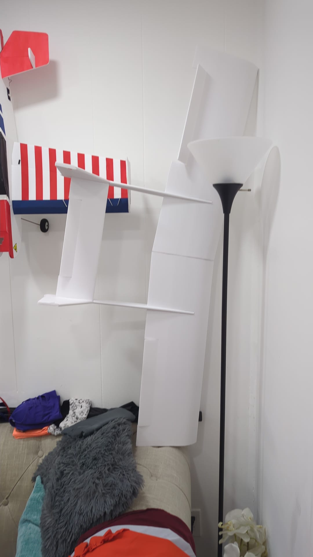

I used a few 3D-printed parts: a motor mount with ventilation slots, a NACA-style air intake for cooling, and a latch for the canopy. I also plan to add more printed parts to protect the belly of the plane during landings.
I want to do a few maiden flights first to see how the model performs in the air, and if all goes well, then I’ll install the FPV camera and video transmitter.
