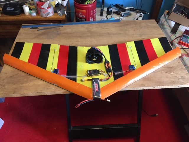

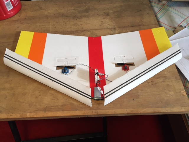

Yes, if you design one, a single plank will work. Suggest you get some experience with a FT model to get the feeling of a wing. One of the problems is if you go out to far, the beginner looses the shape(no fuse) and before they know it, it spirals down.
They are also fast and can be used to be modified for speed runs.
I
These are designed with no rudder and even work with an EZ Pack 2 and handle gusts very well. That's increases the flight time for the EDF having a 3S 1300 battery to over 10 min.

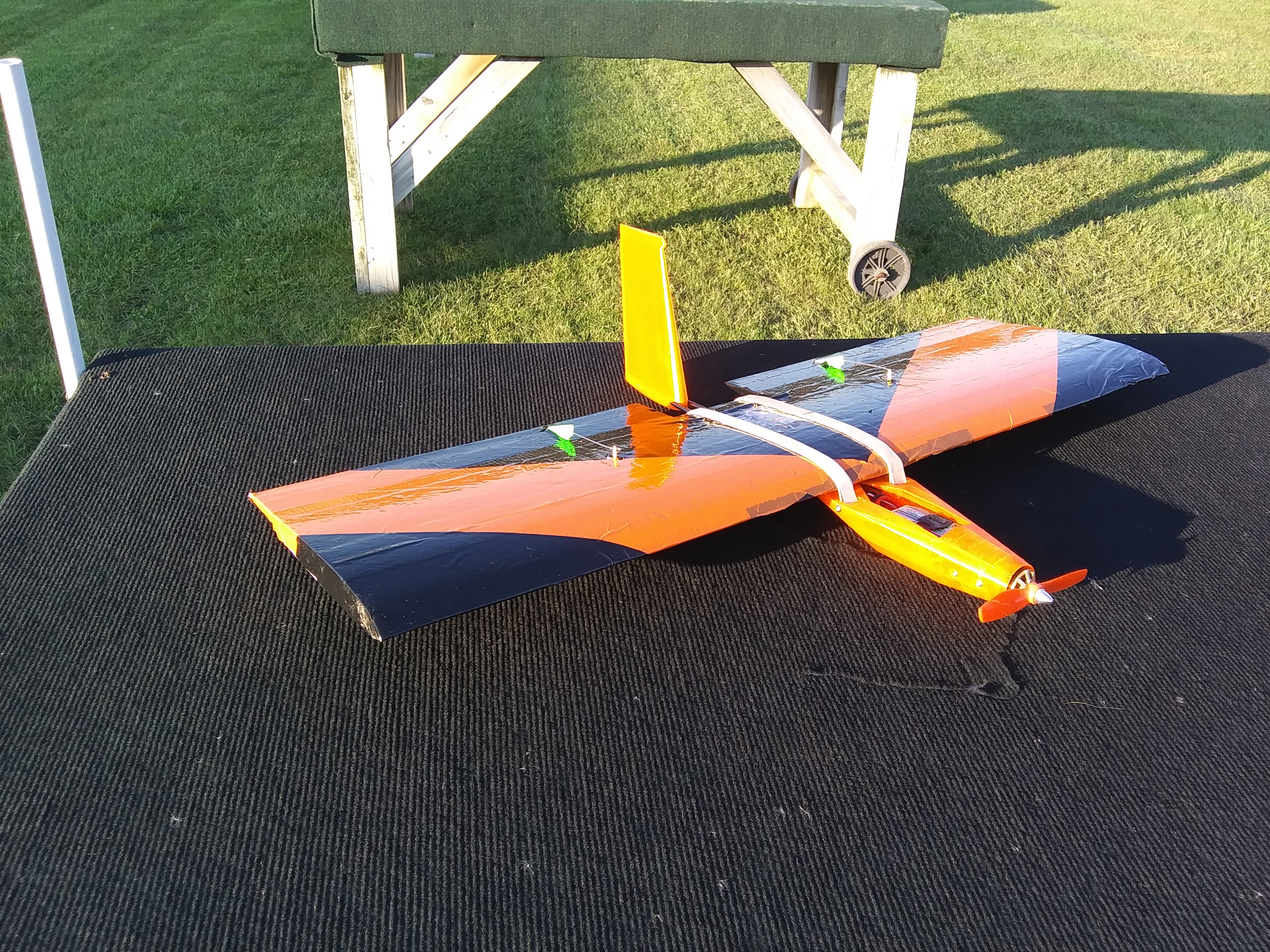

A "plank" is generally a flying wing with very limited or no wing sweep. It is called a "plank" because the wing is a long rectangular shape like a plank. Plank in this context has nothing to do with the airfoil but instead the airplane layout. Just like any plane you could build it with a bad airfoil or build it with a good airfoil. Some planks have vertical stabilizers and some don't, but a plank can't have a tail with an elevator as it is a flying wing.
This is very different from a flat plate plane like a FT-Nutball or flying stop sign for example. It is also not a V shaped flying wing like the FT-Arrow.
Here is an example a "plank":
