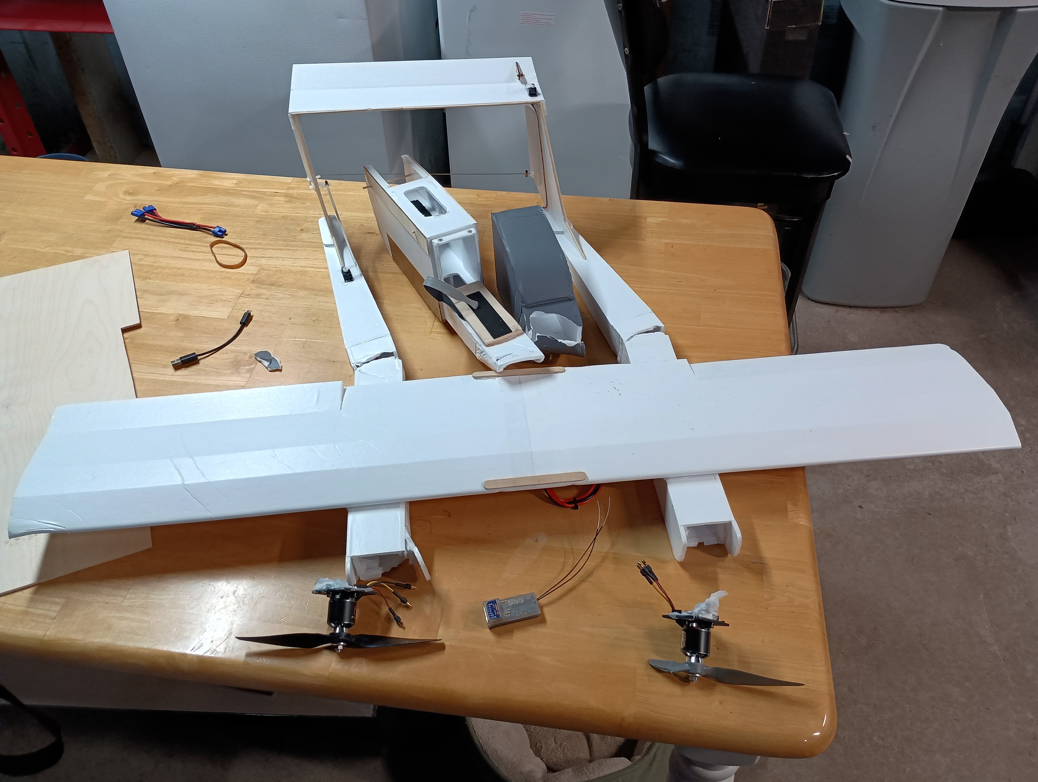

Forgot to reverse the ailerons in the Lemon after I made some mods to the wing and reversed the direction on the TX, IMG_20250330_075256327_HDR.jpg
There endeth the lesson. Luckily all hardware and battery were fine. It flew so well on 4s that I will build another.

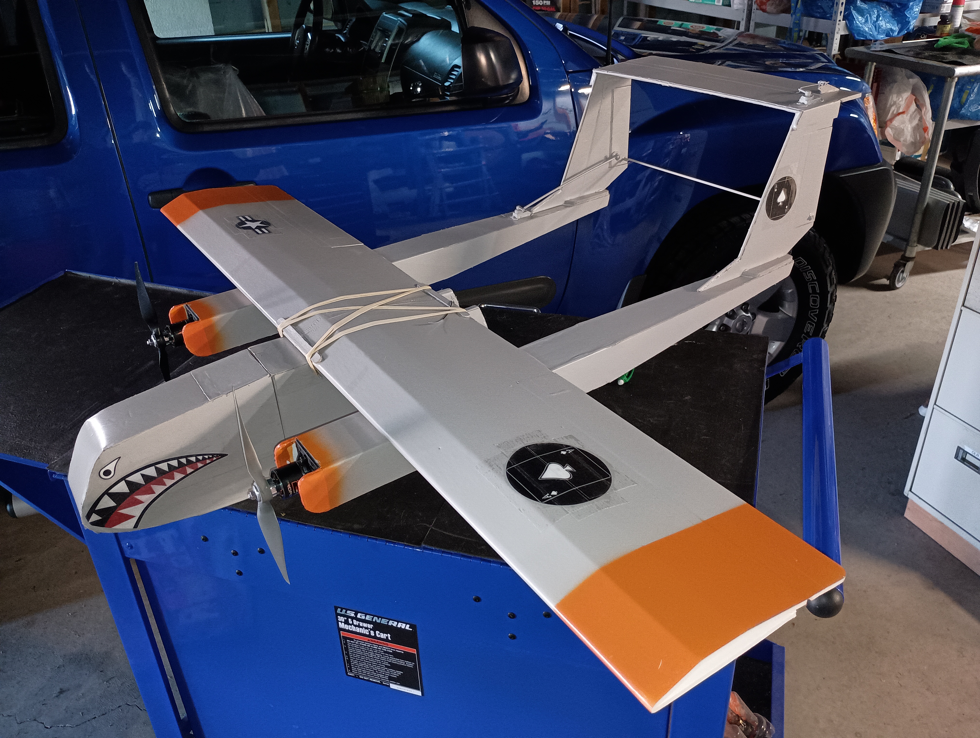

Bronco #2. Triple checked my gyro directions and did the maiden today in light gusts and it flew well.
