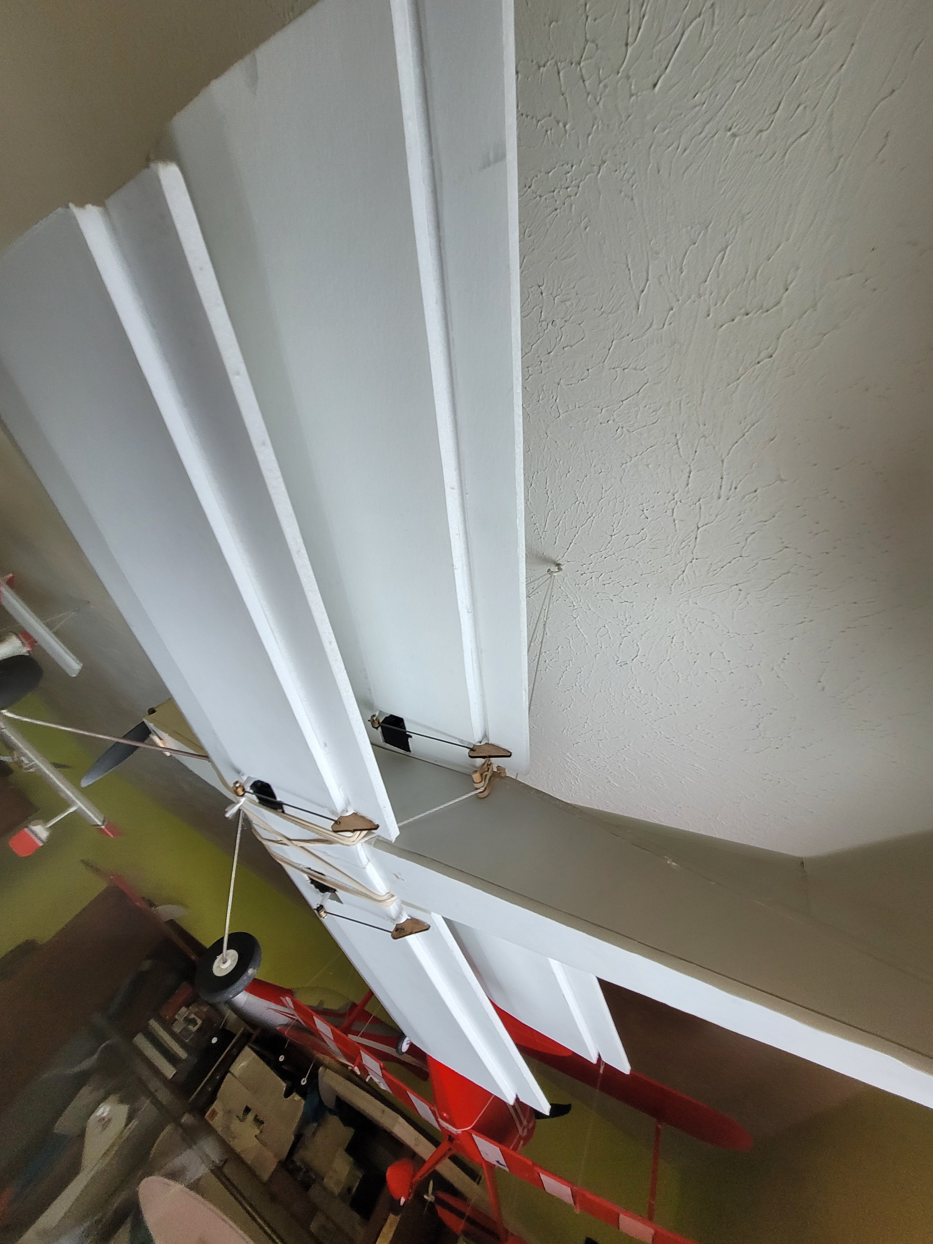

I have always found it difficult to cut a nice bevel edge when making hinges. This Idea works well for me. Hold the Knife at an angle while cutting. Give it a try.

It creates a double bevel. Nice!

Simply drawing a line (1) foam thickness from the edge to follow is a huge help for me, and if you cut *just* through the paper on said line (with a straightedge) before doing the final bevel, your blade can follow this cut from underneath while it rides on the outer edge of the opposite side and they come out machine-perfect without any special cutters or jigs. Unless you sneeze.
