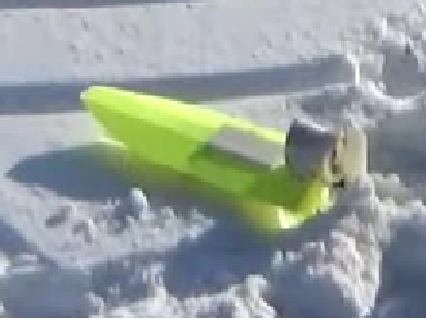

Here's a 3d printed EDF "swamp boat" that loves snow.

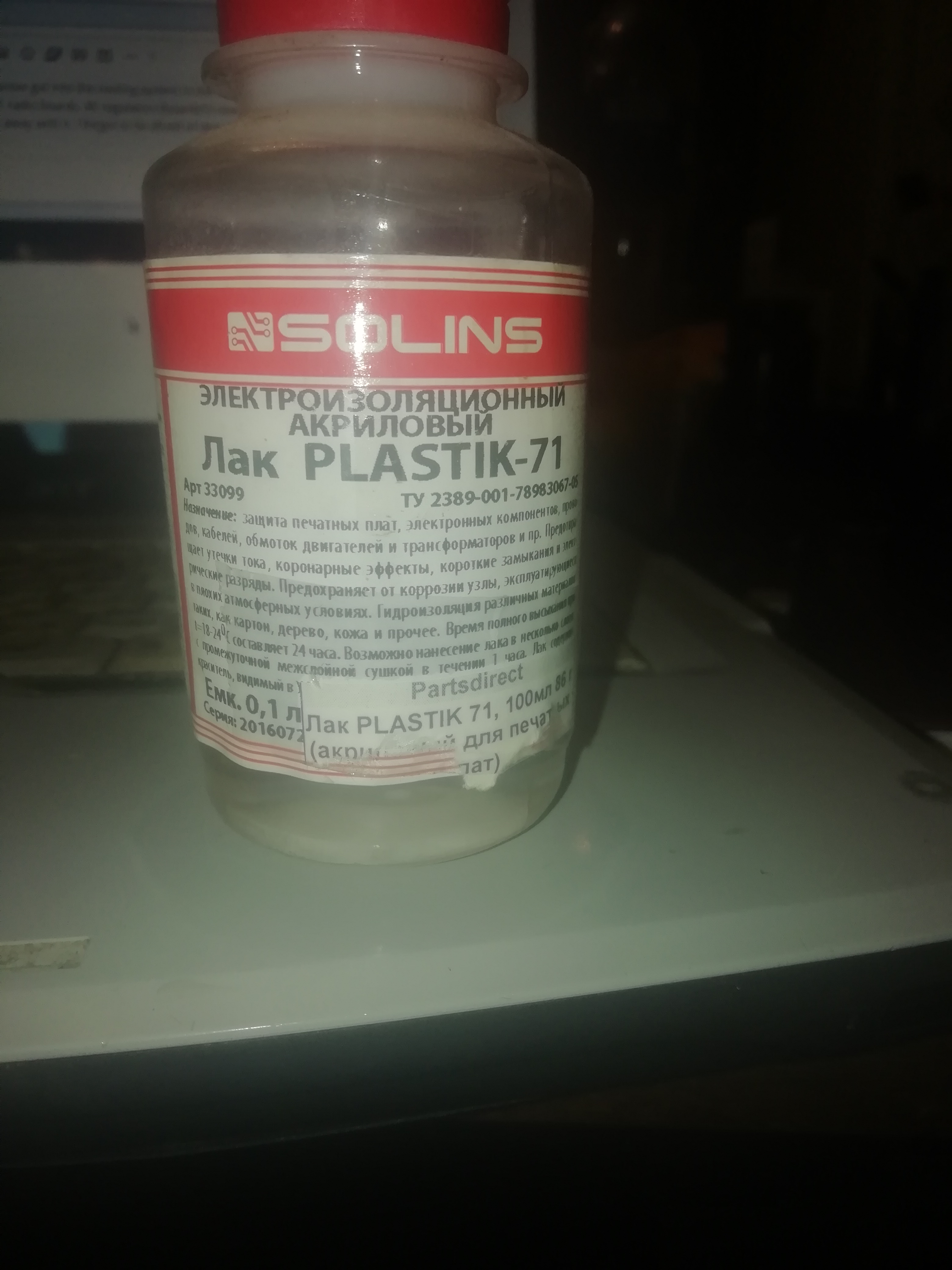

Personally, 2 voltage regulators burned out in winter - snow got into the cooling system in the fuselage, and the mosfets burned out from liquid ingress. I didn't like it, so I bought a polish for Plastik 71 radio boards. All regulators (boards!!!) new. and I dip the motor windings in varnish and dry them 2-3 times. I have a lot of models who get away with it. I forgot to be afraid of dew, snow and water.The varnish is cheap.
Coatings on heatsinks is generally bad juju if they get hot to the touch but water in electronics is probably worse
