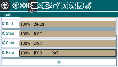

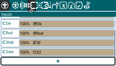

Create a NEW input on the inputs tab. Just click that + at the bottom of your inputs:

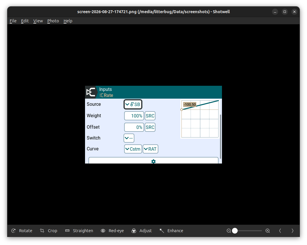

Choose the switch you want to control your rates in the source field

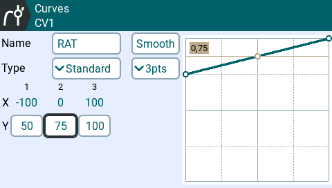

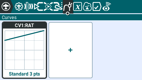

Create a Cstm curve. The standard values are CV1to CV32-ish.
If you long press the curve name field (now showing RAT) it will take you to the curve screen
Name the curve what you want. (you only have 3 characters) (I have a RATty Rate curve)
Change the type to 3pts for a 3 position switch, then edit the Y positions for the values you want for the 3 positions
I chose 50/75/100 in this example

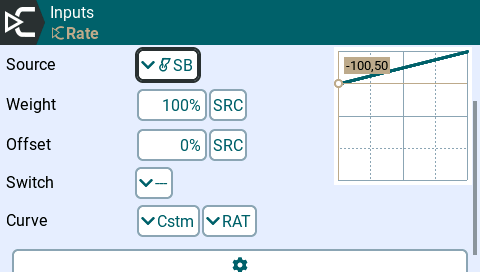

Return (RTN button) back to your inputs screen and select the input you want to add rates to
Here's my new input on the inputs tab

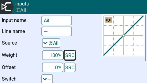

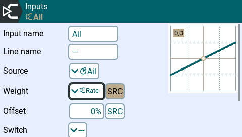

Let's add this to the Aileron input!
Click on the [SRC] button next to the Weight field
Then scroll through the inputs list till you find the one you created.

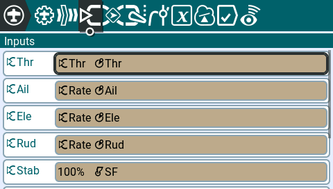

Add it to whatever other inputs you want multiple rates on and test it out!

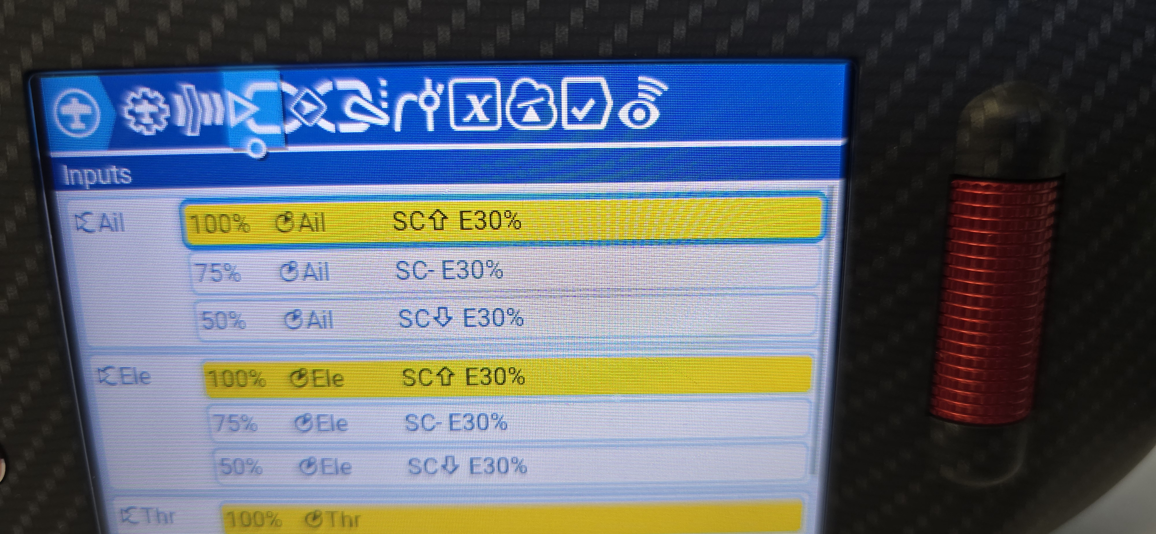

Notice, now when you look at the inputs, you can easily tell which ones you have your rate switch assigned to them

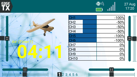

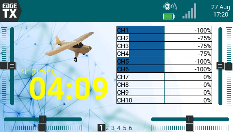

Here I show my outputs with the sticks in the corner for my 3 rate switch positions:
Want to modify your rate positions, just edit the curve on the Model's curves tab

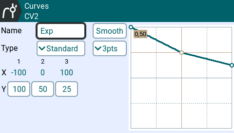

Details of setting up Expo using a curve are almost identical to the way it is set up for rates. The only real difference is field on your inputs is different.

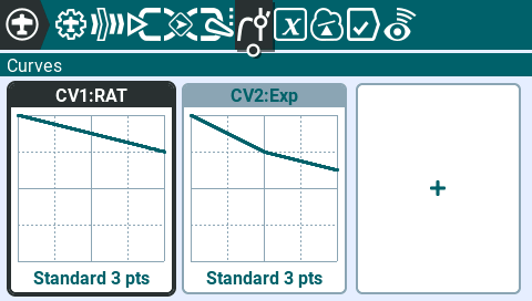

Step 1: Set up an Expo Curve in the Curves tab for the model. Example is for a 3 position switch.
If you want to go back and modify your curves, just go to the curves tab and select the one you want to adjust.

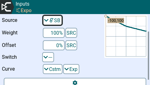

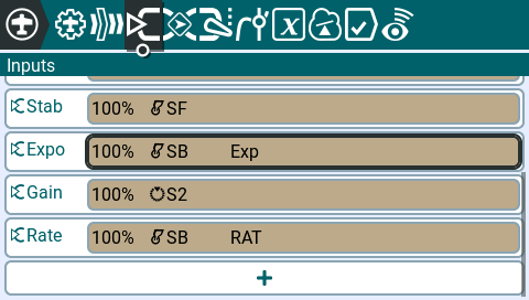

Now create a new input called Expo using the + at the bottom of the inputs.
In this example I am using the same switch [SB] for both rates and expo.
You can use different switches or even a knob to adjust the expo.

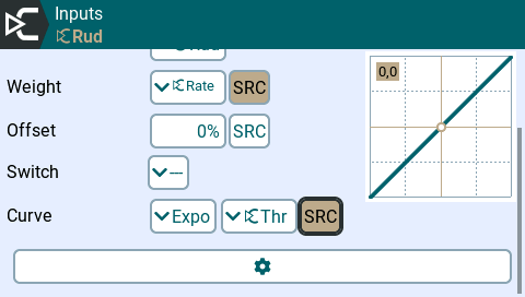

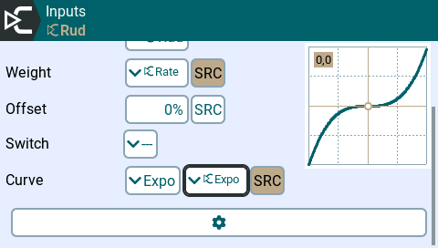

Set the curve to [Cstm] and select the [Exp] cruve you created in the first step.

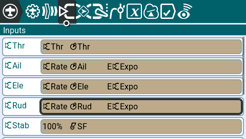

Now set up expo on the Inputs you want to have expo (Ail, Ele, Rud, etc.)
Go down to the Curve line on the input, select Custom, then click source till it shows an input field
Now select the input you created for Expo from the dropdown list.
Now the inputs will show which are set up for rates and expo
You can see in this example rates and expo are controlled by the same switch
