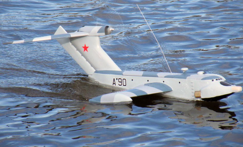

I saw the microwave airplane video and felt that the plane was perhaps flying in ground effect.
Ground effect is a strange phenomena that increases lift and reduces drag when a plane with very wide wings(large chord length) is flown very low( less than chord length altitude). Such vehicles have been attempted by Russians and they named them ekranoplans.
I thought if a crazy heavy plane with wide and short wings and low power could be attempted. Although I would like to warn of a different CG placement as a plane that flies well in free flight experiences a pitching down motion when brought in ground effect. so the plane should be slightly tail heavy.
