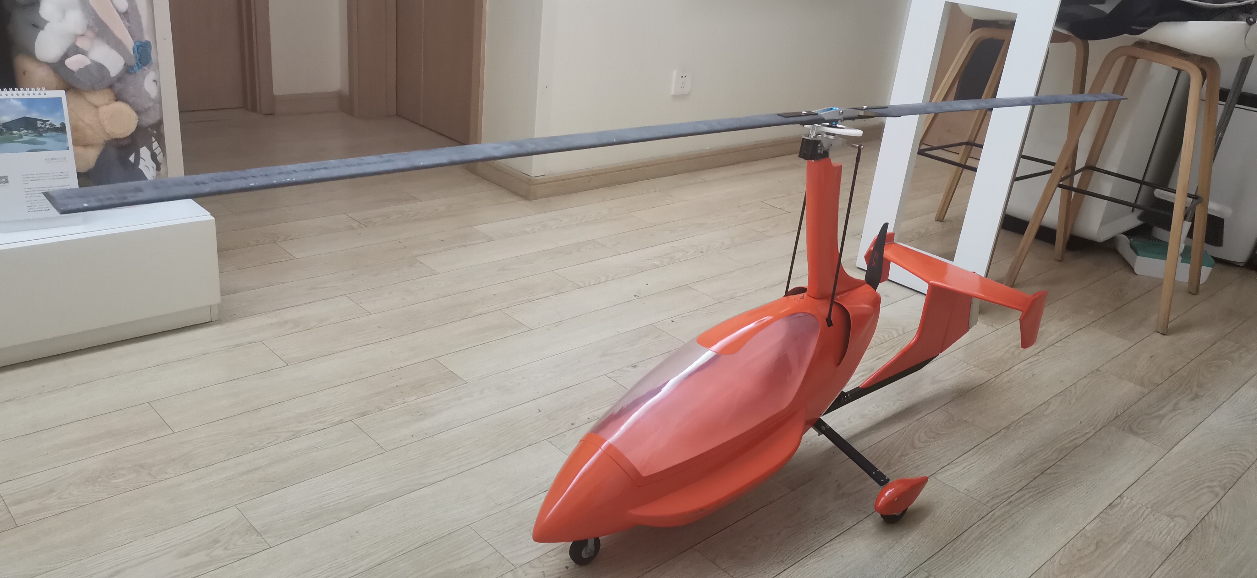

This video is the first test flight of ELA10.

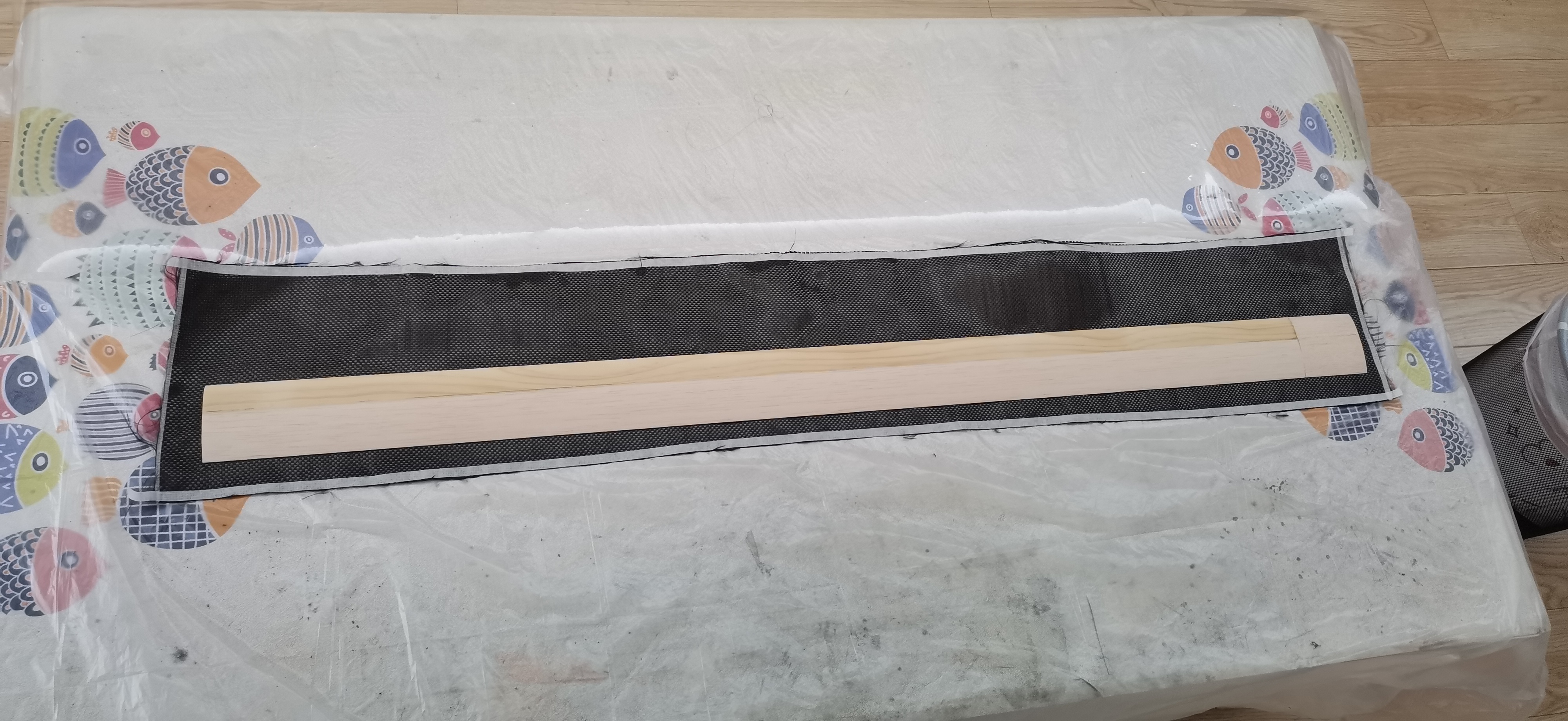

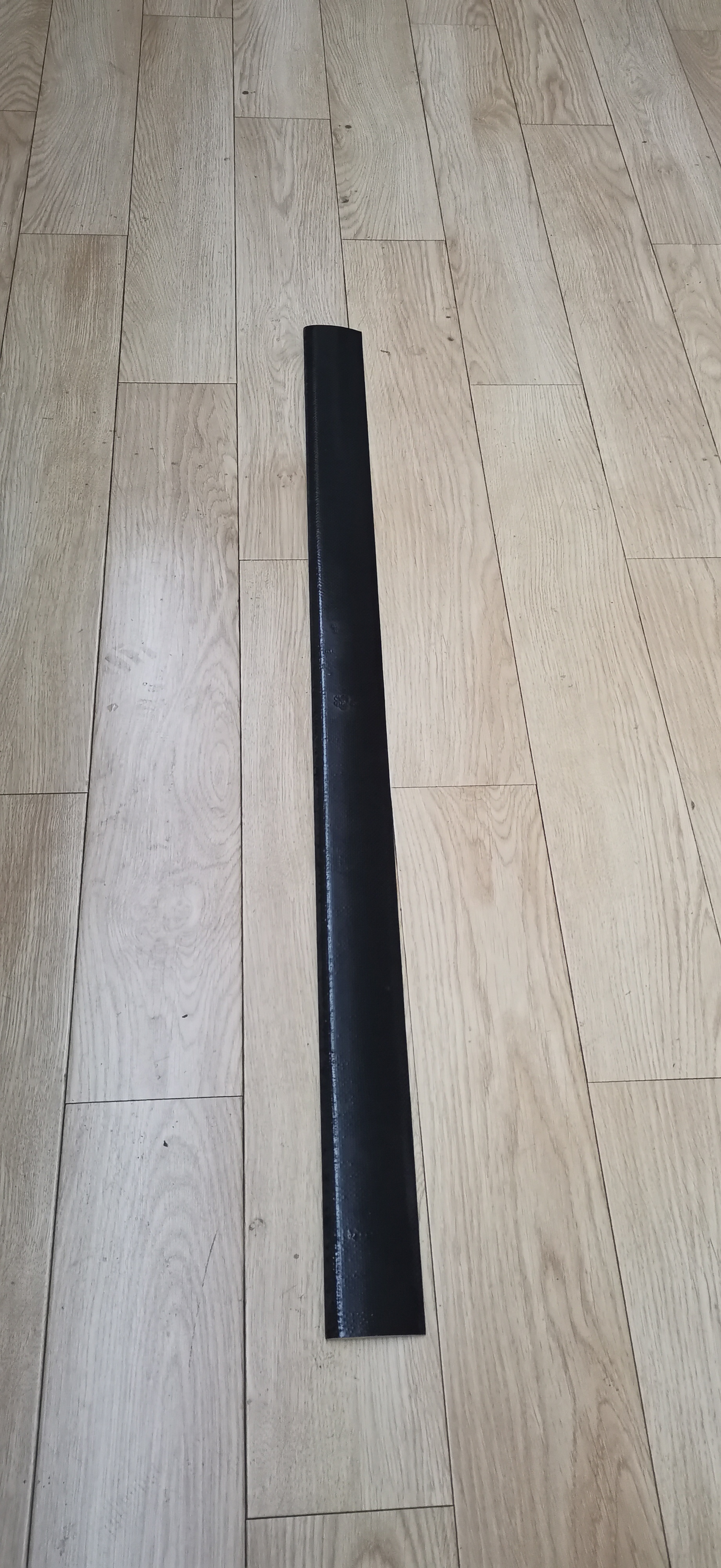

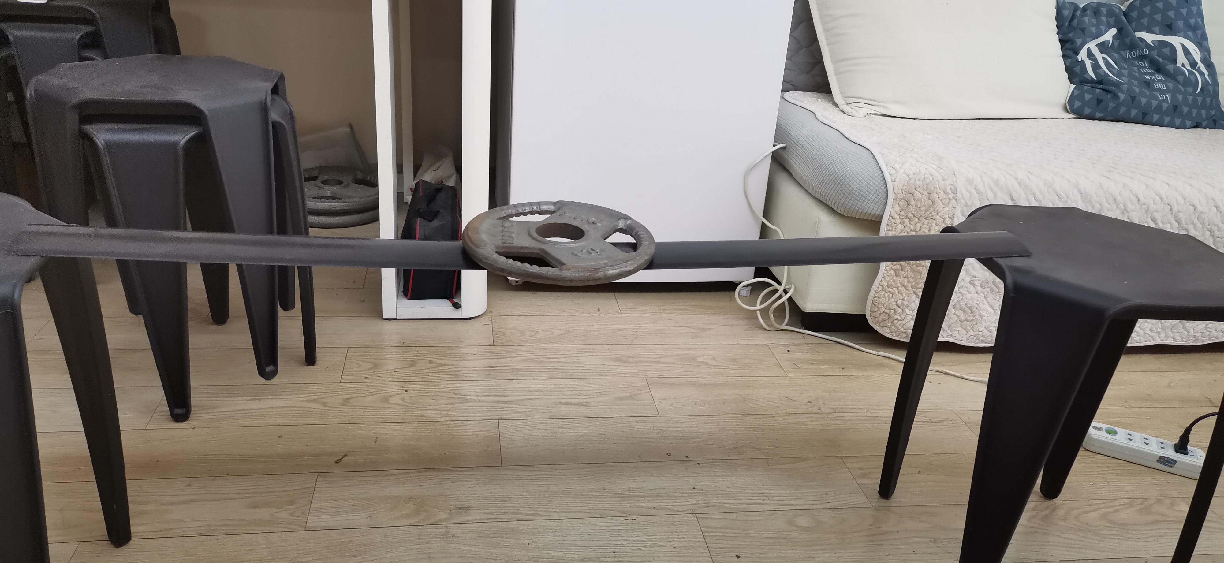

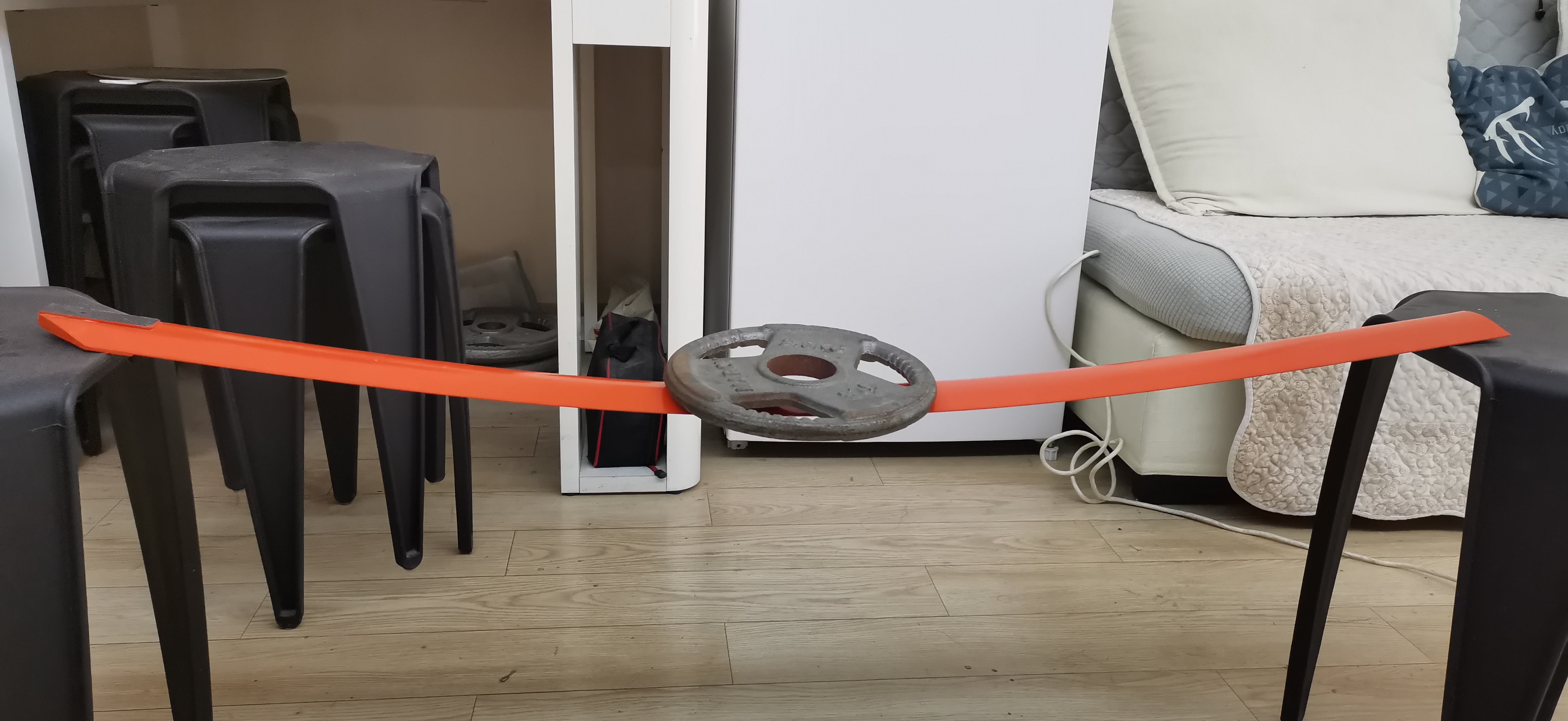

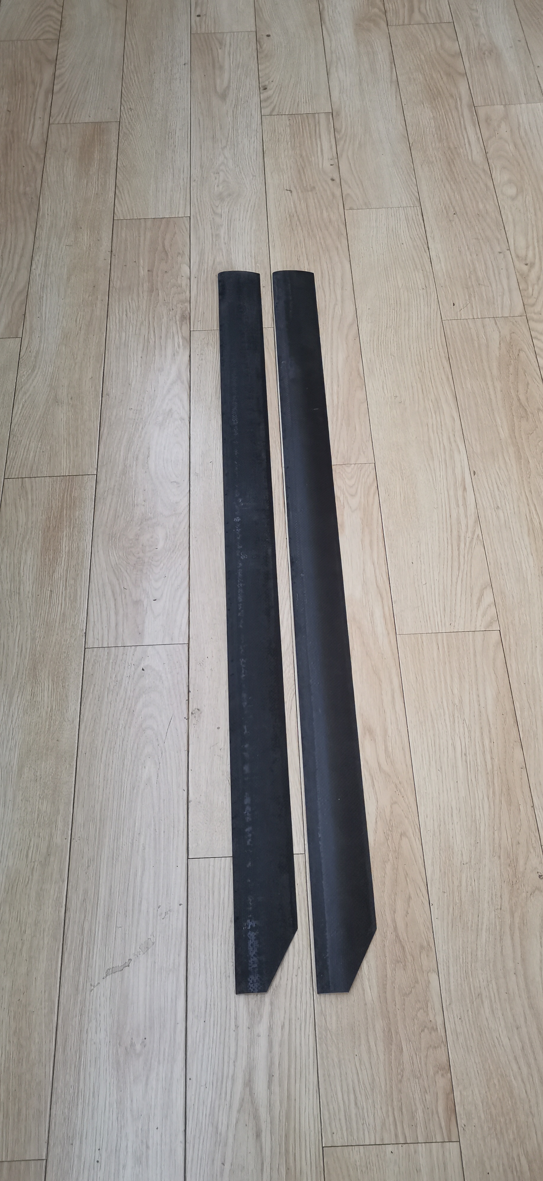

Insufficient blade strength.The bending of the blade when increasing thrust or pulling causes a decrease in lift.So made a new carbon fiber blade.
I hope these blades will perform better on the next flight.
