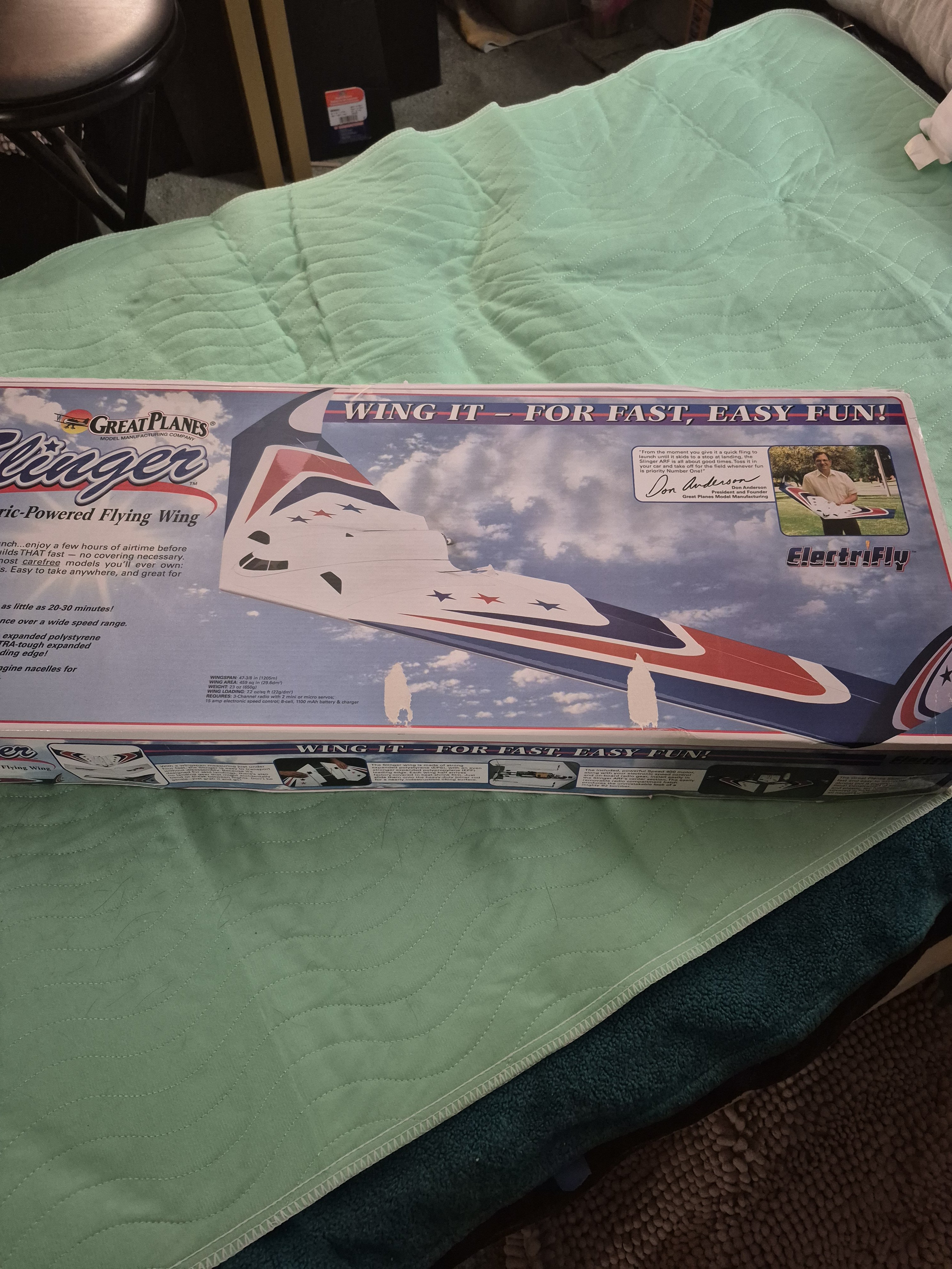

I want to add a tailboom and horizontal stabilizer and rudder to my stinger flying wing and use it as a glider no motor. Has anyone done this? The wing span is 4 feet and I was going to put a tailboom of about 2 feet behind. One question i have is: Do I need to raise the horizontal stab up or can it be at the same level as the wing? Hope you can help

Oops wrote stinger instead of slinger. I know it will fly without tail boom.but I want something different. Flying wings fly a little crazy to me on slope.

I see no reason it couldn't be done. You'll need to re-adjust CG, of course. Be sure the (twin) booms have clearance for the elevon movement and prop clearance in case you want to use the motor later. (Ignore for single boom.) I personally would want the h-stab a bit above centerline.
If you go single boom, you might be able to install the tail using the motor mount.
