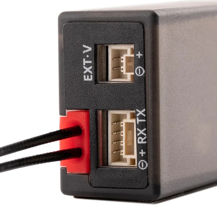

Do you have a picture of the ER6 itself?
If it is this version, you should use the serial port on the end of the RX, not the PWM pins.

It won't let me get into the "Serial" screen to turn on SBUS without changing pins 2 and 3 in the "Connections" screen to "serial." I went ahead and did all that and now, using the serial port, the Aura board is happily chatting with my ER6. Thanks for pointing that out to me.
I had seen the cable that came with the ER6 and saw that one end went in that serial port, but I thought the other end was supposed to go into the satellite port (oof) and it didn't fit. I finally figured out it goes to port B.
