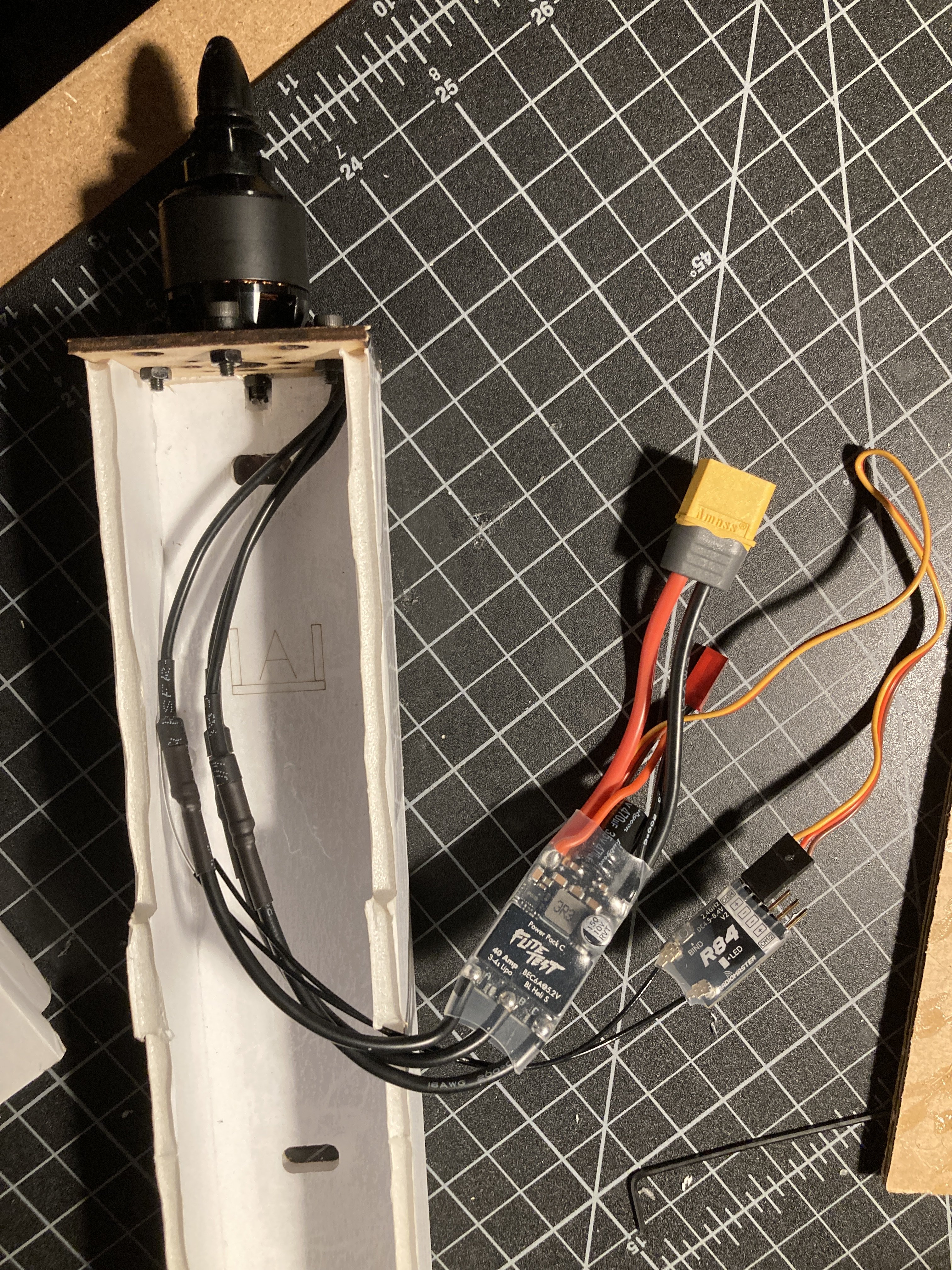

Strange... Do you have another esc to try? Can you post a pic of the receiver hook up?
No other ESC unfortunately, this is my first build.

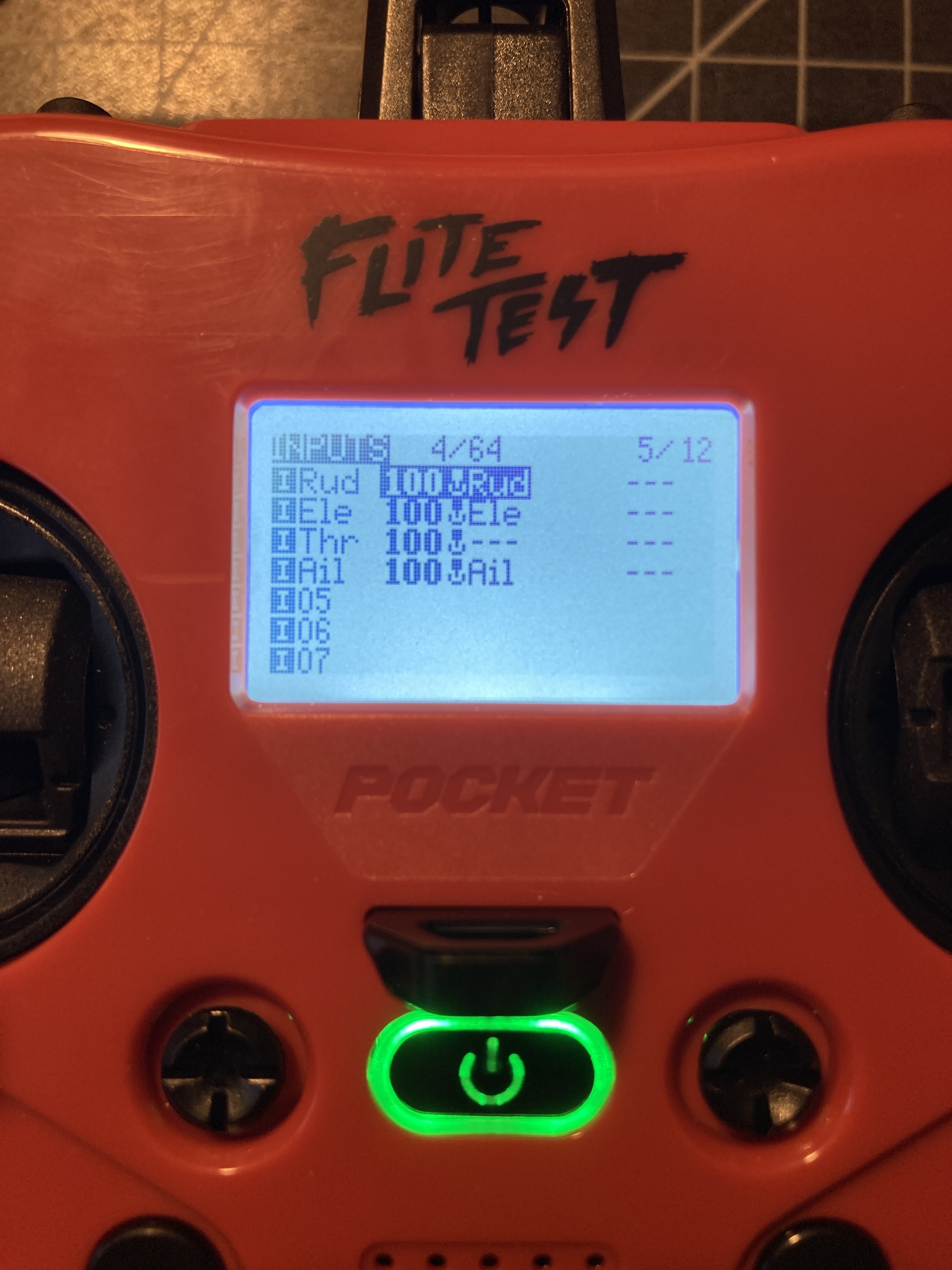

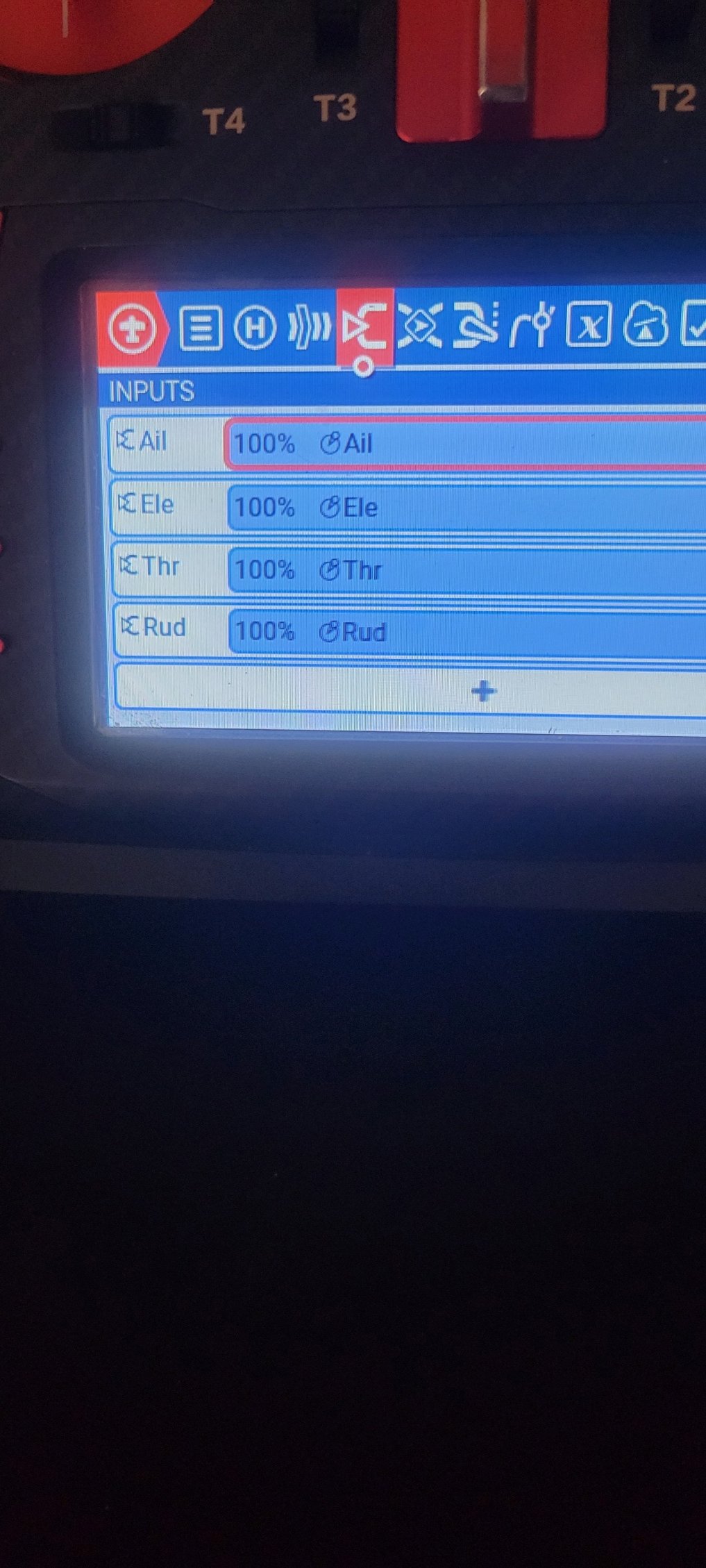

On the radio go to model inputs and take a picture of the screen so we can see what the mapping is.

Also, in your radio, go to the channel monitor screen. It will show you the value being output for each channel. Look at channel 3 and move your throttle up and down. You should see the output bar for channel 3 go from positive 100 to negative. If it doesn’t, then your may have set reduced rates on that channel.
Throttle goes from -100 to 100

See to the right of THR in your modle input, it does not say THR. Try changing the input
to say THR next to it to see if that works. Only thing i can think of. Not sure if that is it, but fingers crossed.
It didnt give me an option to pick THR, and after I disconnected the rudder servo to test the reciever, it wont give an option for RUD either.
