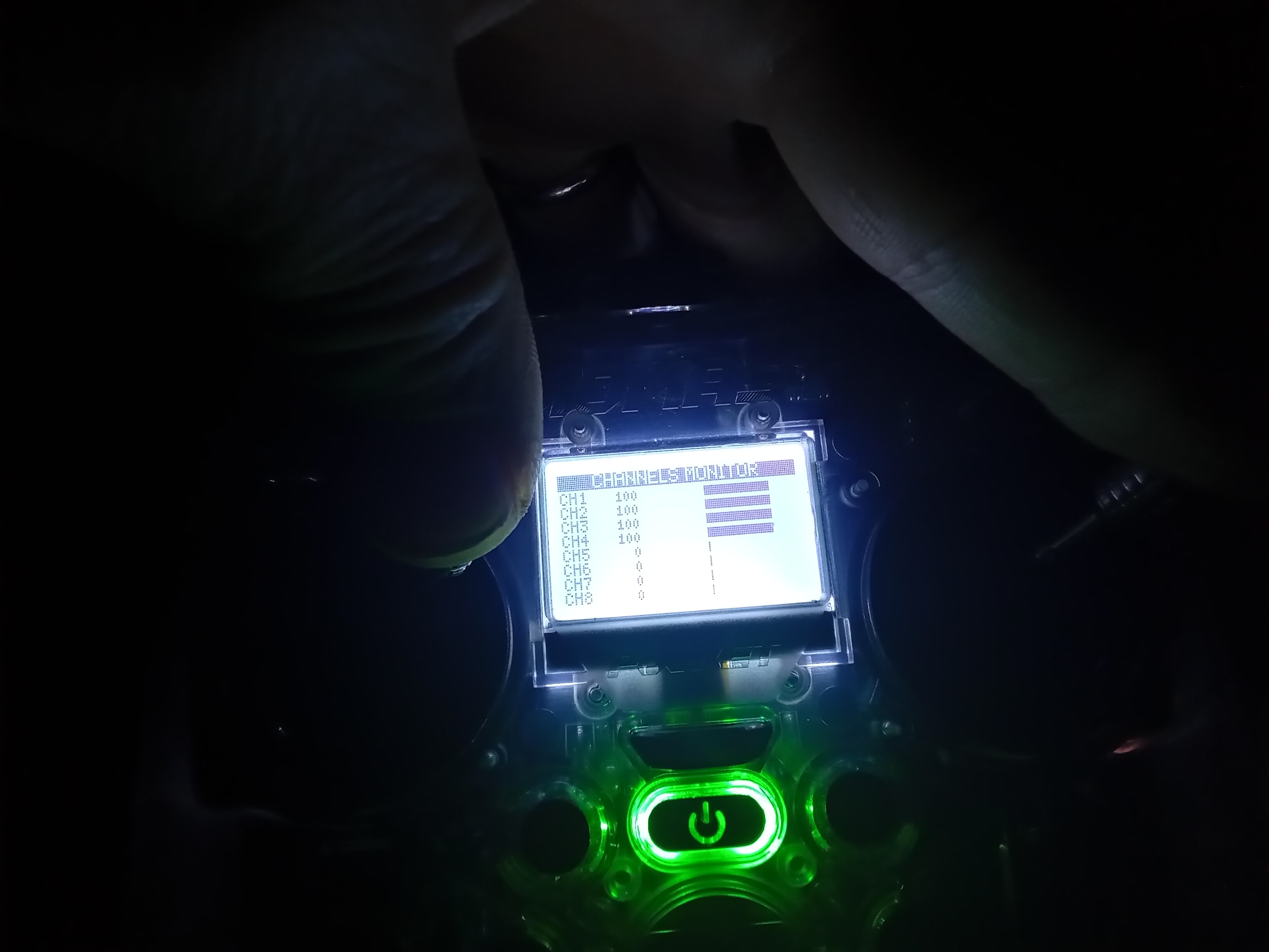

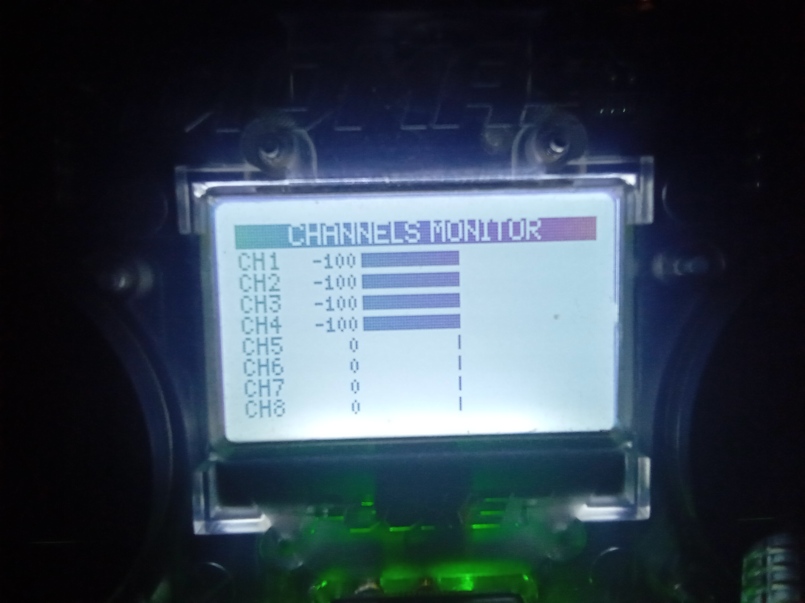

Earlier, he said that if he plugs a servo into port 3, that the throttle moves the servo back and forth as expected.
My suspicion is that something is preventing the stick from hitting +100, so the ESC isn’t going into calibration mode.
I had another thought on that. There could be end points set in your output that is causing it. Could you please take a video of your channel monitor screen, while moving your throttle all the way up and down? Both bars, the outputs and the mixers bars, should go all the way from -100 to +100.

On the main menu, in "Channels Monitor", the CH3 bar goes from -100 to +100.
In "model", under "Mixes", Throttle is CH3
