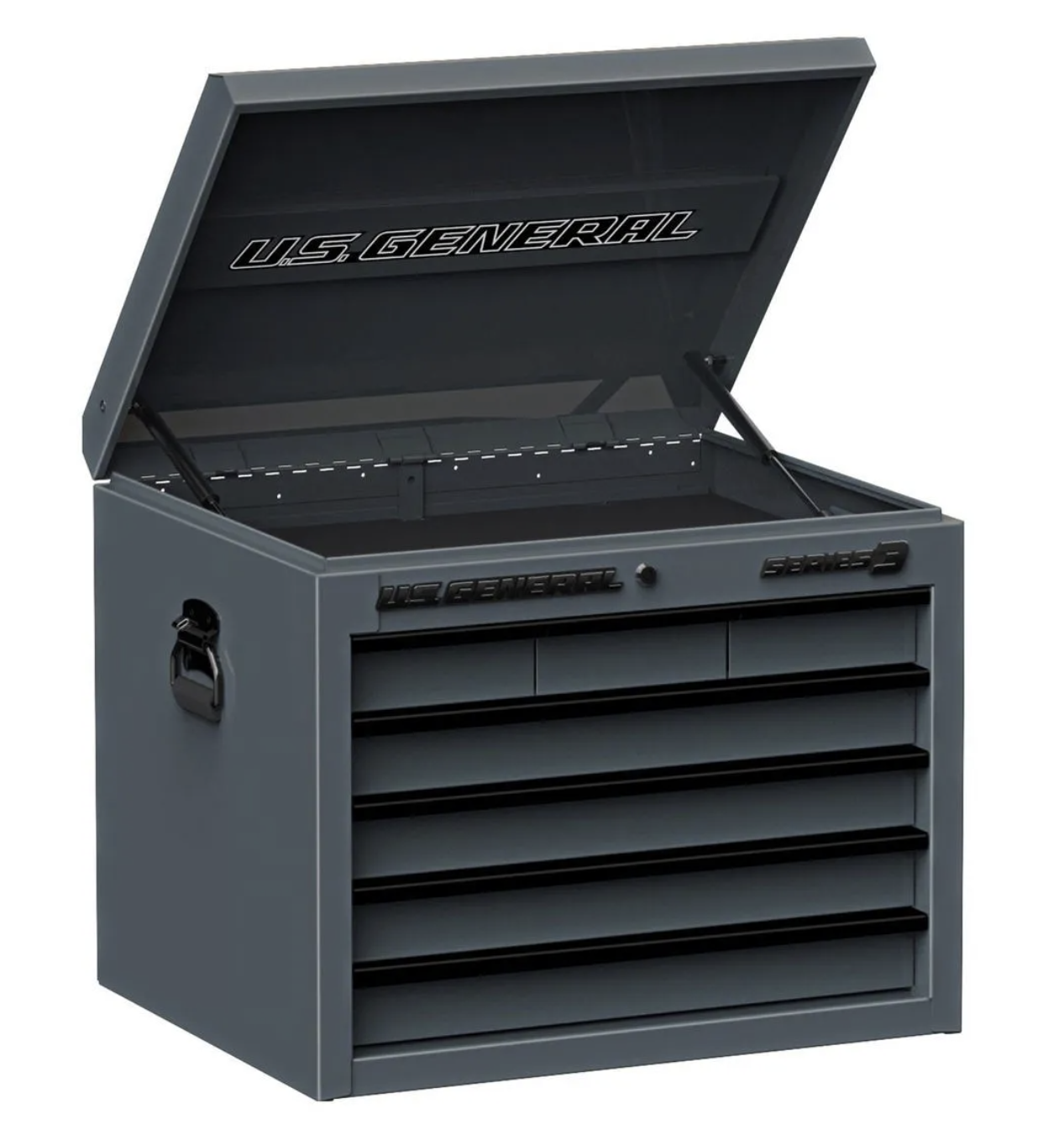

I've had one lipo fire, scary stuff! I've been toying with designing a storage/charging station which will be built around a tool chest topper from Harbor Freight: https://www.harborfreight.com/27-in-x-22-in-top-chest-series-3-slate-gray-70748.html
This is one of the only ones that I've found where all the drawers are deep enough to hold decent sized batteries. The top three smaller drawers will hold the smaller 1-3s lipos, and the drawers below will hold 3-6s packs. Somewhere on here I saw someone use small plastic bags filled with some sand as a built-in fire protection, so I'll be trying that out. With some 3D printed cable organizers and a power strip, the top will be perfect for several chargers. Lastly, a fire extinguisher mounted to the side incase things go south.

I don`t think I want my storage and charging in the same container, since most fires are from charging but that is just me.
The Hangar
Fly harder!
Fair enough, I think using a batsafe while charging or something similar would keep the charging batteries far enough removed for me.
