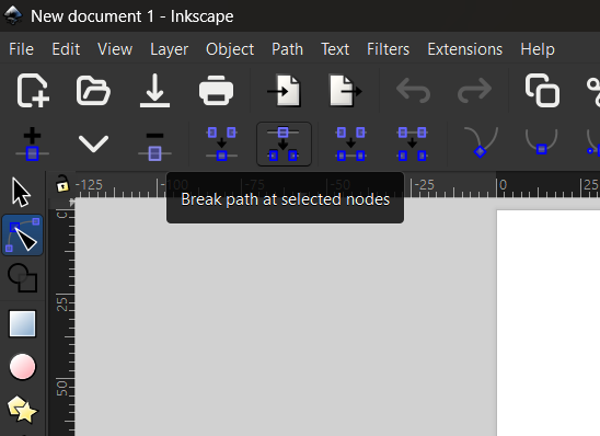

Node tool.
Select the node/s you want to break apart.
Select Break Path At Selected Nodes.
Then Click Path > Break Apart.
Then you can select all the nodes you want to move. You might be able to select/move as an object also.

THANK YOU! Now that Christmas is in the past, I was able to add 12mm to the sides of the core pieces. Getting the "Snap" to function was interesting but I figured it out. I exported the individual pieces as PDF files and Printed them as a poster. Tape together and now ready to rebuild a "new" Explorer. I had already removed all the salvageable pieces from my old Explorer,so I am ready to start a new cycle.
PS. I found out from experiment and YouTube that if you change the measurement to "mm" and type say "+12" at the end of the coordinate fields, everything shifts by that amount. Makes it easy to move the pieces the exact distance you need.
