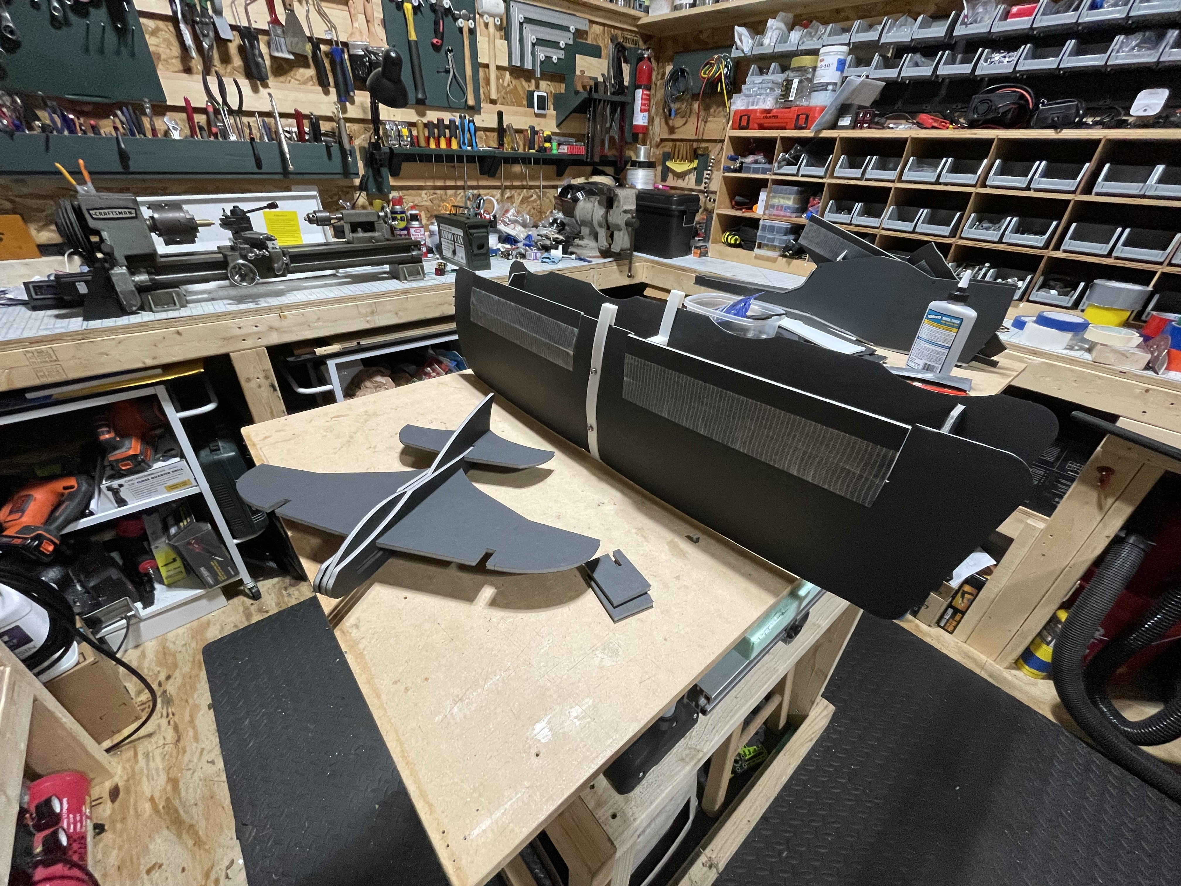

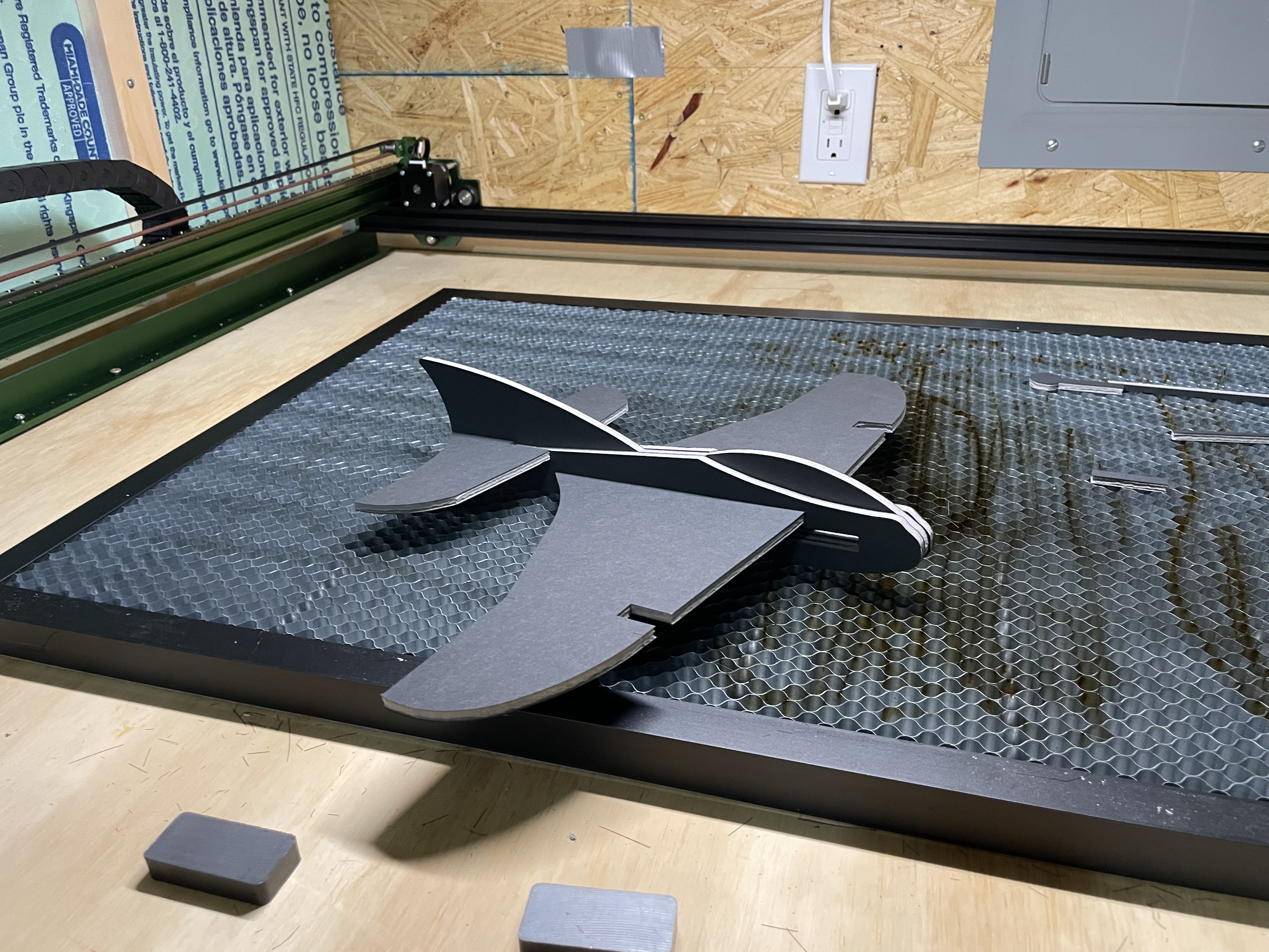

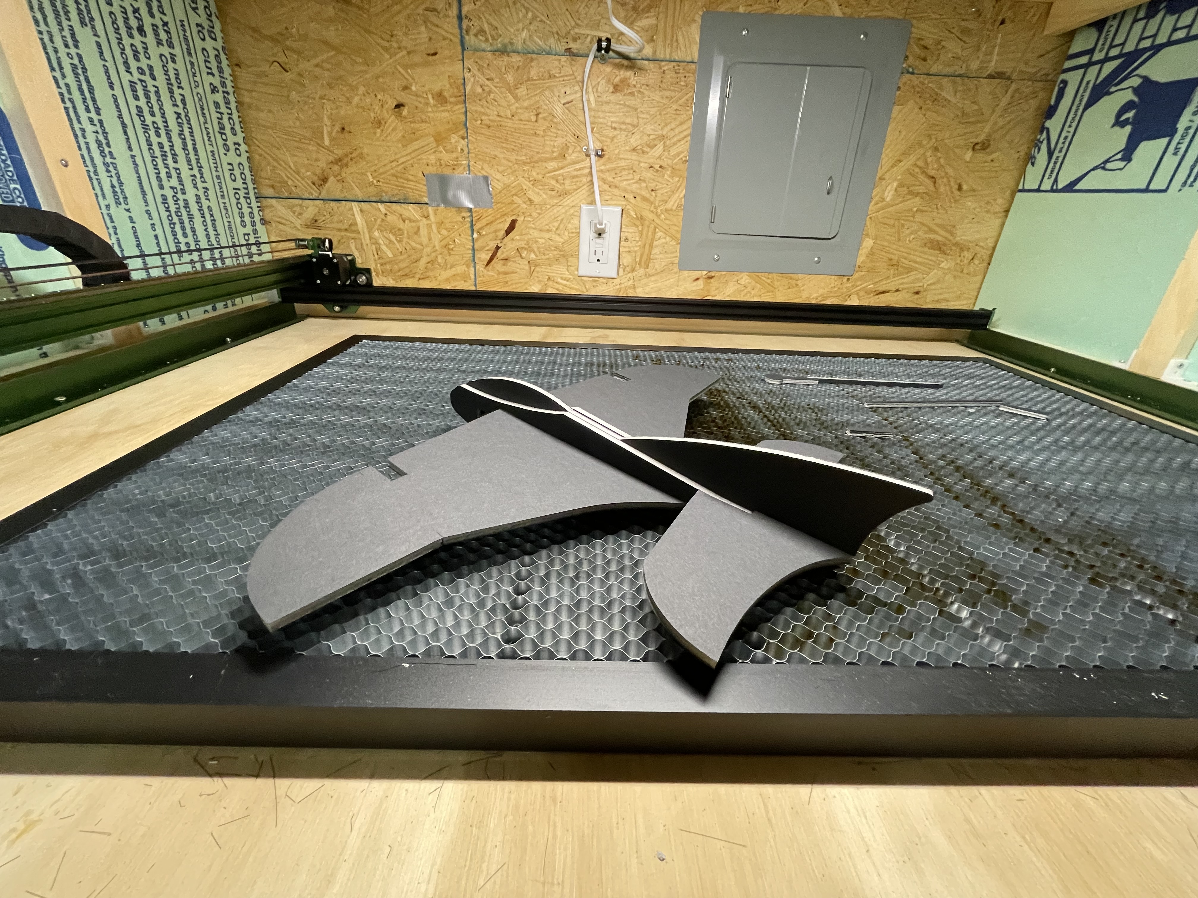

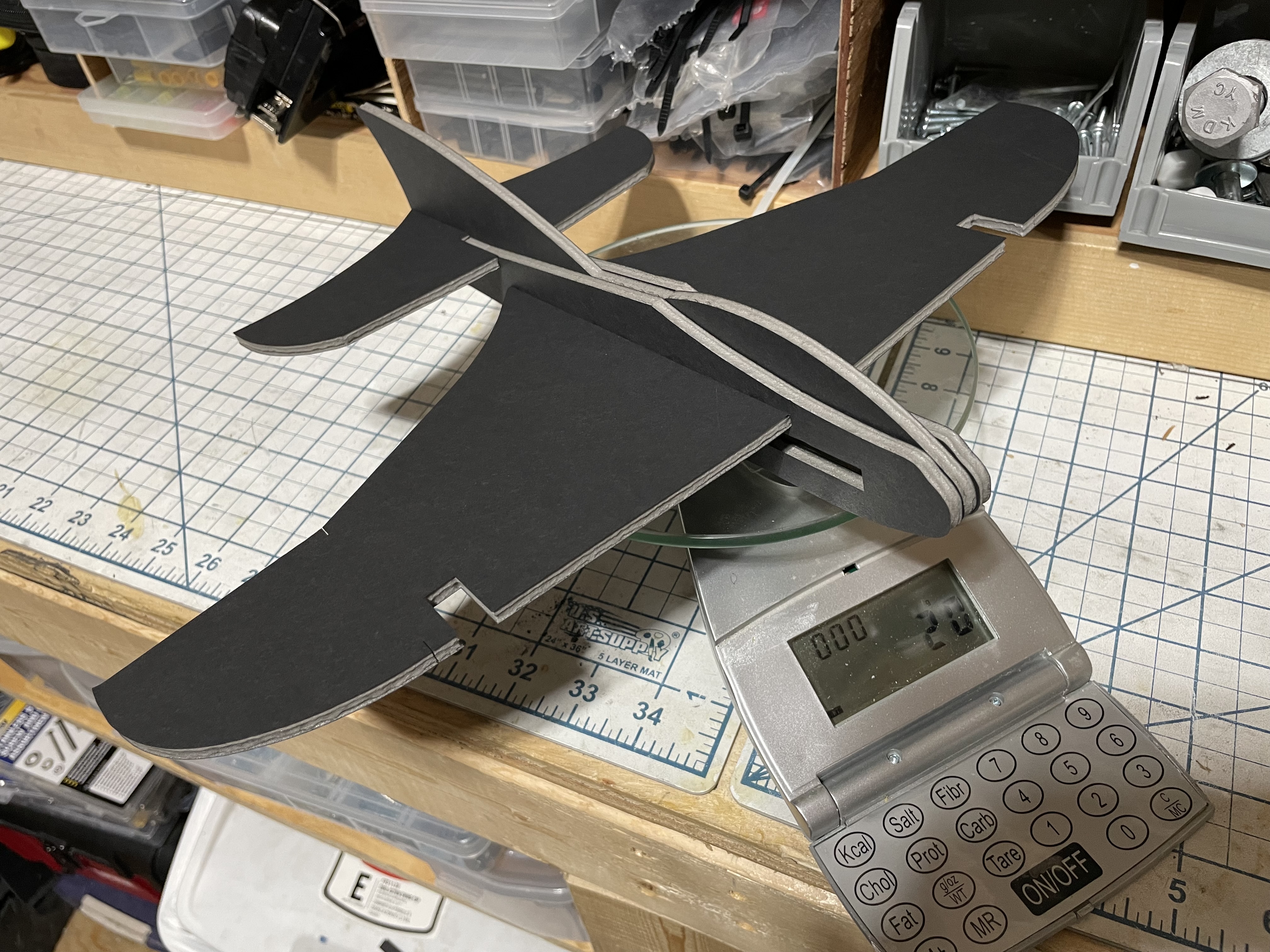

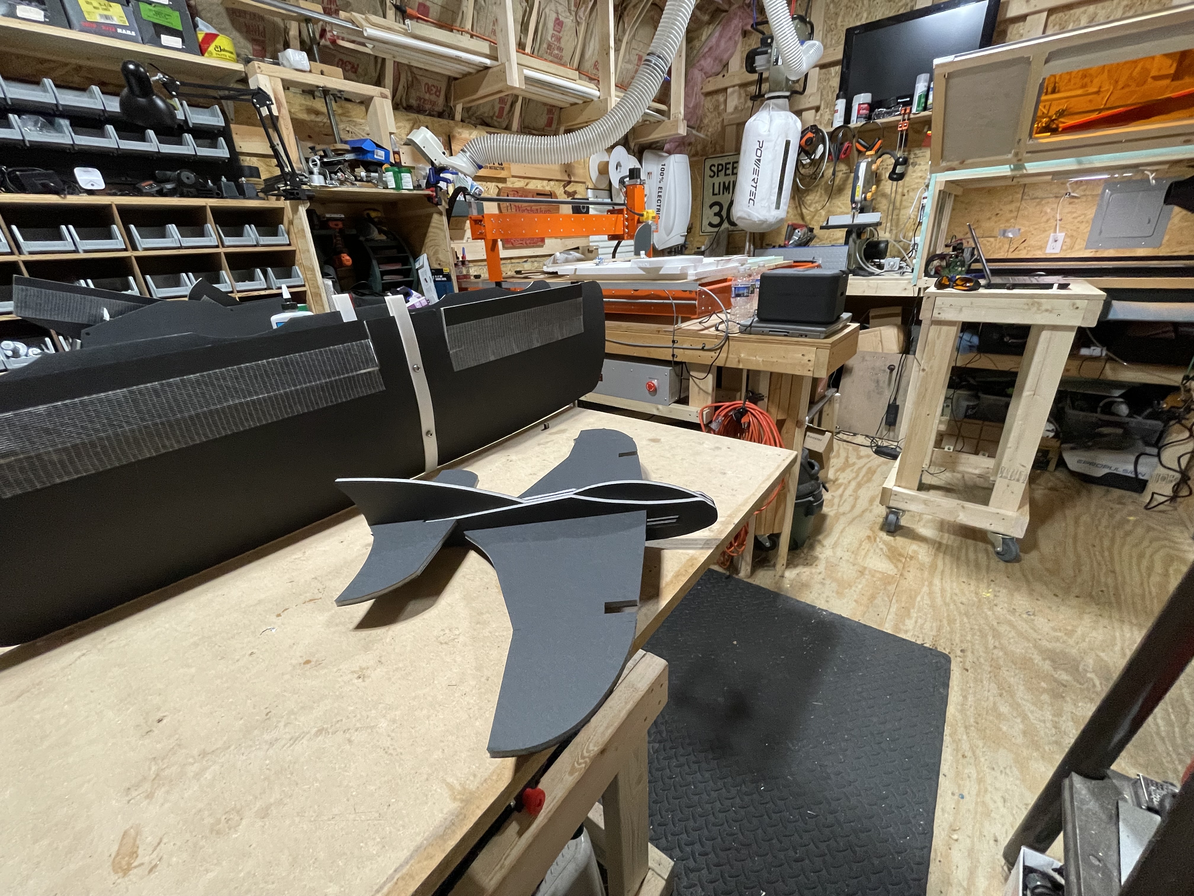

Awww. Now that is adorable. Electronics aren’t here until next week but just doing a little laser cutting tests on Dan Sponholz Intruder 15.
