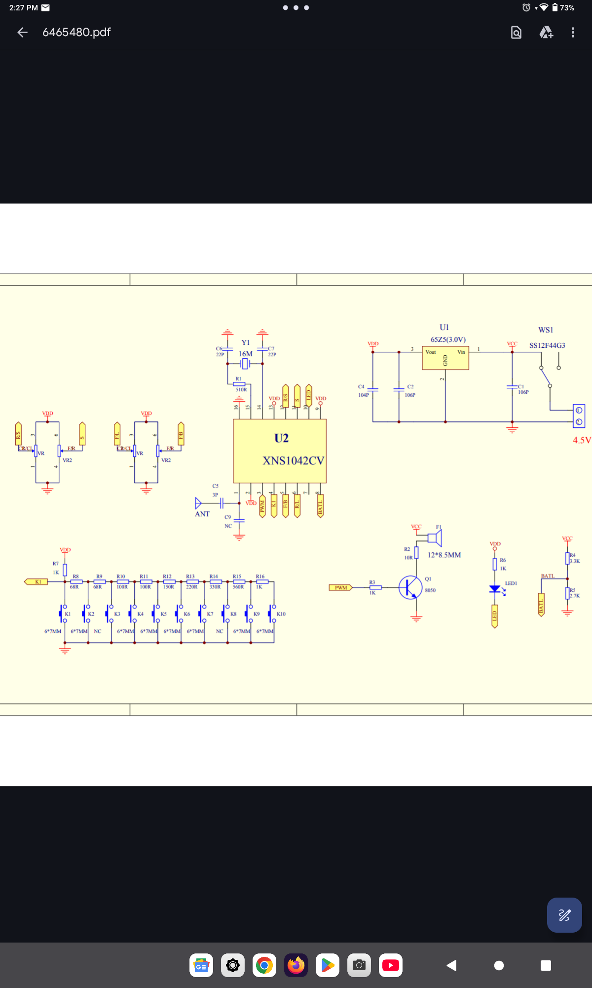

I need to look closely at my EZ FC.... wonder if there are any pins that might be hiding with pwm on them....... Probably not, but hmmm..... plausibly 1 on pin3... appears the XNS1042CV CHIP can be a TX OR RX, and the I460P is the gyro.
