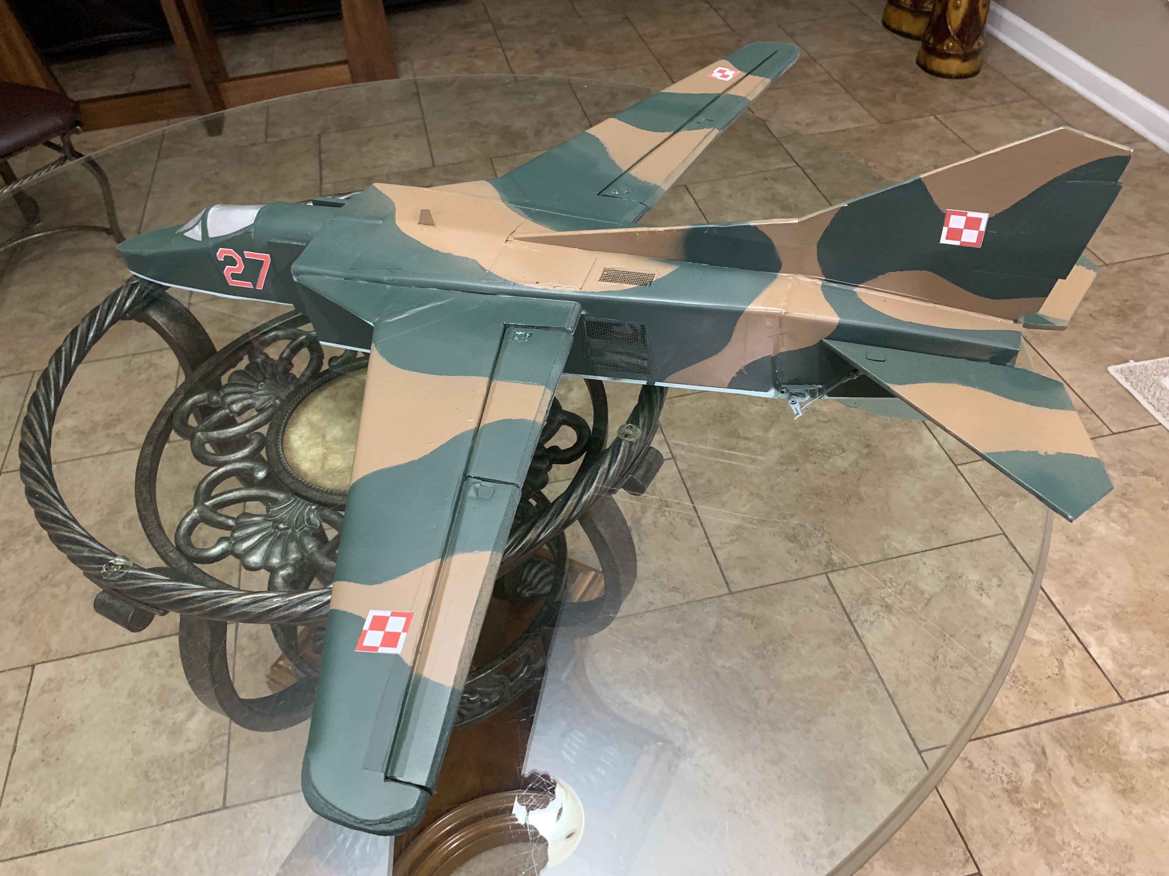

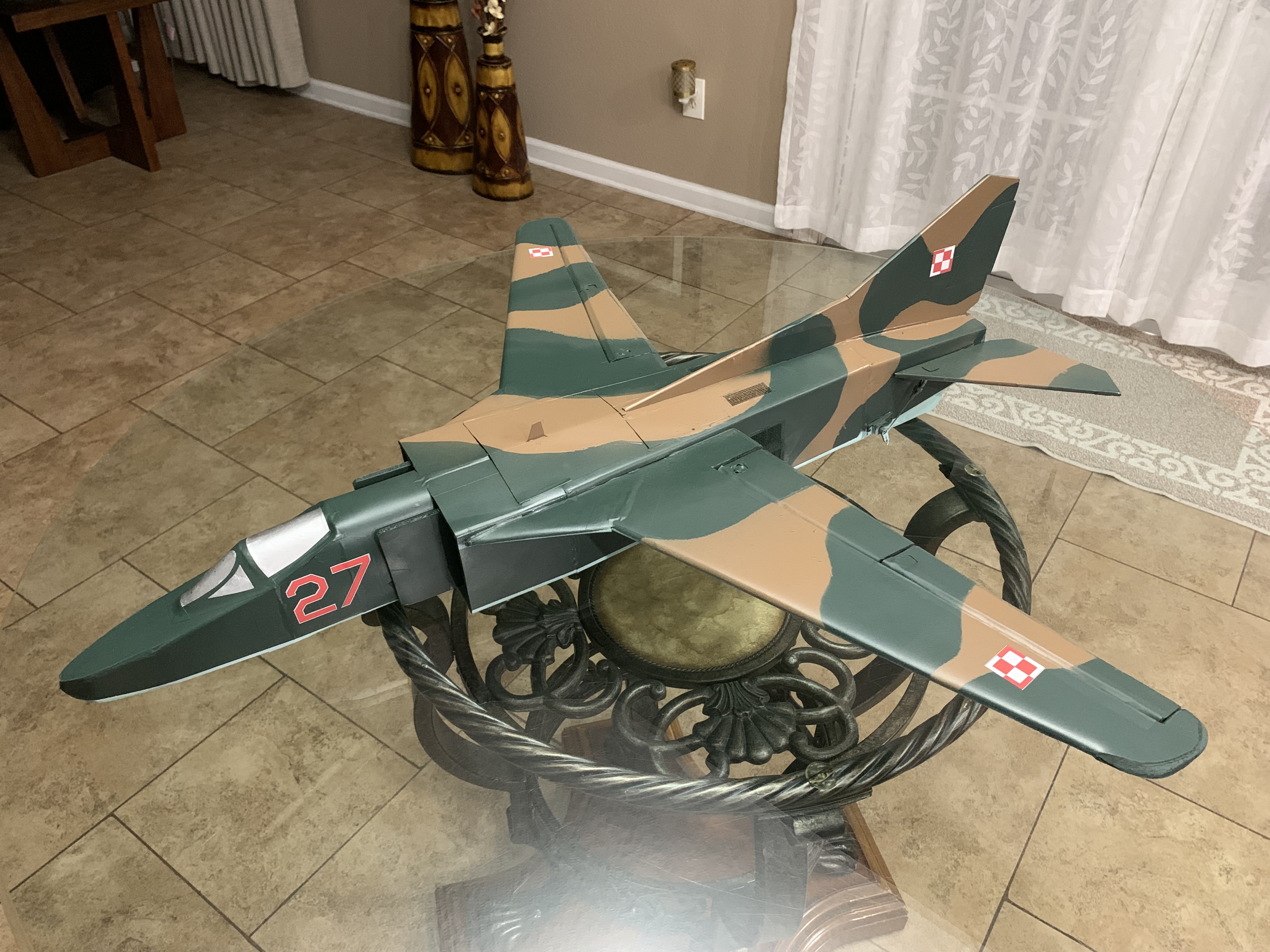

New MIG-27 - 70mm EDF waiting for maiden!

FlyerInStyle
those look beautiful. Could you happen to amke a 50mm or just convertible to propeller, J35 Draken? Its my favorite plane and htere isnt a good design that isnt 3d printed that I can find out there.
