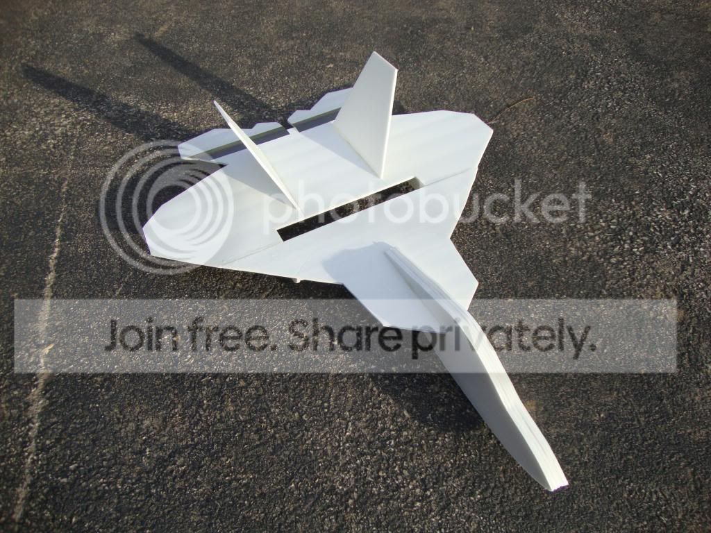

Money!!!!!!!!!!! I'll be building my first one tomorrow! Will be ordering the electronics soon. Here is a question for you guys. Local hardware store only had 1" thick foam board like josh used. He used 1/2". Will that be too heavy? I was going to notch it to fit into the wing part.
randelora
For the skids and fuselage I just sandwiched together a couple pieces of Dollar Tree foamboard. I wanted to use insulation but wasn't feeling motivated enough to go to the store.
