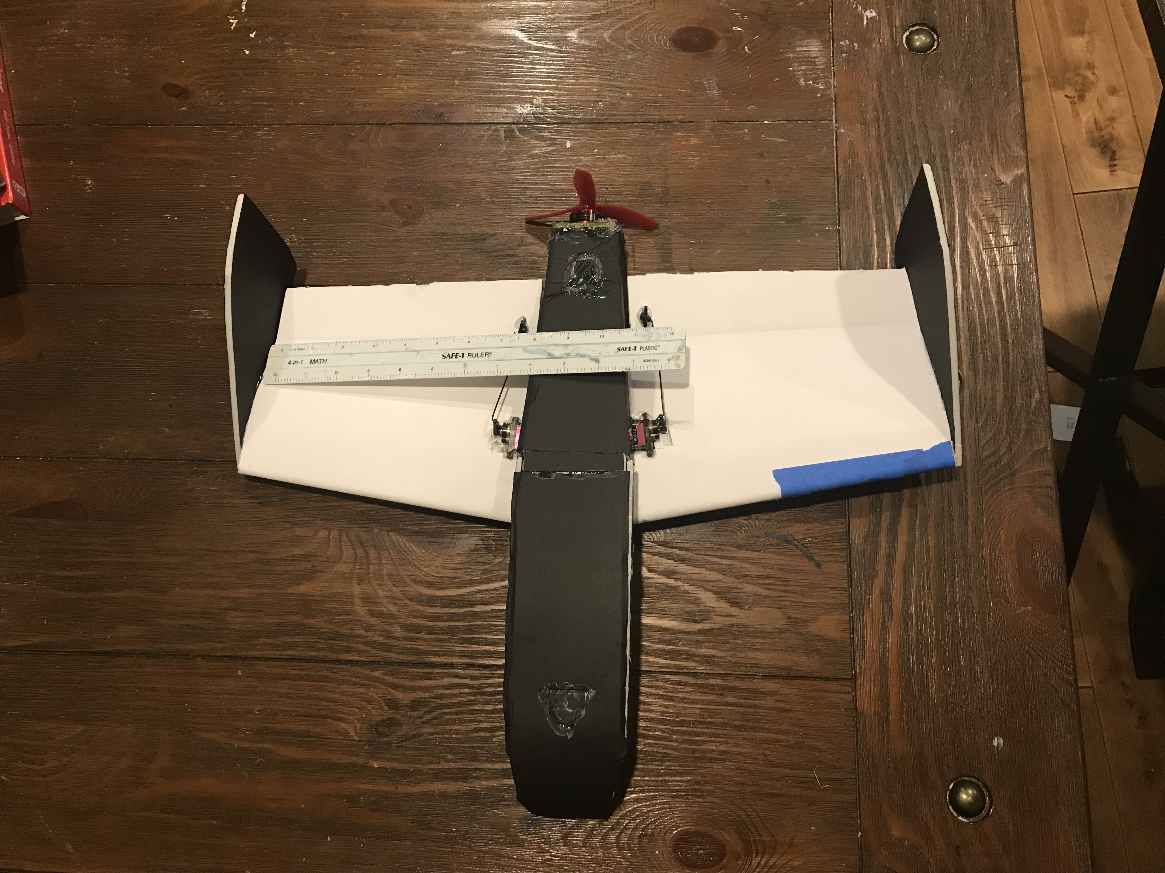

So yeah, on my version, I kept having to cut the wing to get the correct sweep, now it is 3 inches shorter than the ft mini mustang. (Wingspan of course.)

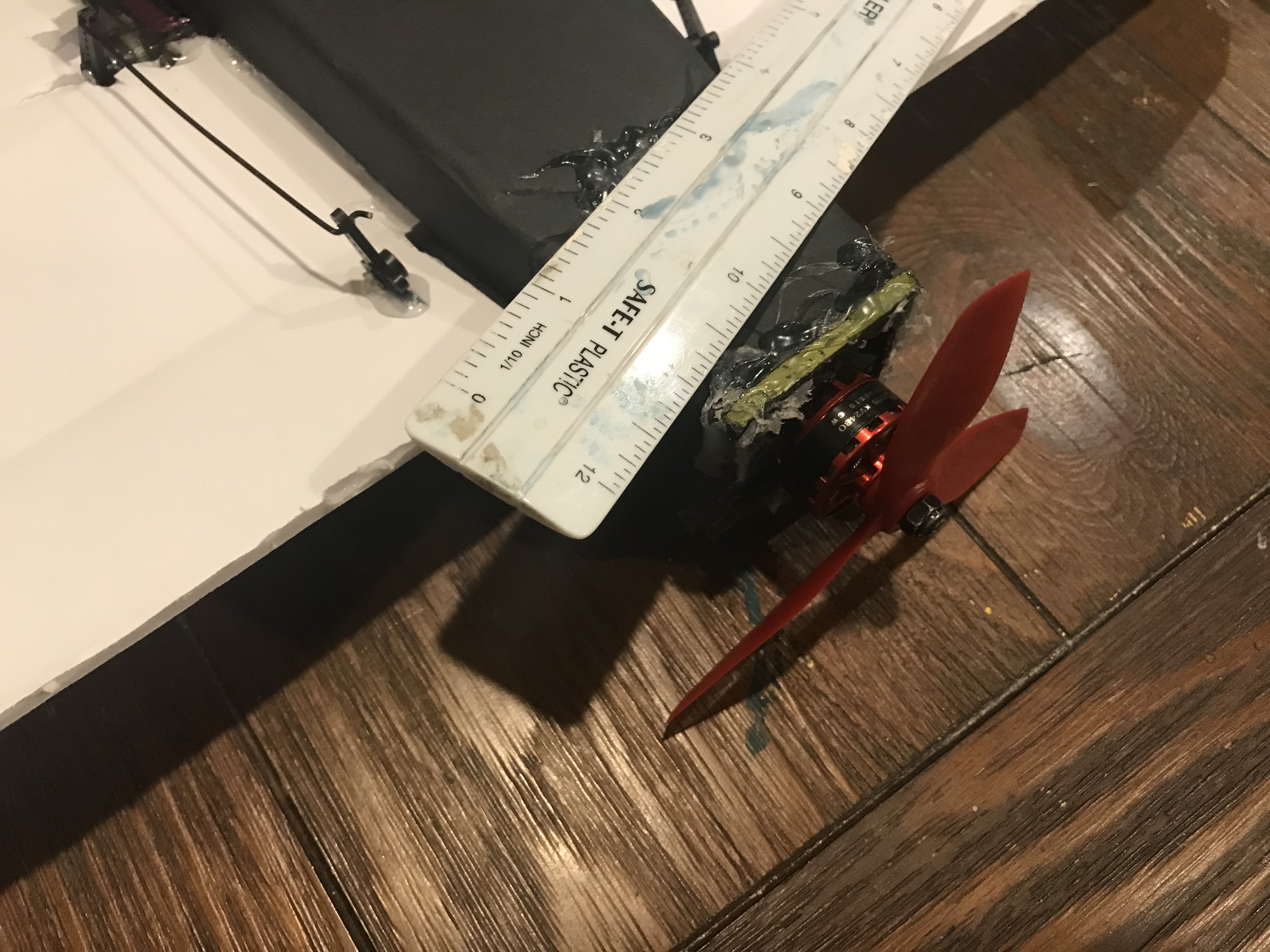

Well, my motor apparently is dead.😞. Found burnt coils. But, I’m switching to a 2205 2480kv red lite motor by edge racing, hoping for good performance.
Now to go over the easily repeatable mods:
1: removed 1 layer of foam from the spar.
2: formed the wing like a master series.
3: cut out the bottom of the wing where the servos go so they can sink all the way down in.
4: added sweep to the wing the way @Timmy recommended me too.
5: cut off the undercamber from the wing.
6: moved the vertical stabilizers to the wing tips.
7: reinforced the inner nose with popsicle sticks.
note, none of these are in any particular order.
‘Also, the nose actually lined up with the main body! My past two didn’t.
Well, no go for this one, couldn’t get it to balance. I’m starting to think that the cg is in front of the wing, (I did change the airfoil after all.)
