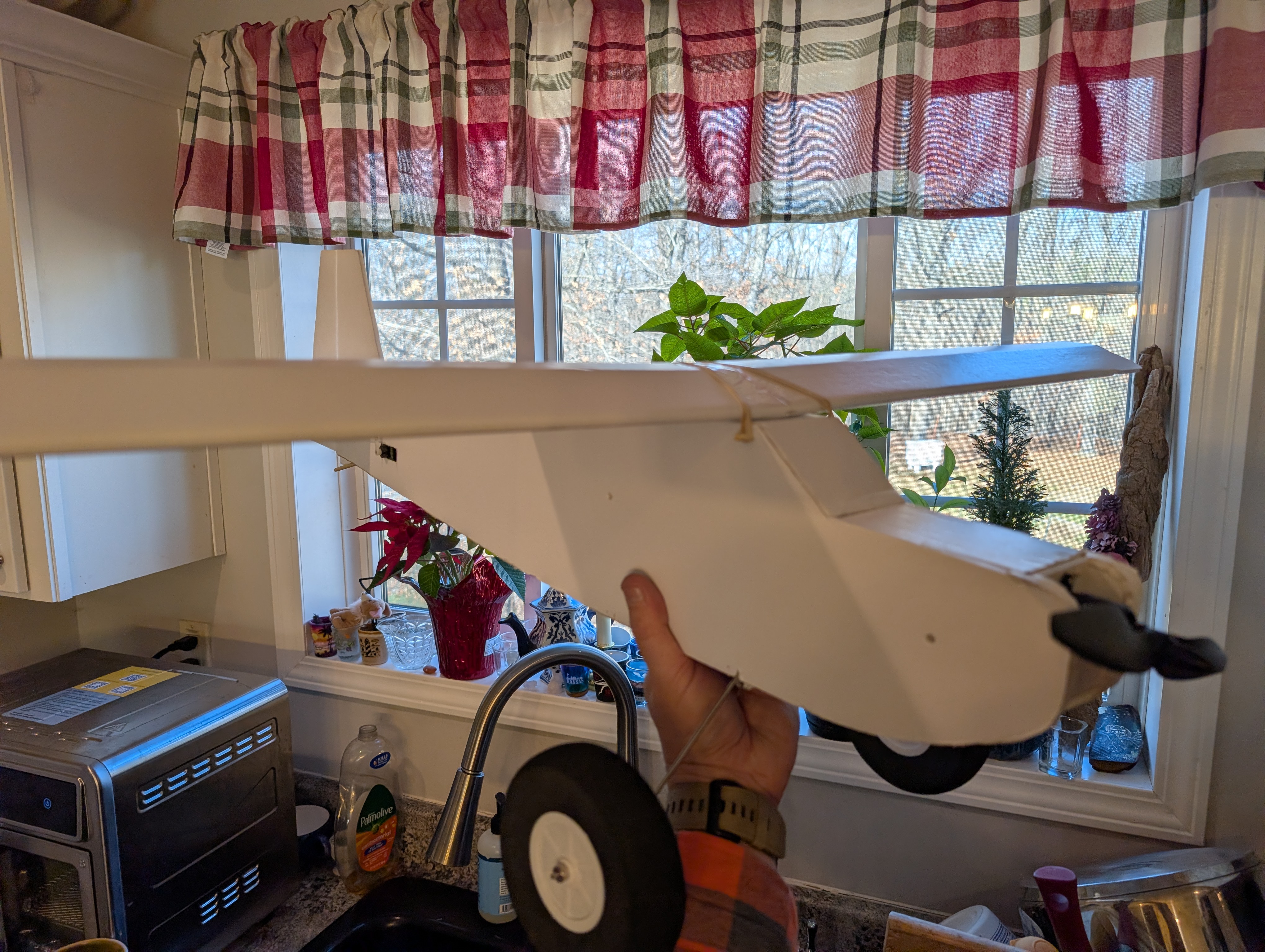

I have not test glided it. I'll look that up and try it. I'm confused as to why it's so nose heavy, needing the battery that far back. I used all of the same parts as they did, including the battery. I bought the power back directly. Maybe I have my landing gear angled wrong? Here's a picture of the build. I can add some tail weight to move the battery forward. It's almost over the cg right now. I put a small piece of foam in as a spacer to make sure it couldn't break loose and fly forward.

Did those wheels come with the kit? If not they might be why your nose heavy. If you can remove them easy, pop them off and check your cg. Again haven't built the tutor, but heavy wheels infront of your cg can make it nose heavy. Which might explain why you have to push the battery so far back.
RickHunter
If the wheels are the case. You might be just fine with the battery towards the back as long it is safe and secure. If not you can also add a little weight to the back to bring your battery more forward. I use Tire Sticky Weights from Amazon to help with cg issues on my builds. But there is a ton of things you can use. Just don't make it too heavy. Always better to be nose heavy than tail heavy.
They are the wheels from the kit. It's all directly from Flite Test. Followed the video instructions. I could have used more glue accidentally, but that would be all. I'll pull up a still of the wheel angle from the video and compare to what I have. Thank you for the info!

Also, if your battery is bigger or heavier than the one he used on the build, that might be why you have to go further back. Nothing wrong with pushing it back if that is the case. As long as it is secured good. Plus I belive you said you've already flown it. If you were tail heavy there is a very high probability you would not have a plane left.
Avionics weight and location are nose heavy things also. Believe the relative term is called moment arm. From a design point, model aircraft have a significantly larger control surface requirement

There is nothing wrong with where a battery has to sit to balance the aircraft I would rather move the battery back then add weight. The lighter the plane is to a point will fly much easier especially for a beginner. Double check where the balance point ( CG ) is according to the plans.
