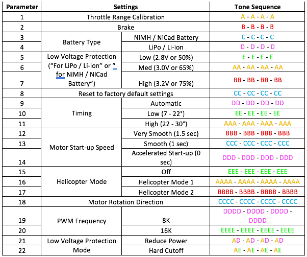

Does anybody know where to get a refence for the programming modes for the ECS that comes with A and F power packs? I think I figured out how to set the throttle range, but there were a lot of other beeps that didn't sound like any other ESCs I have programmed. I would like to know that I have everything else set correctly, and I like to use the brake function.
