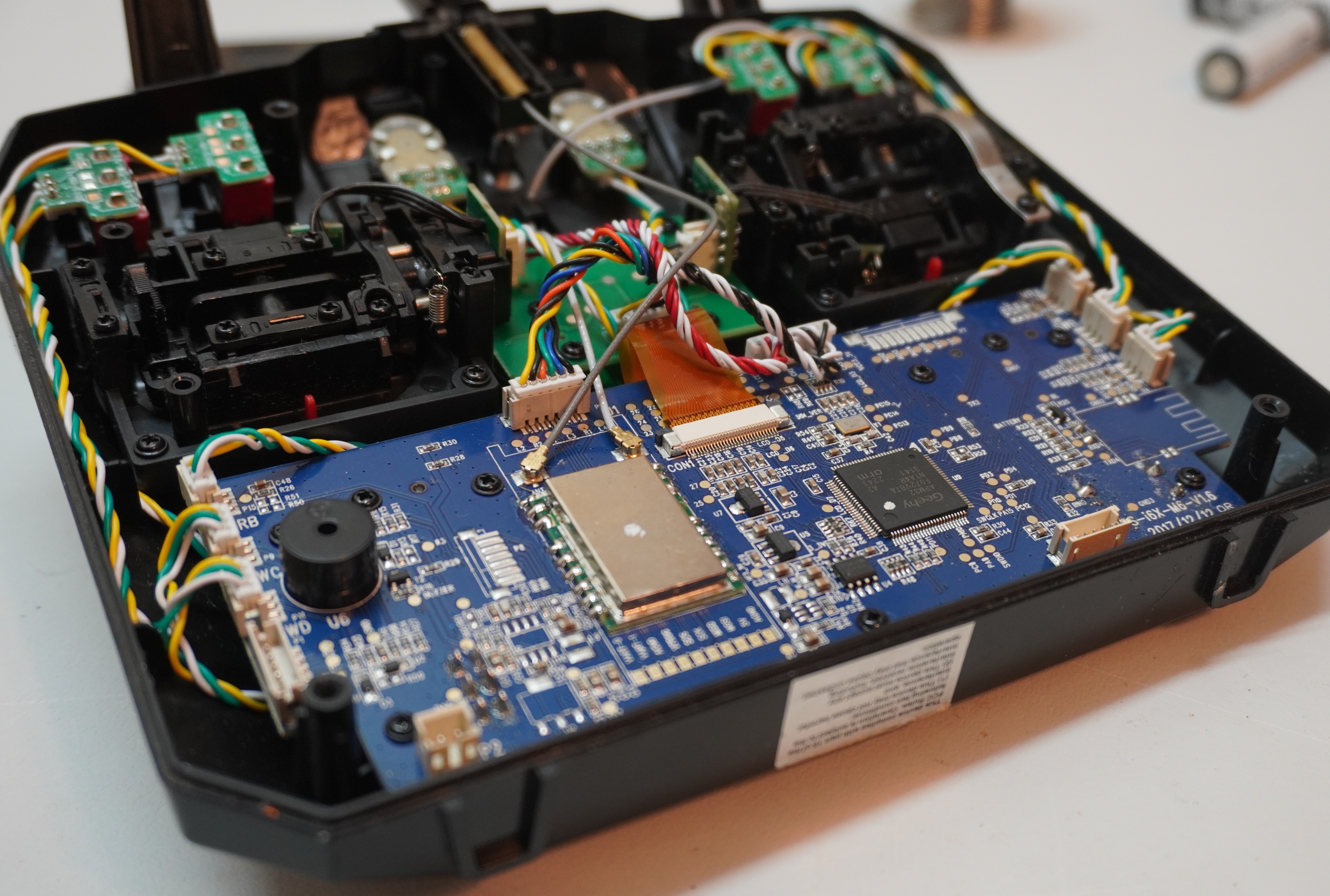

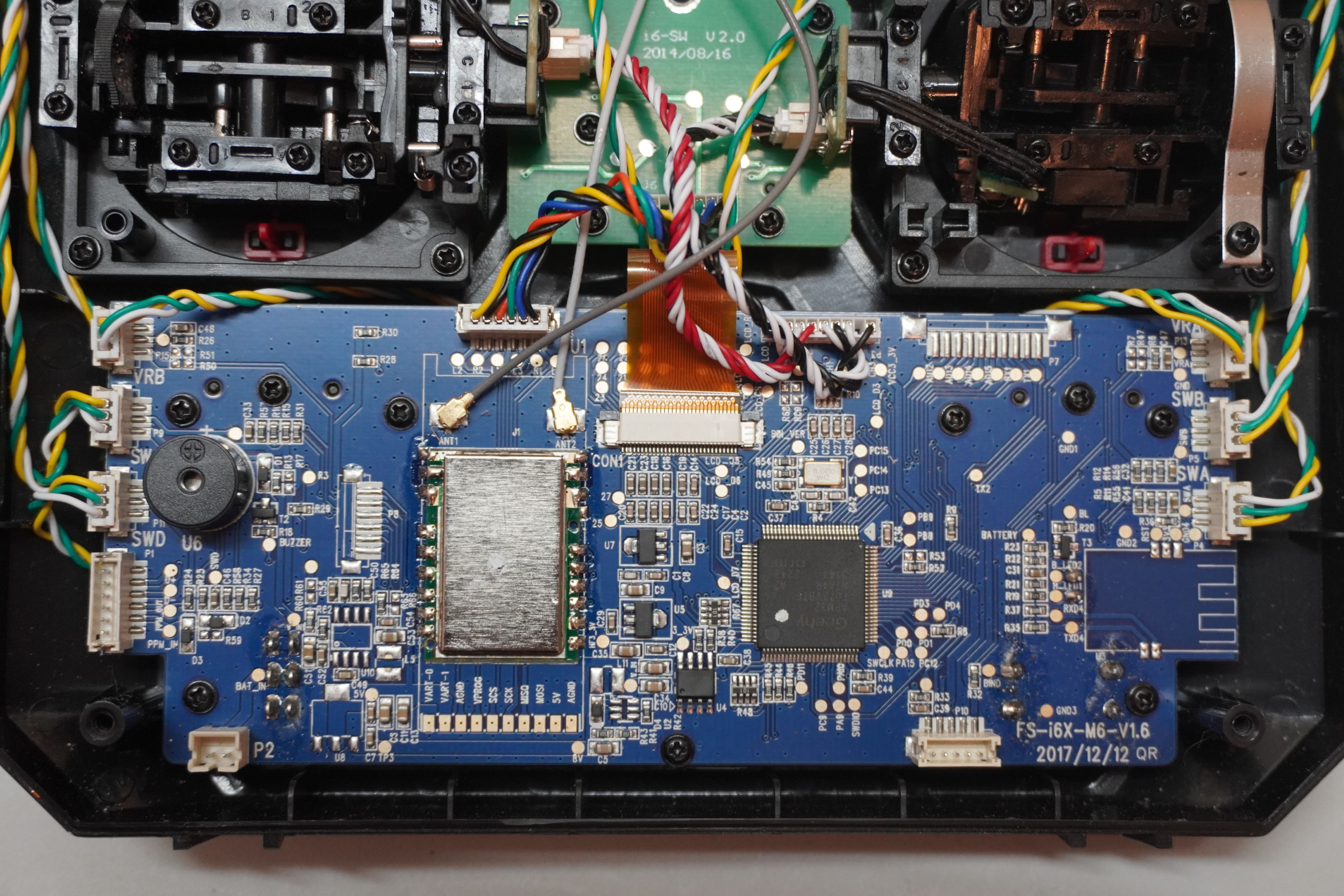

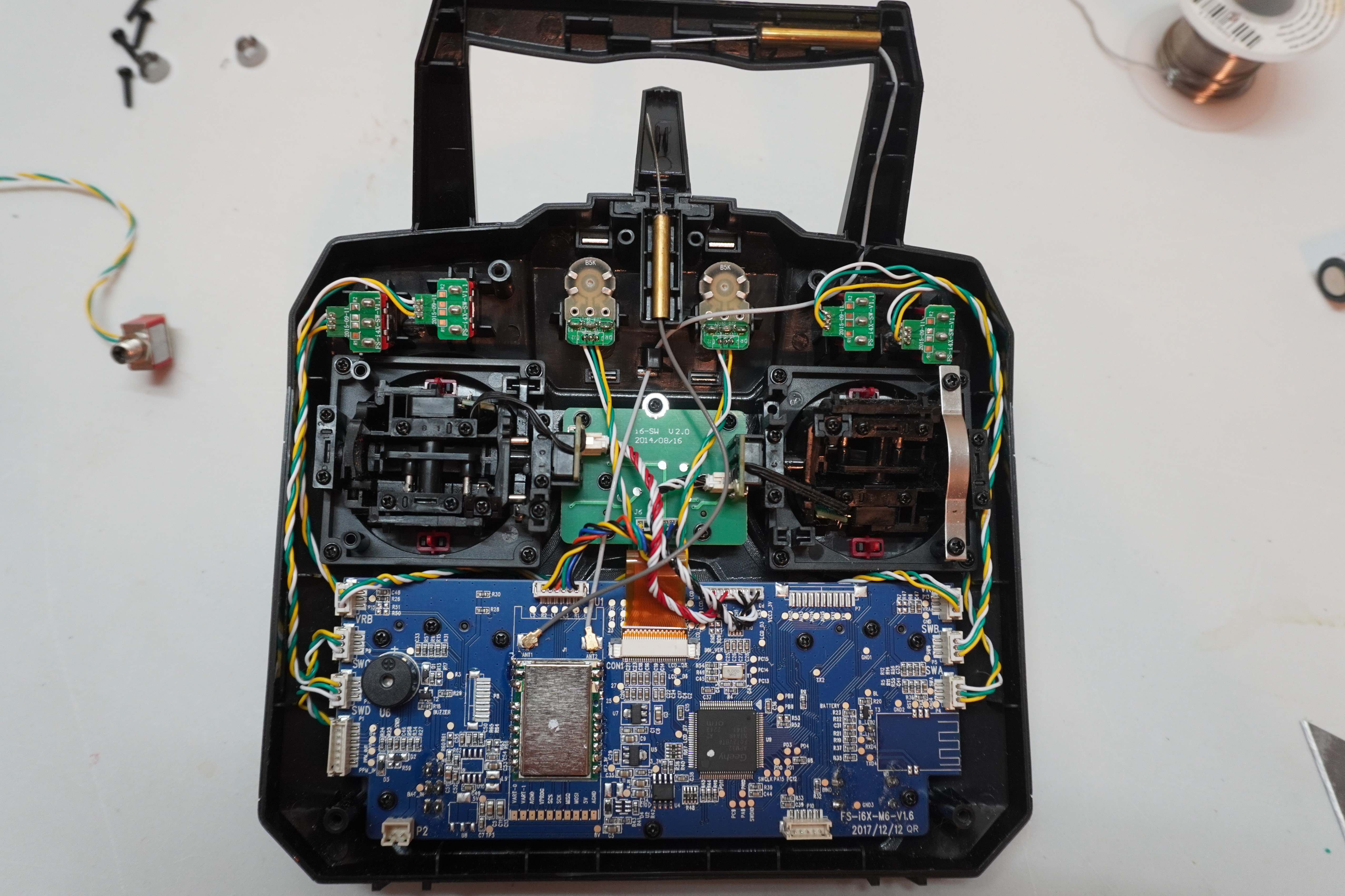

FlySky FS-i6X Teardown Reference Photos (for reassembly)
Hi ya'll! Here's some high res pics so if you need to know how something goes back together in your FS-I6X👍
