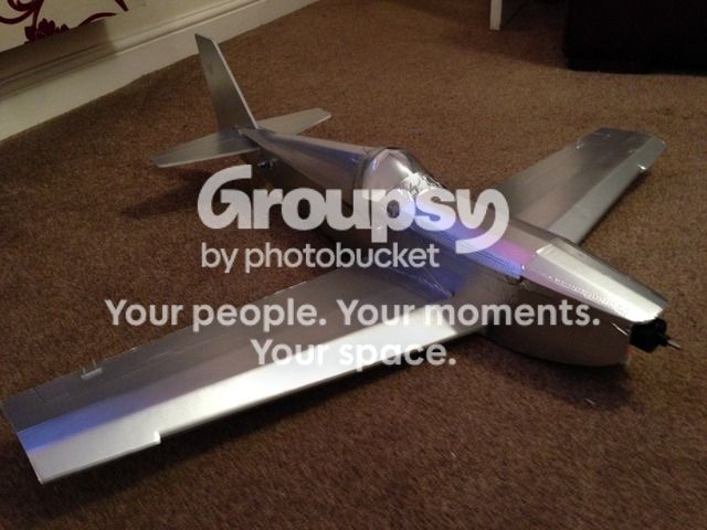

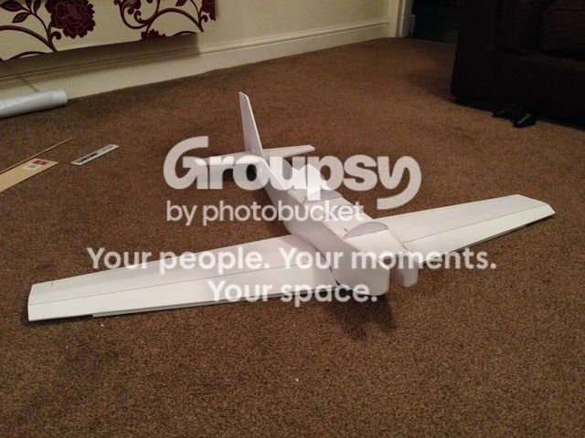

Hobby craft currently have buy 2 get 1 free, around £4.50 per A1 sheet.
Just Finished my first self build using it.

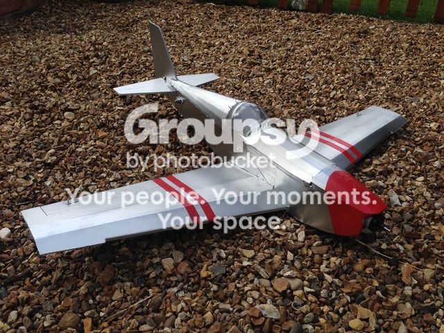

Here's my nnA10 built from Hobby Craft foam. It flies well and is robust at my local field which is a heath with gorse bushes!
nnA10 build log
