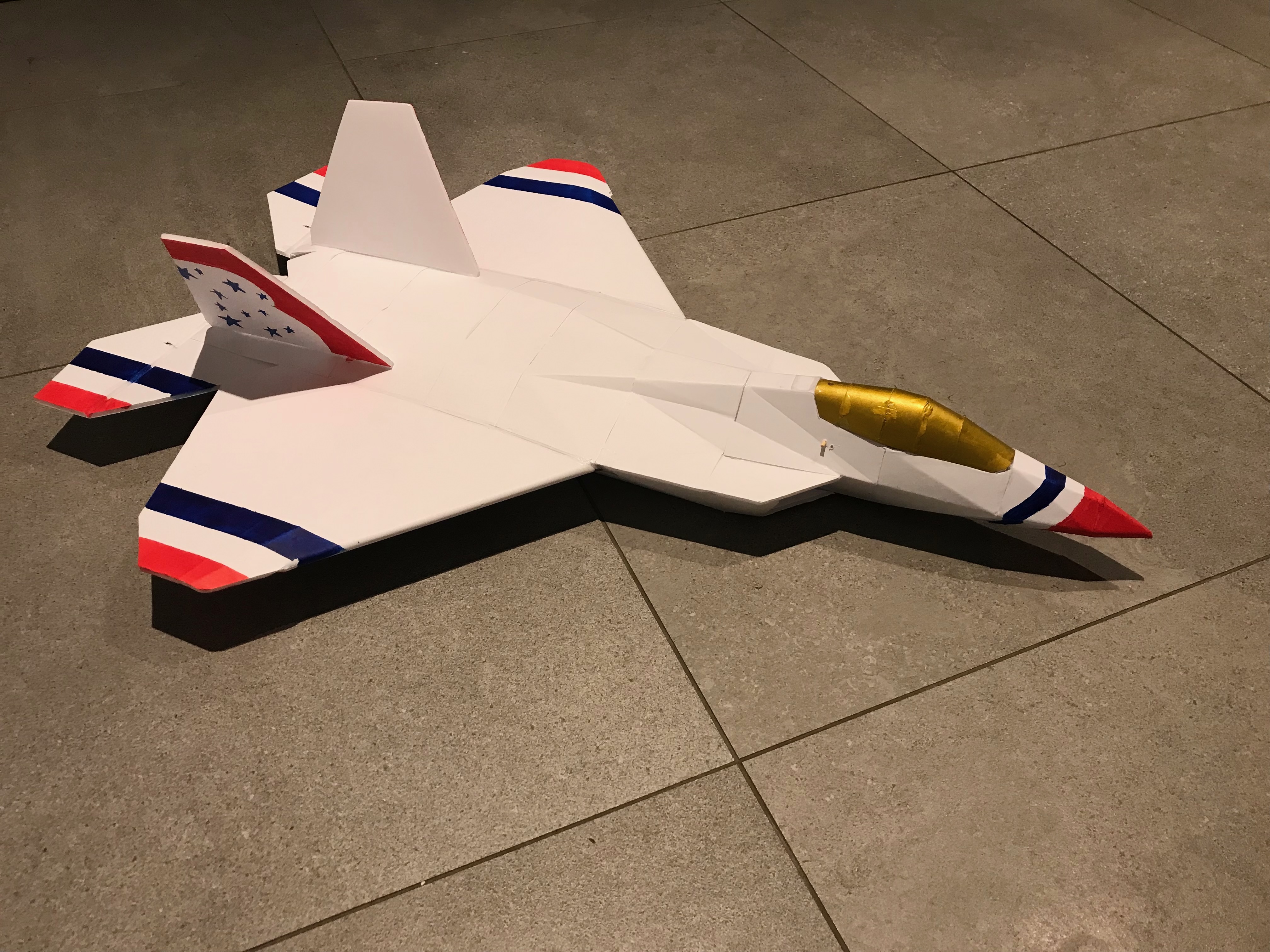

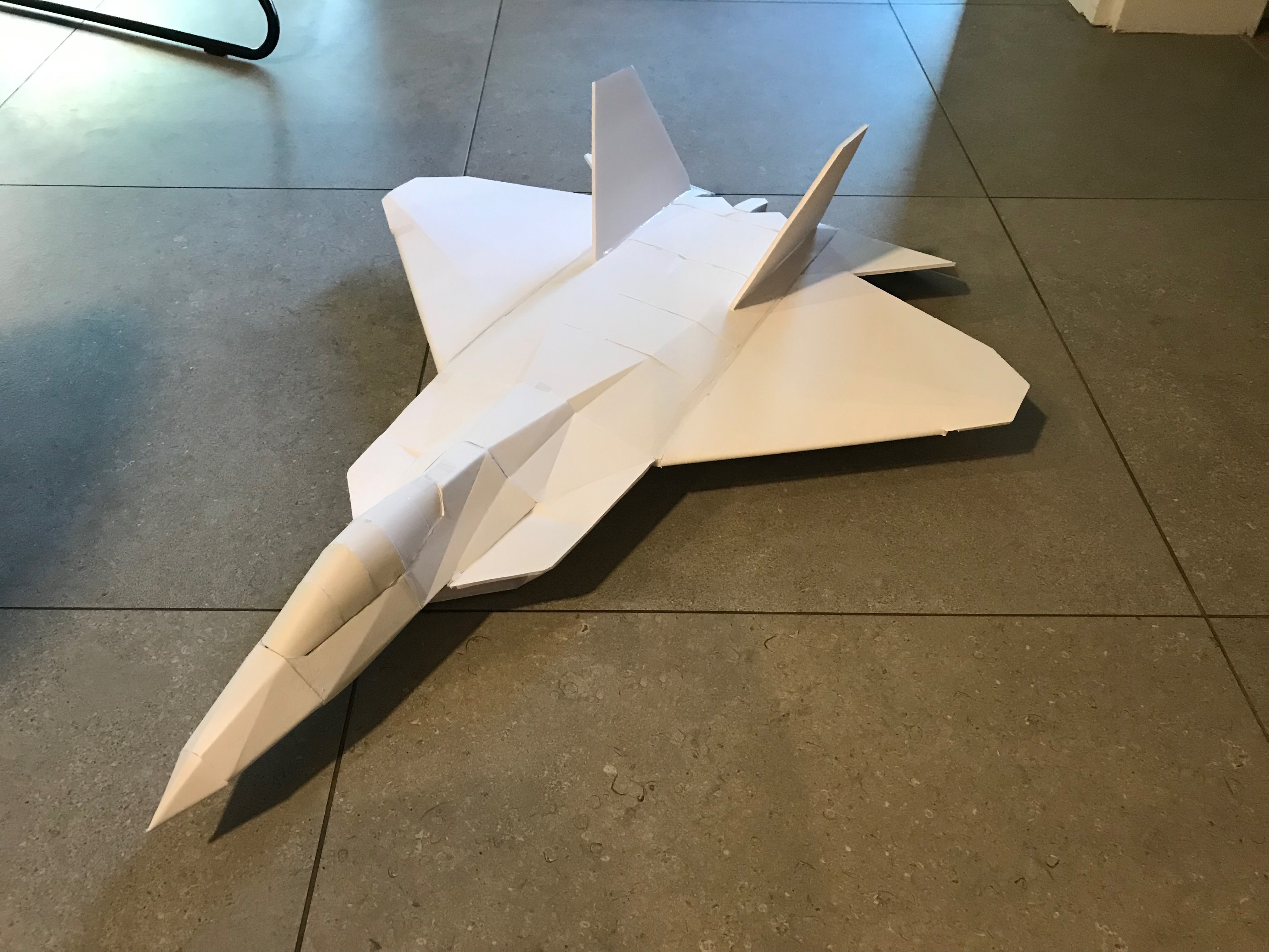

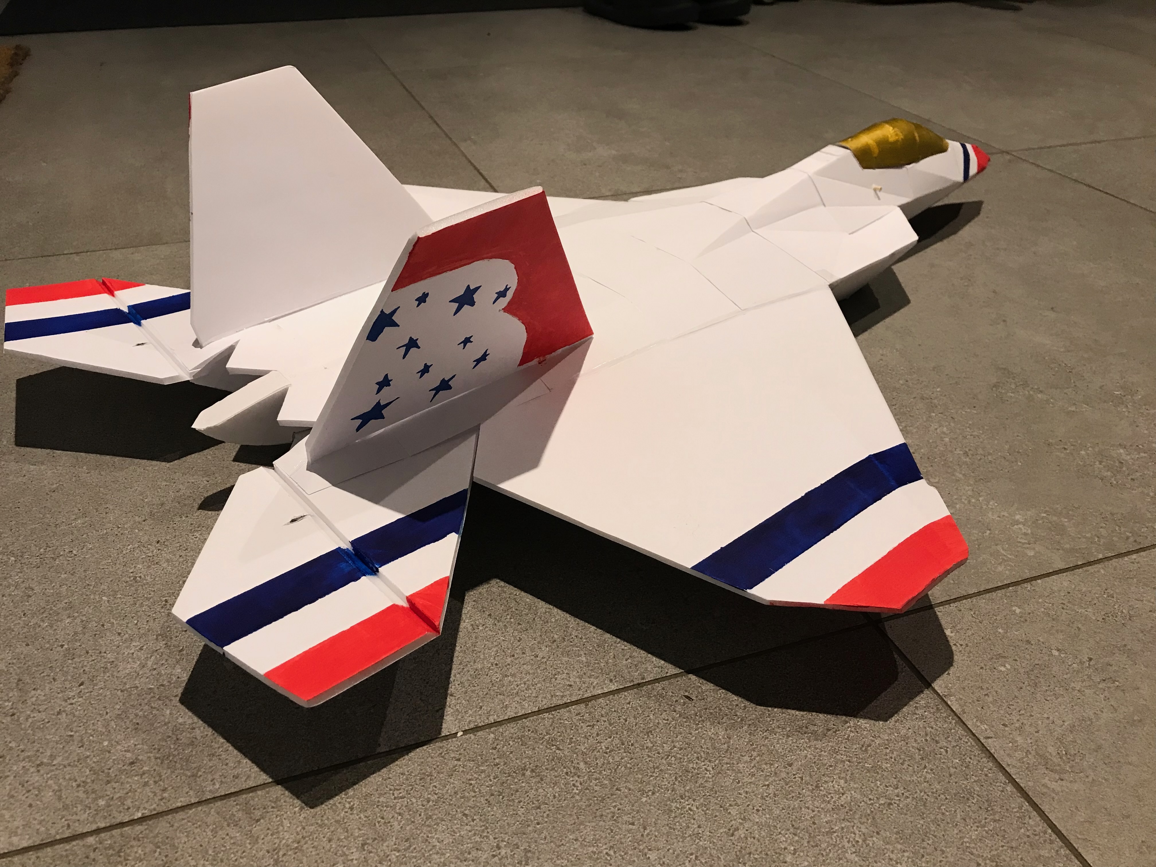

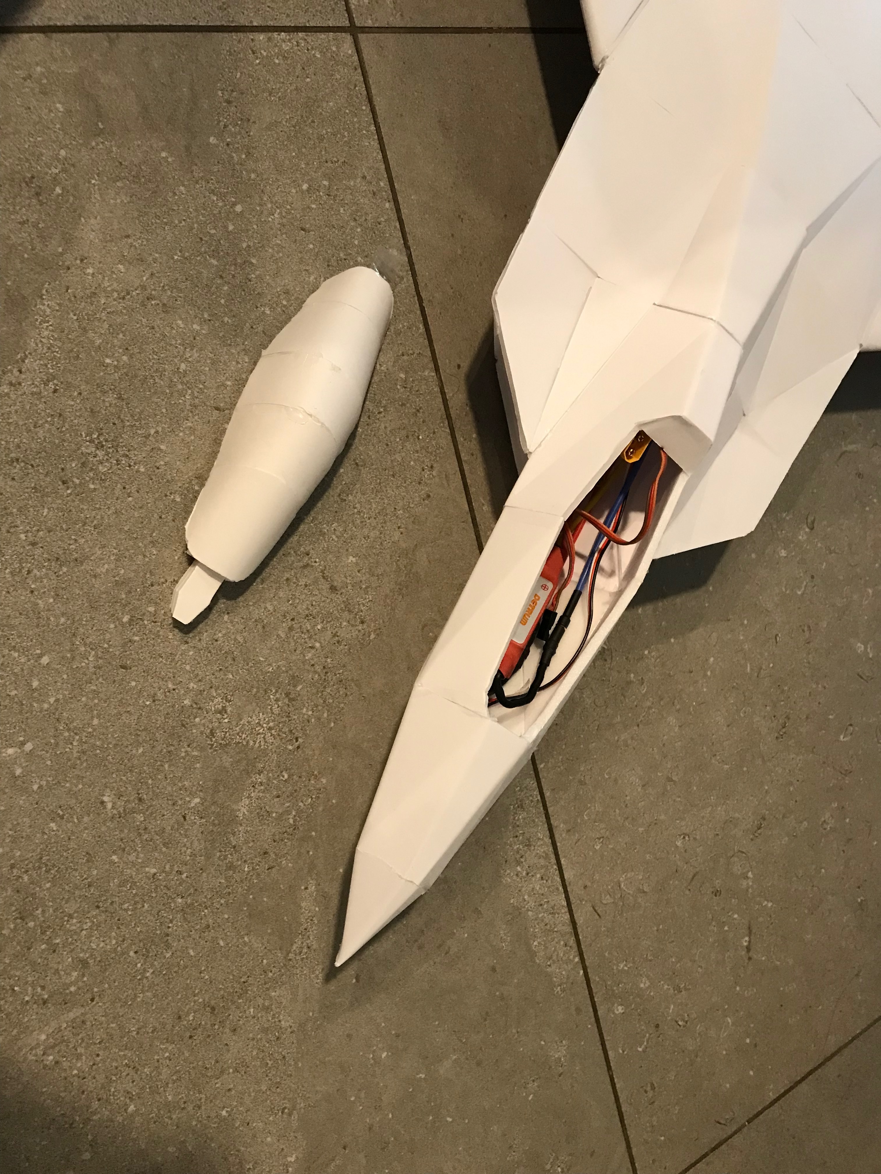

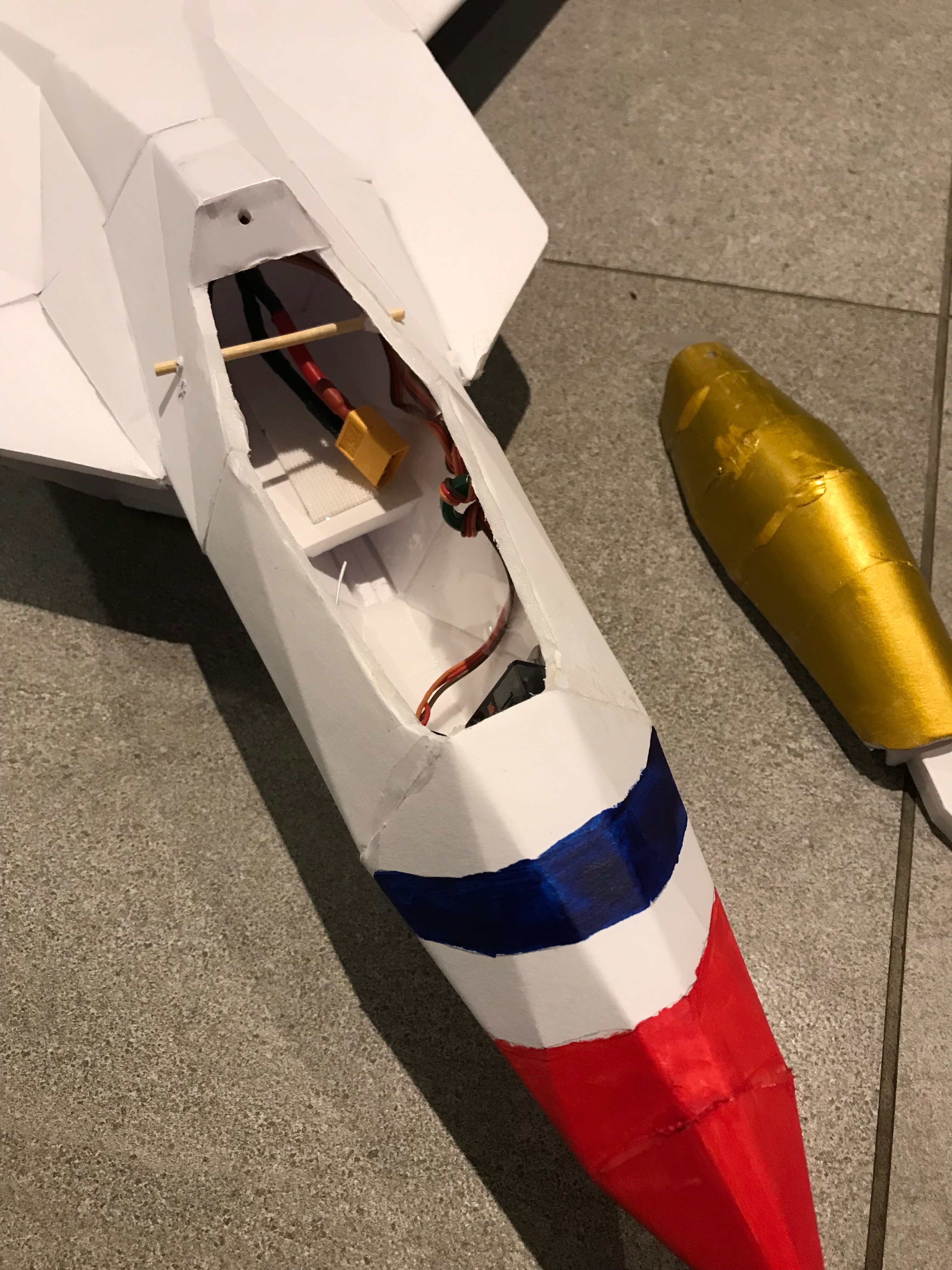

I use double-sided "scrapbooking" non-permanent tape to attach plans to the DTFB. As for keeping the paper or removing it, that's up to you. When I built this as a 70mm 6S, i felt it was lacking a bit in power which I attribute to the paper's weight and possibly lack of adequate airflow. You could also pick and choose what parts you leave the paper on where extra strength is needed.
Definitely a lack of airflow with mine.

Try this stuff, repositional adhesive, to secure the entire sheet, not just strategic areas with tape. Works fantastic.

ill pprobably give that easy tack a try, whas thunking of using a spray glue that i can get from work too, although its meant for vinyl trim and drywall
