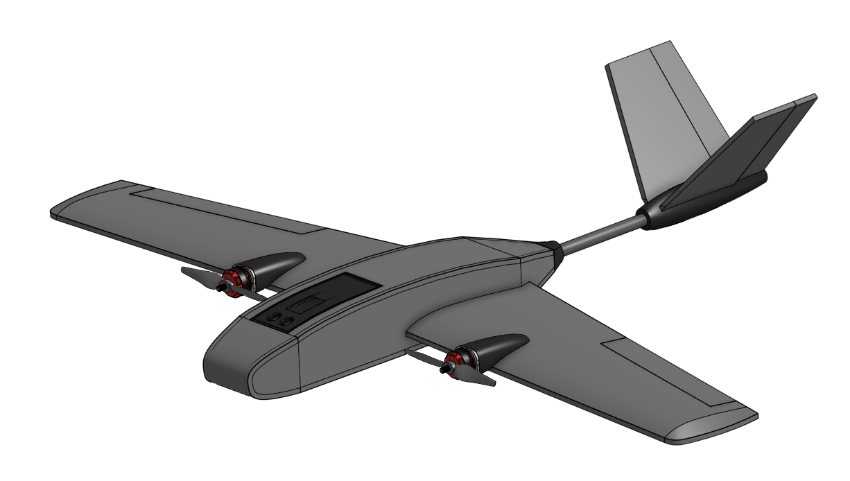

@Jo's squadron, you mentioned that a mini version would be nice, so I figured while I'm down with a cold what better time to design it..And here is a couple hours of work!😁😁👍

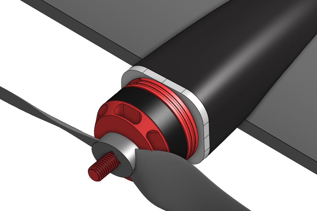

Has a 36" wing span and will run 2205 2300kv motors (Cause they are CHEAP on aliexpress and I have some laying around!😂😂) with 5, 6, or 7" props (will have to adjust battery cell accordingly) but with a 3000mah 2s it should be able to get 30min + flight times depending on the winds and load!
