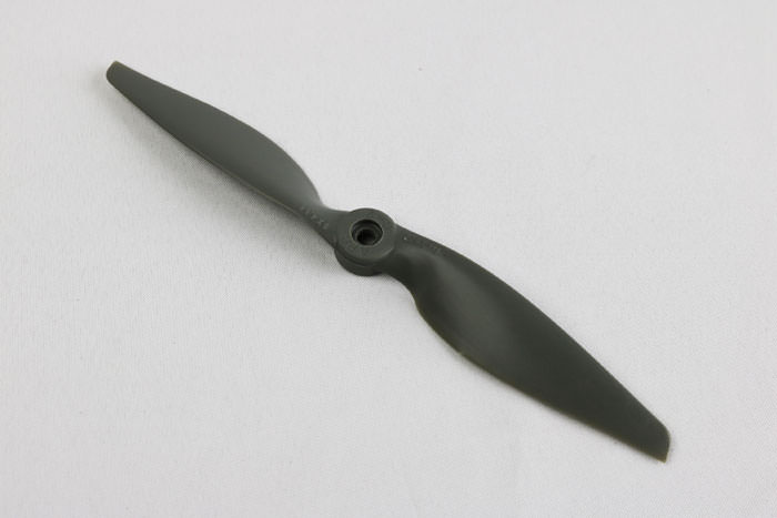

Power pack C does come with 10x4.5 props, but you can use other props with the motor as long as you don't go too crazy. I use APC 9x6s with all of the C pack motors. In my experiences, these props are indestructible, and actually work really well too!
I would try it with a smaller prop if you can before you go around removing parts of the elevons, although only 1/2 inch probably wouldn't cause problems. The nose weight also doesn't sound like a huge problem to me. You might be able to get the 20 grams by going with a slightly larger battery and even get more flight time that way.
