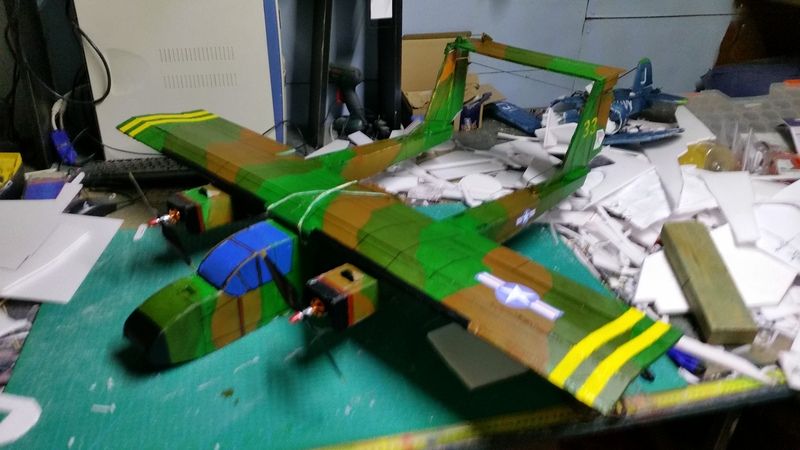

My FT Bronco, my first twin motor, flies very nicely, i changed the back slightly so i could put a door on and drop parachute army men....
This is made with depron, had a little trouble getting the wings right because depron does not bend
jtbluefeather
That's a good looking Bronco, Dangermouse! I too, love how these fly. I did mine in USMC desert pattern.
