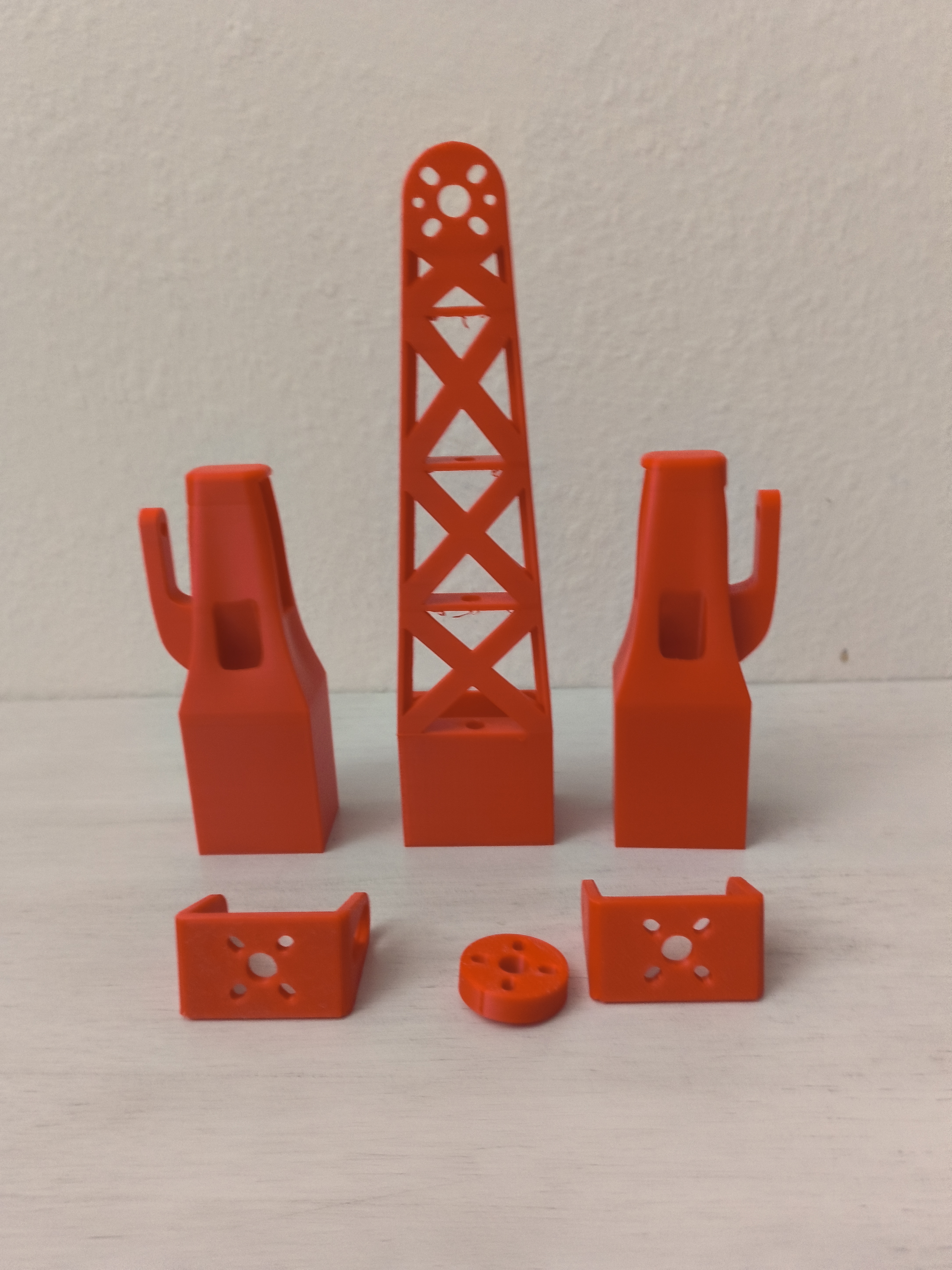

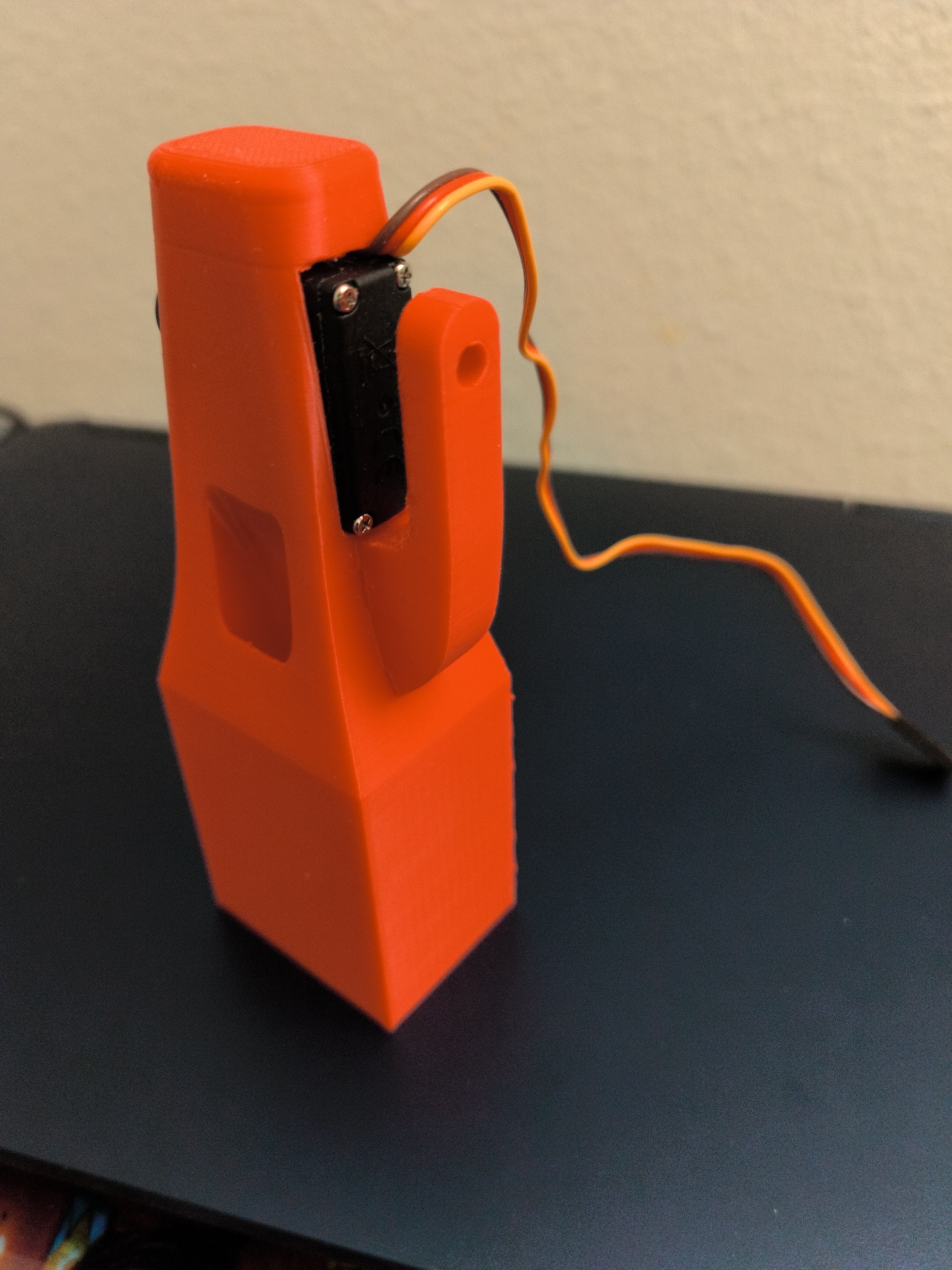

Couple of MORE questions... The 17 gram servos required me to do quite a bit of sanding to incorporate them into the mounts.. Maybe too much infill (50%)? Also the lead seems awfully close to where the motor mount would be attached? Still searching for the Flight controller but I believe I may have one shortly. 🤞

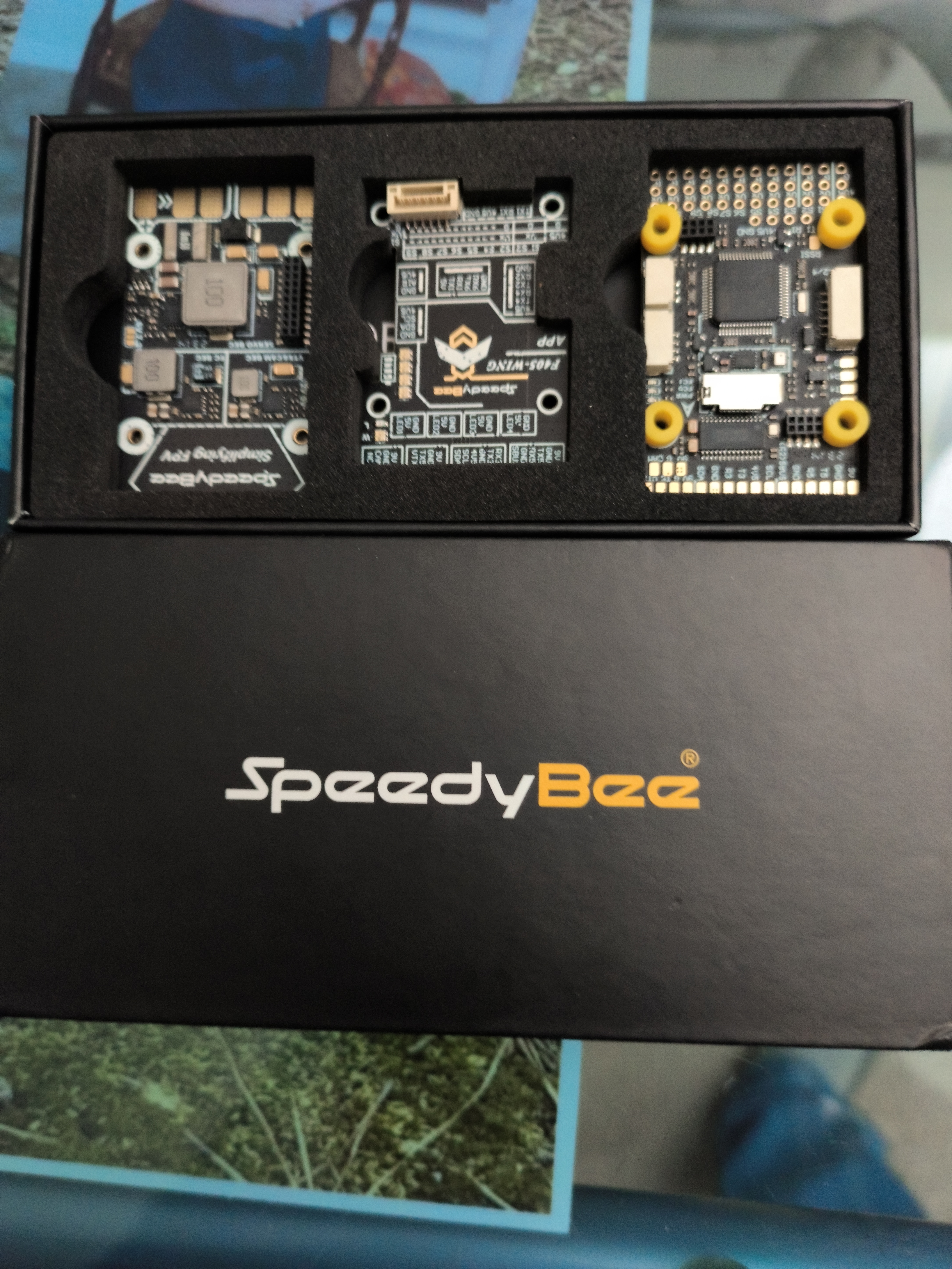

Major Score !!!
A buddy of mine had this never used and wanted $20 US for it. Please send me your settings. This is a winter project but anything I can get now will reduce the brain cell migration.
