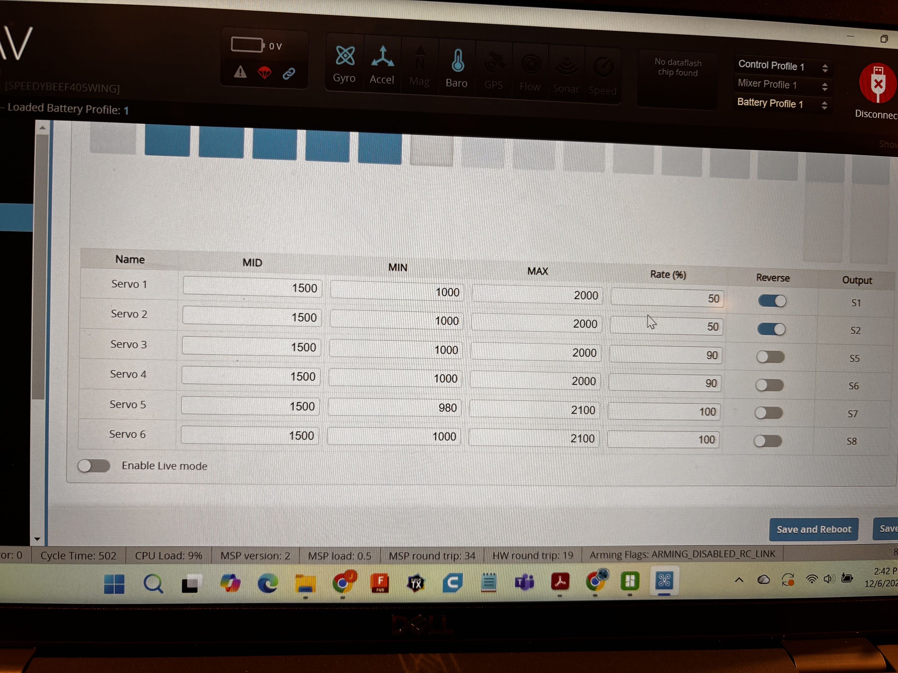

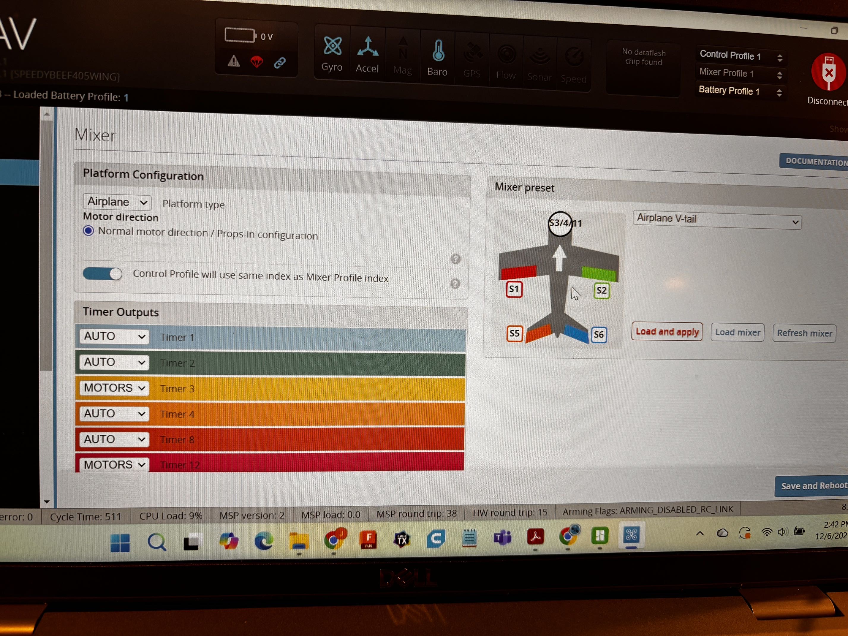

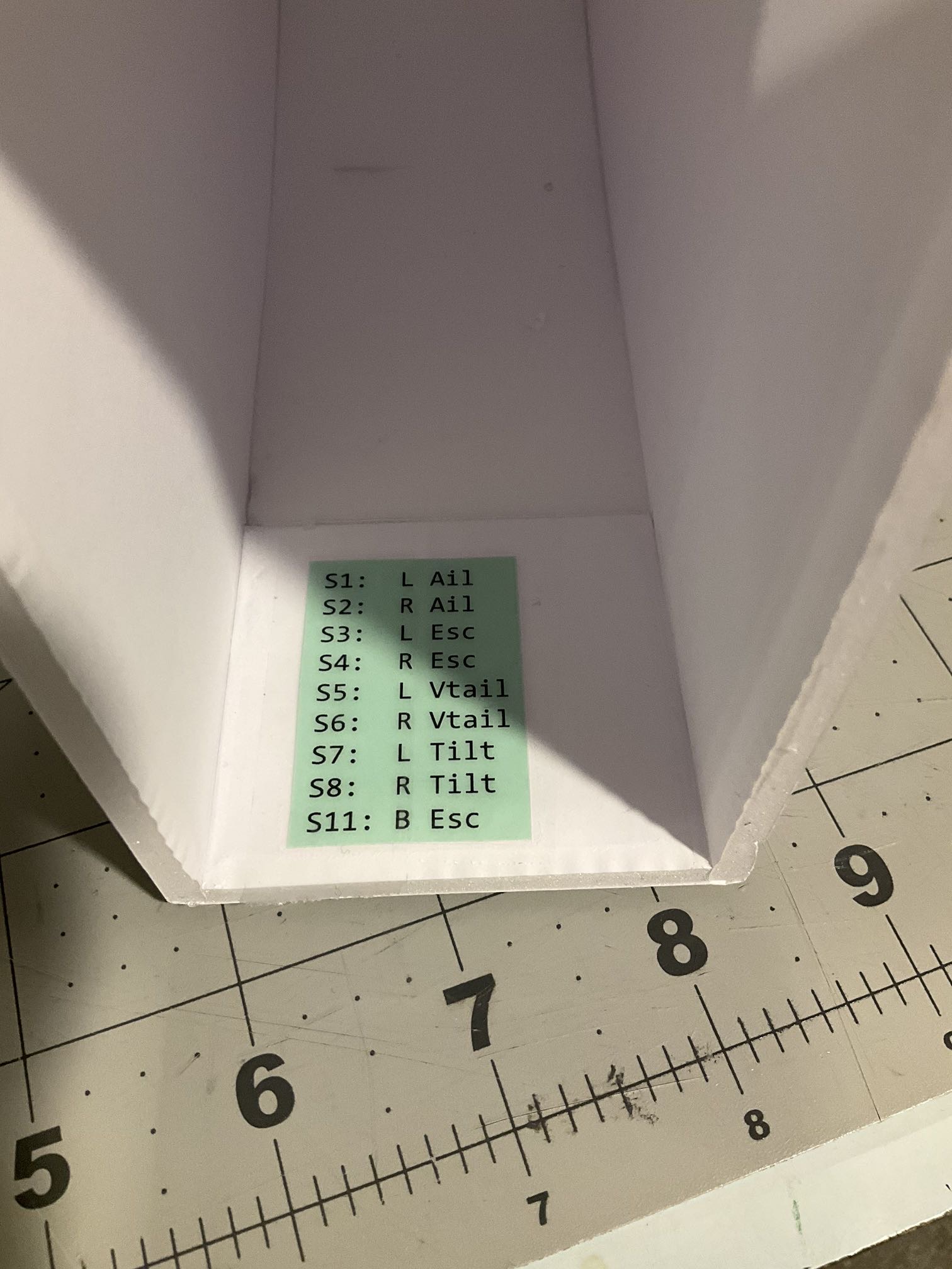

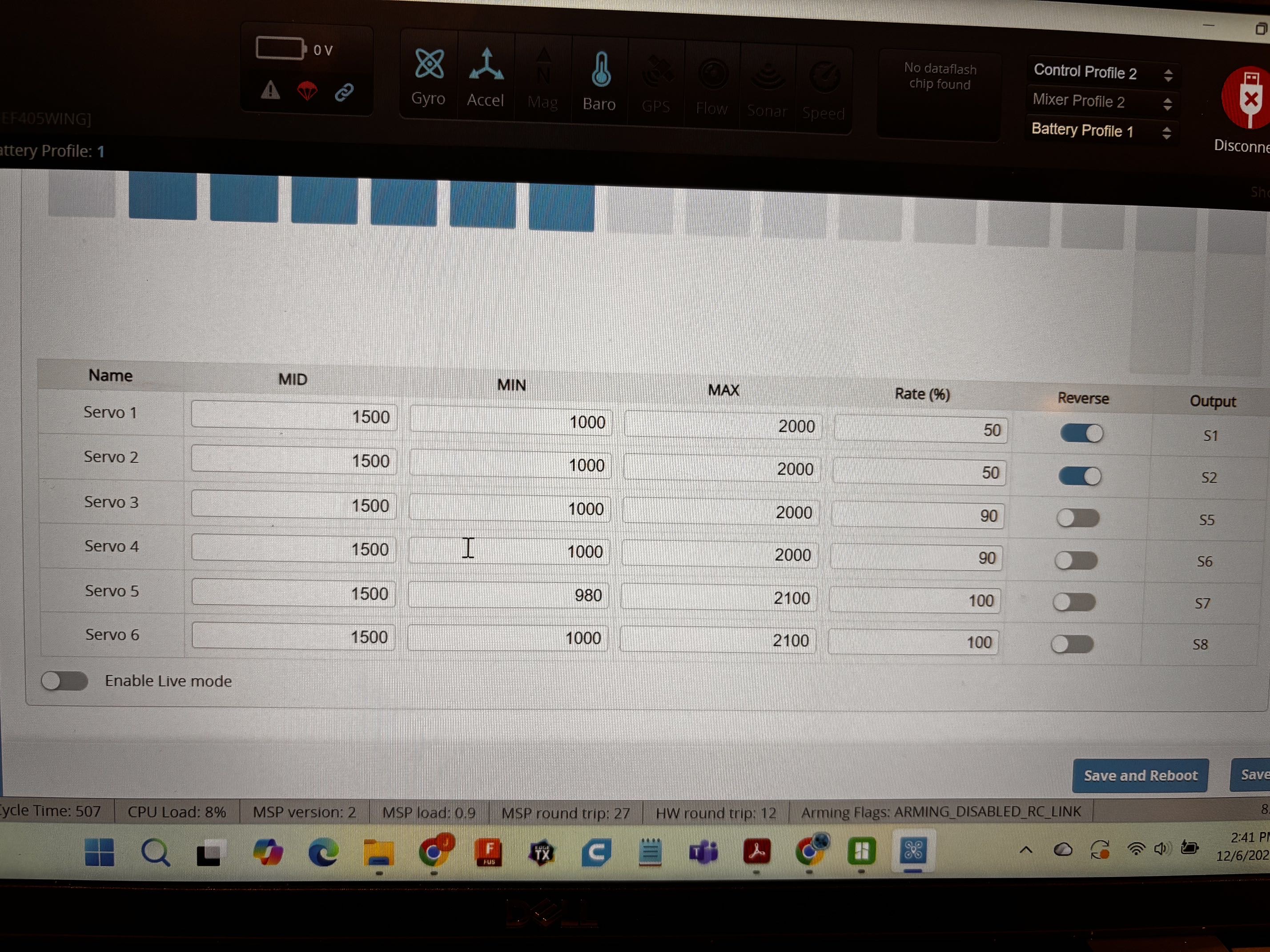

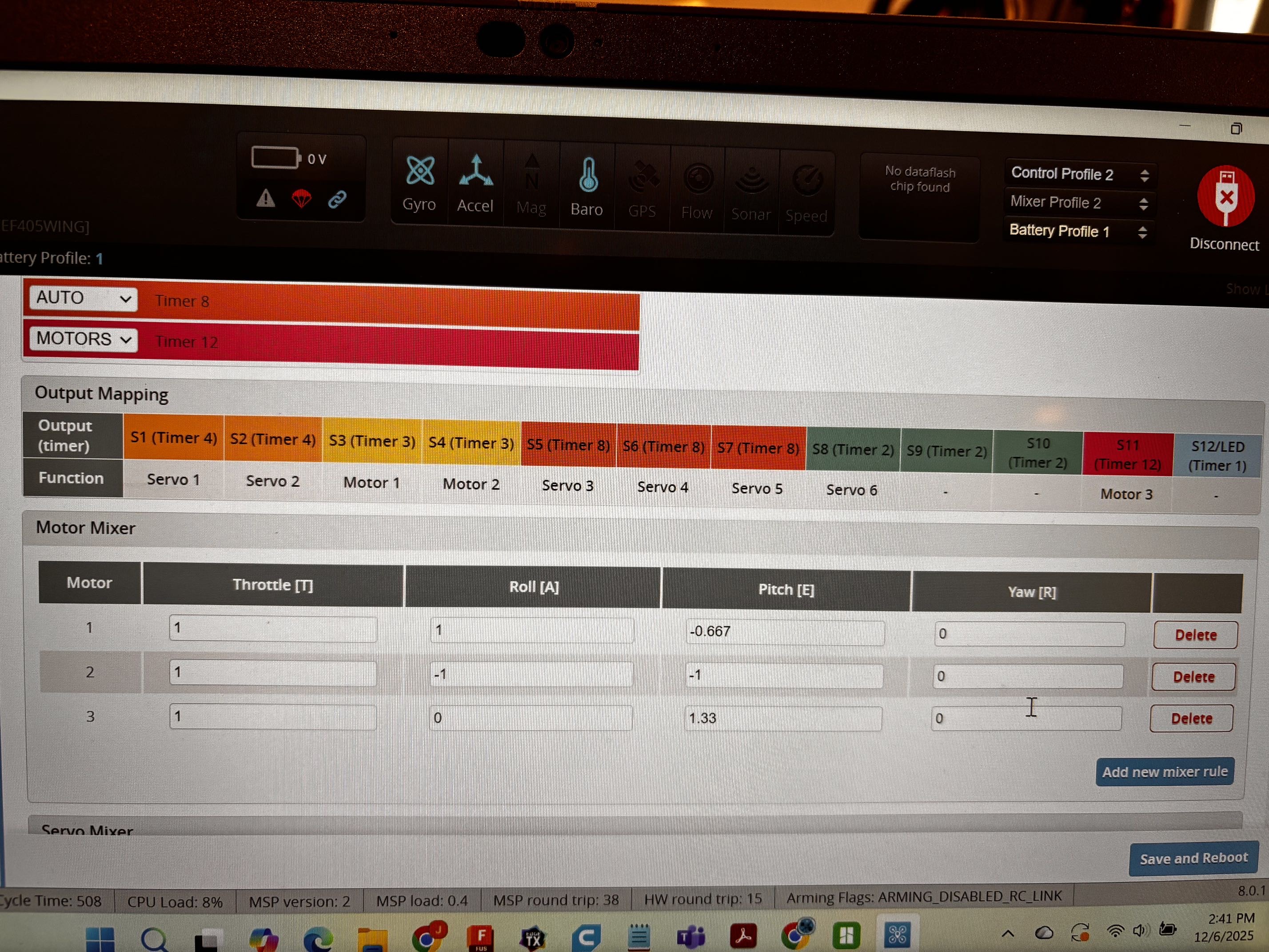

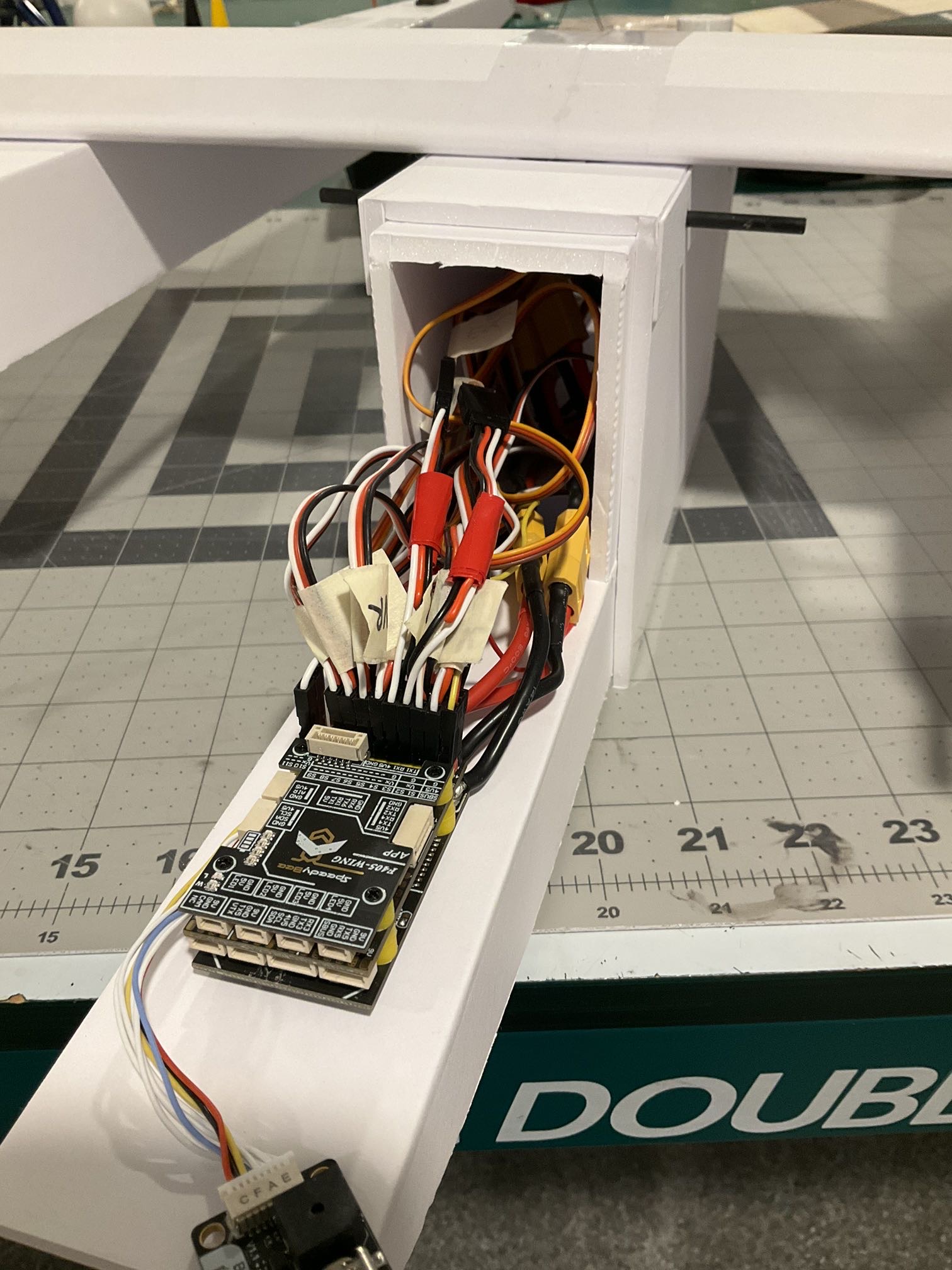

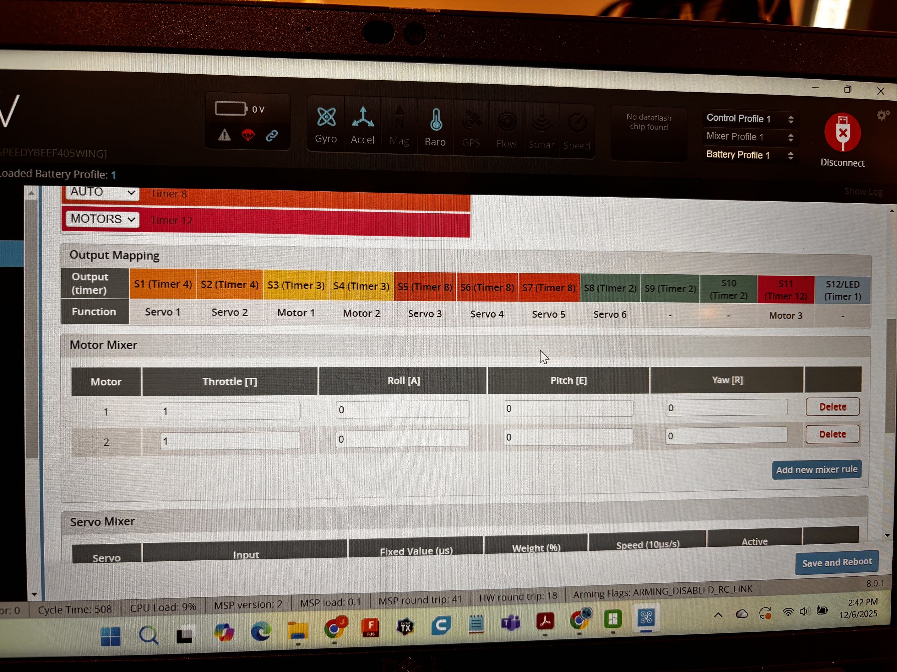

Photo dump I promised awhile back. Highly recommend writing down what goes where for sanity and attaching inside the plane for reference. My rebuild is done awaiting on new motors.
First two are inav parm’s for drone mode, next 3 are plane.
