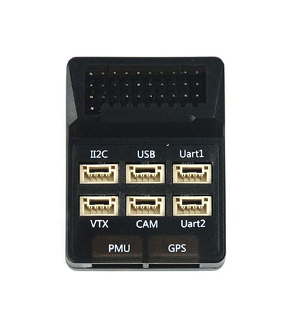

Not wanting to hijack Litterbug's thread, here is the flight controller (just arrived). Heewing xf-405. Only soldering is for the battery & ESC connections.. Everything else is installed and Ardupilot is pre cooked. Will continue to post as the saga continues.....

Vacating LitterBug's thread. All is not well in Heewing land. The flight controller refuses to connect to Mission Planner and thus I cannot configure all the settings needed. Heewing support, while at first seemed responsive and decided to ignore my emails. I have complied with all of their requests to send videos etc. but have no working flight controller. Plan B is now being deployed. We will dig out the Speedy Bee flight controller and warm up the soldering iron.

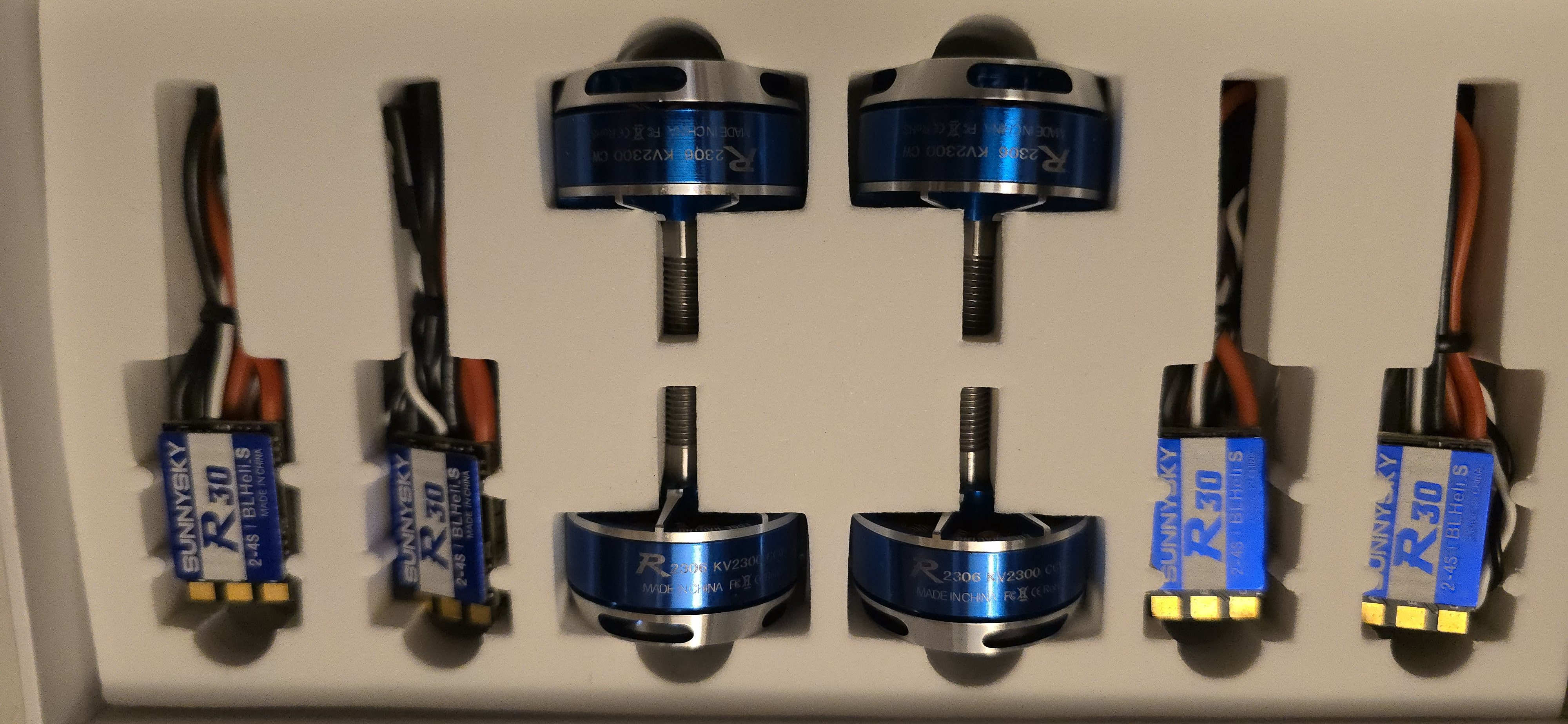

Mmmmm.... NEW "old stock"
HECK of a good deal for $90. 4 motors AND individual ESCs, 2CW 2CCW. Picked up the last set. Perfect for those who need independent ESCs with no BEC. VERY hard to find any more. So upgrading from 2204-1850KV to 2306 2300KV. Proprietary 30A PWM only ESCs with BECs to 30A Blheli_S ESCs that can run just about any protocol and no BEC. Have an FC with BECs so no need for them on the ESCs.

After numerous emails/video transmissions with Heewing, they have agreed to repair or replace the controller. The 12 hour difference between the US & China really complicates effective communication and response time. I'm hoping Heewing resolve this quickly but I am not confident after my experiences with them. Granted, they did catch the missing 5 volt connection, but the number of emails wherein I pointed out that Mission Planner could not connect, how I had removed Mission Planner and ALL the drivers rebooted and reinstalled only to have the same results that it is hardware NOT software causing this issue. I do have a Speedy Bee on the bench in the event that Heewing lets me down.
