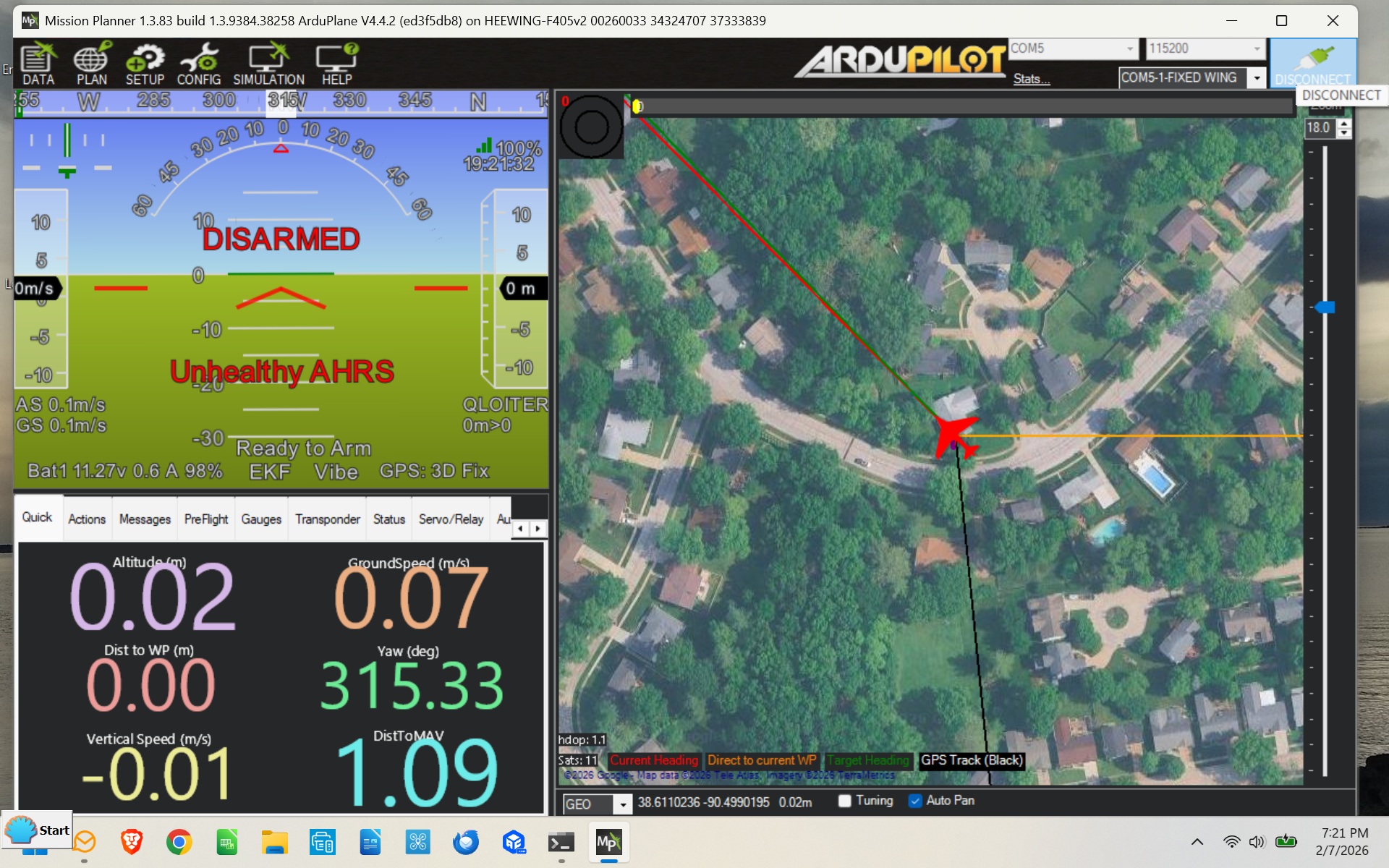

There are things that can be done to possibly revive the "bad" one. Has it ever connected to MissionPlanner, or always been a dud? Do you hear the windows device detected sound when plugging in the USB port?
tomlogan1
Initially, it connected to Mission Planner, showed a GPS image of my neighborhood and spun the props. Now Windows does not recognize it nor does the USB connection emit any sound. I have used 4 computers (3 Windows 11 and 1 Ubuntu) and have the same results, so I believe the controller itself or the instance of Ardupilot somehow got corrupted. I followed an number of Youtube videos on how to unbrick a flight controller but since these is no "button" on this controller none of those remedies helped. If you have an idea on other avenues to take I would welcome the guidance, but since neither Windows or Linux could not connect I have no idea on how to proceed.
There may be boot pads on the main board that could be shorted together at power up to enter DFU mode. Usually there is a way to do that even if they did not include a button. Would have to remove the case from the board to find them.
tomlogan1
The first version of the board does not come a correct Ardupilot bootloader (it may at some future point) so it cannot be upgraded with new versions of Ardupilot firmware. ANd cecause it has not boot pin exposed, DFU loading is not possible.
Instead a “transitional” firmware can be used and loaded like normal ArduPilot firmware (this is rev 4.3.7 Plane firmware) as a custom firmware file in Mission Planner.
This firmware contains the correct bootloader and it can be installed using the Mission Planner: SETUP->Install firmware “Bootloader Update” button after this firmware is loaded. From then on you can load any ArduPilot future firmware versions you desire, normally.

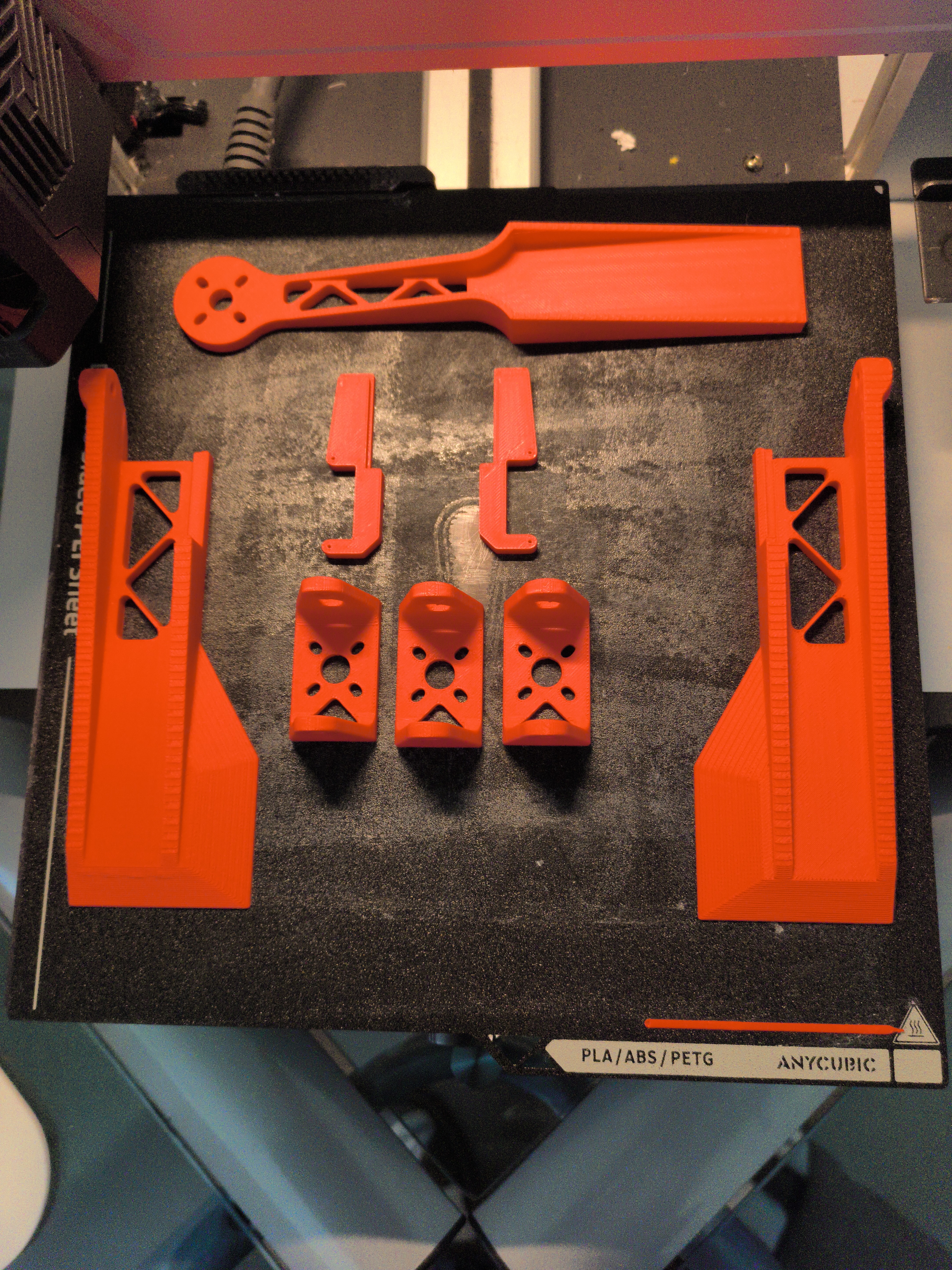

As the project begins to mature I'm thinking of (not an original thought) using the Mellenium Flerkin as air frame and have ordered an updated power system. 3d printed the motor mounts just this morning.
FlyerInStyle
I made a boomin flerken VTOL, but have since disassembled it. there are two things to keep in mind. Put a really strong carbon spar in the wing before assembly. the Flerken center section likes to fold on itself, the reason why I disassembled mine and will be building a dedicated VTOL. Secondly, choose some low KV motors, but move the motor mounts further outward, with larger props. the small 5" Flerken props did not serve well for battery life with the aircraft blocking about half of the area. It worked. not terribly well. I was happy with it, but will try a dedicated VTOL and see what I can do. Otherwise, its a straight forward and easy project, and I did not even really have to tune. the auto tune in INAV did its job. It also is unstable lower than 2 ft to the ground, so get it above that and it will hover fine.
