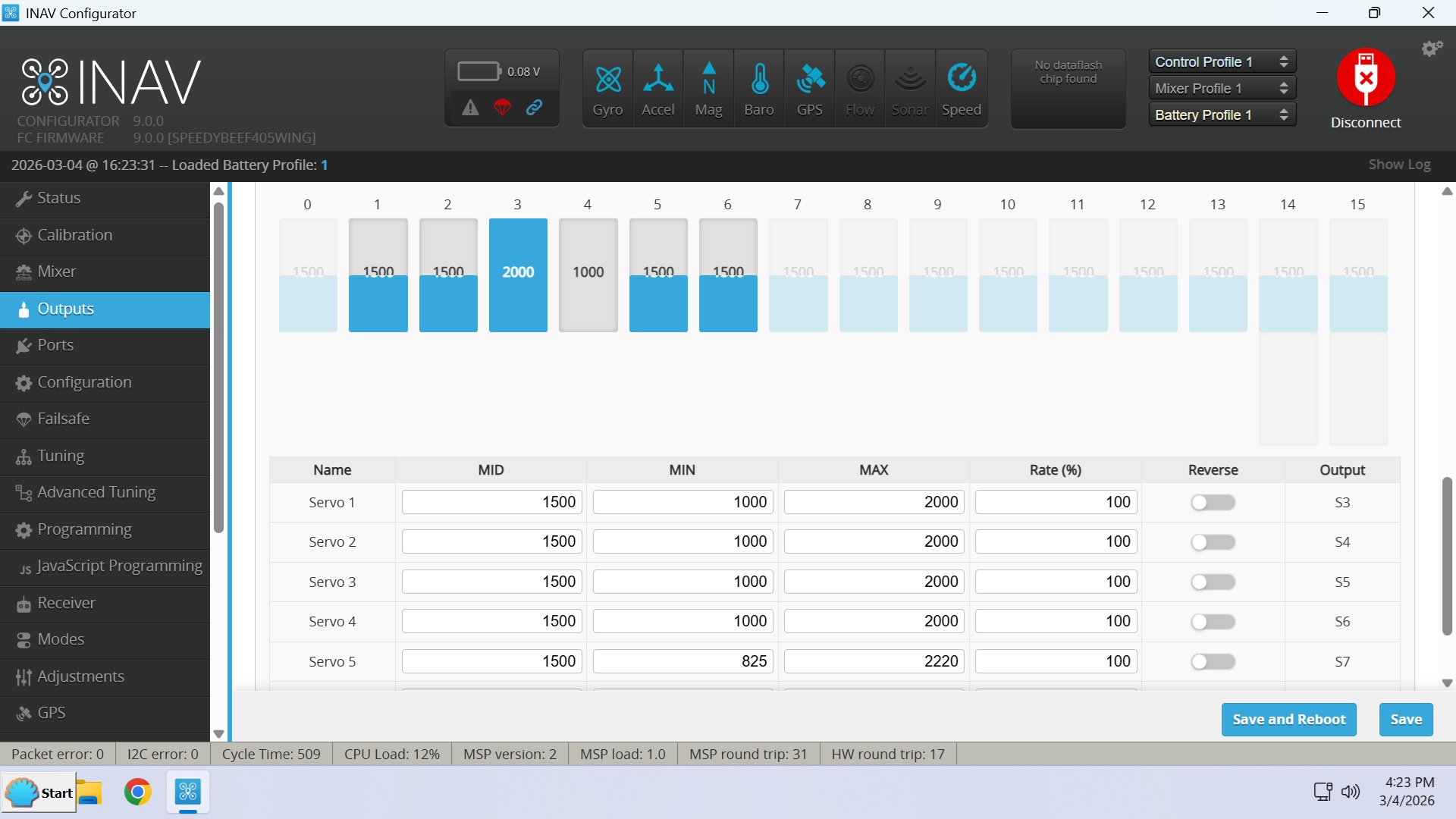

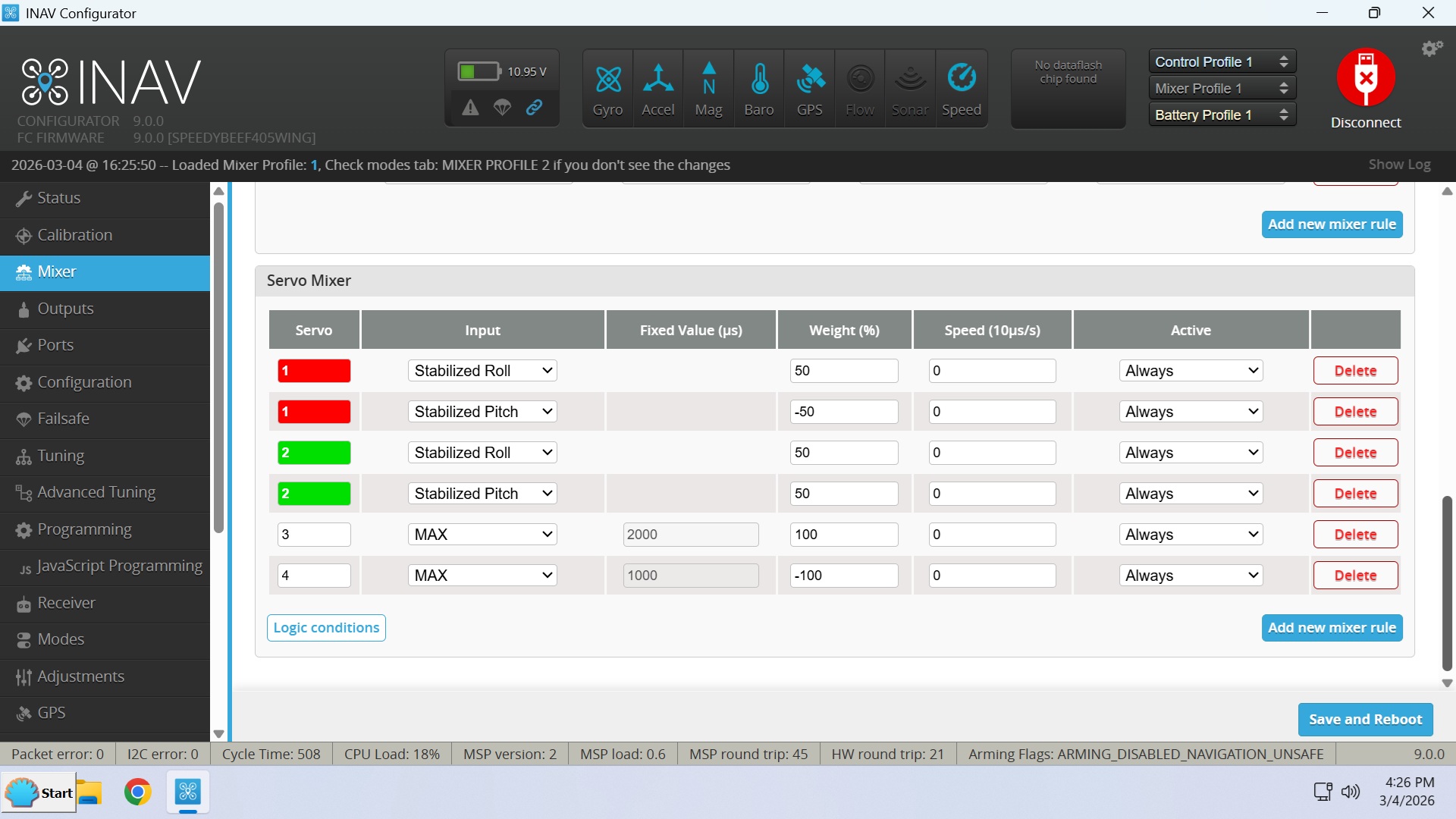

Guidance requested:
The Max (tilt) servos will only lift the motors 45 decrees. I have this on a 3 position switch but all I get is either straight or forty-five degrees up? What am I doing incorrectly? Servos 4&5 on the output page represent the tilt servos.
Thanks.

I would imagine that the flight mode you select could limit the travel. Does tilting the plane in various directions have any impact? I may have to throw INAV on a misc FC to play with it and see what results I get. Been a while since I set up a plane with INAV without copying the servo setup.
I tested and centered my servos with a dumb servo tester before mounting them up so I know 1000,1500,2000 is roughly 0,45,90 with fine tuning to be done with the FC.

What guide are you using to configure INAV?
Have you looked at this?
tomlogan1
Watched a couple of Andrew Newton's videos, but not as comprehensive as this. Hope this resolves that issue. Most everything else seems to be falling into place.
Thanks, good find.
tomlogan1
Moving at the speed of a tortoise, I continue the project. Tilt servos actually move to the position assigned on the switch. Both are (eyeball measured) at the same positions vertically, horizontally and at a 45 degree angle for transition. It's been so rainy & cloudy, the GPS refuses to unlock the throttle. I did, for just a moment, apply a "hack" that allows you to arm without GPS. Done with props off and removed after checking. Hope to resume airframe build this week or early next. Sometimes life gets in the way of playing :confused:.

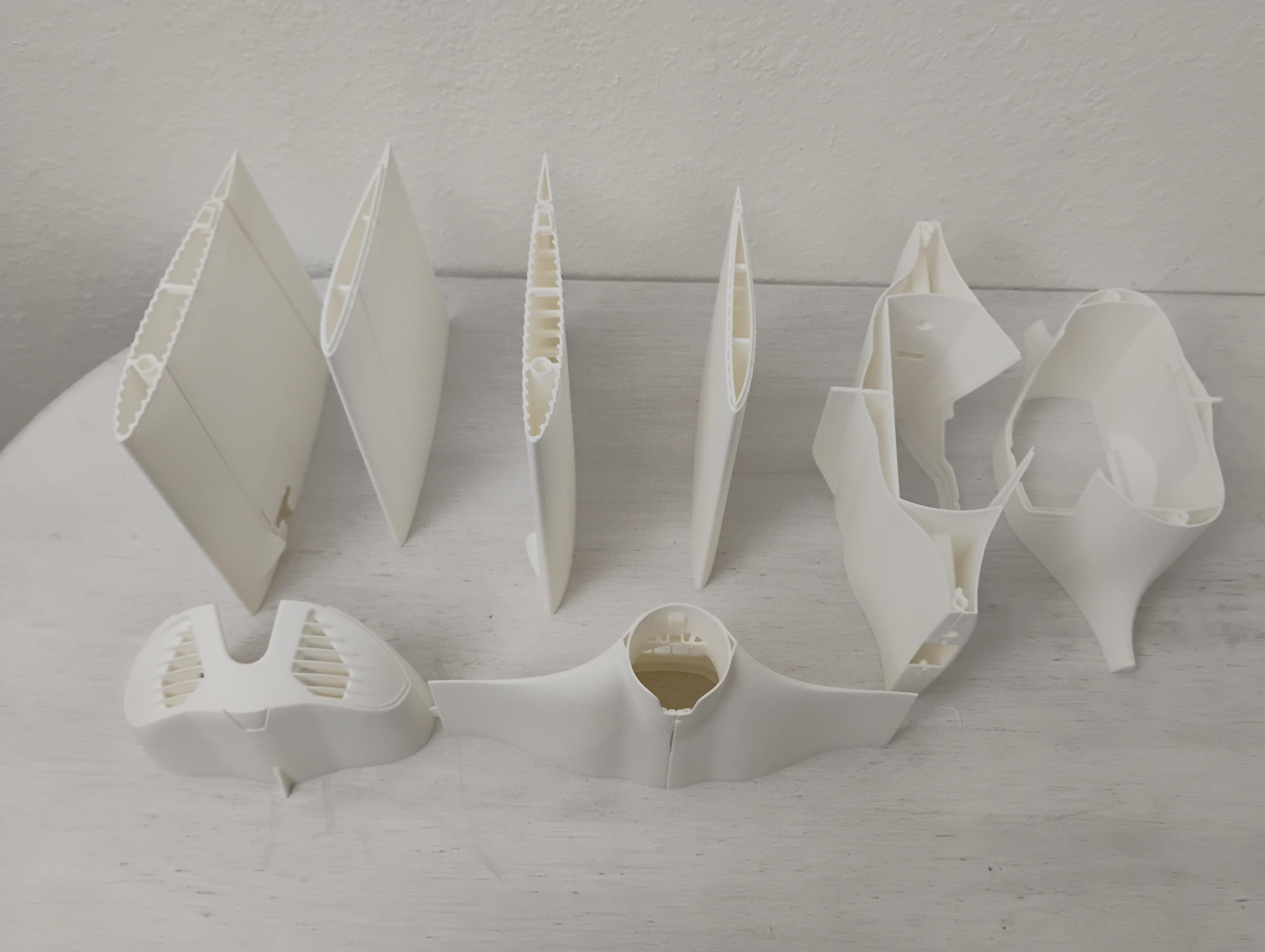

Getting serious about finishing the VTOL. A few more pieces to print and then onto assembley, documentation and, hopefully, maiden flight
tomlogan1
@tomlogan1 which model is that?
Orca V2 is eol. If you purchase the Orca V3 and ask they will give you access to download the plans for the V2. You can also buy the models already printed, ready to assemble, but what's the fun in that. This, I hope, will fly well. If not, I can rebuild it as a pusher, its original design. With a 3s and 30 amp esc it appears to be a wickedly fast plane. Thingiverse has plans to make it a VTOL, but, of course, I'm using plans meant for another plane..
