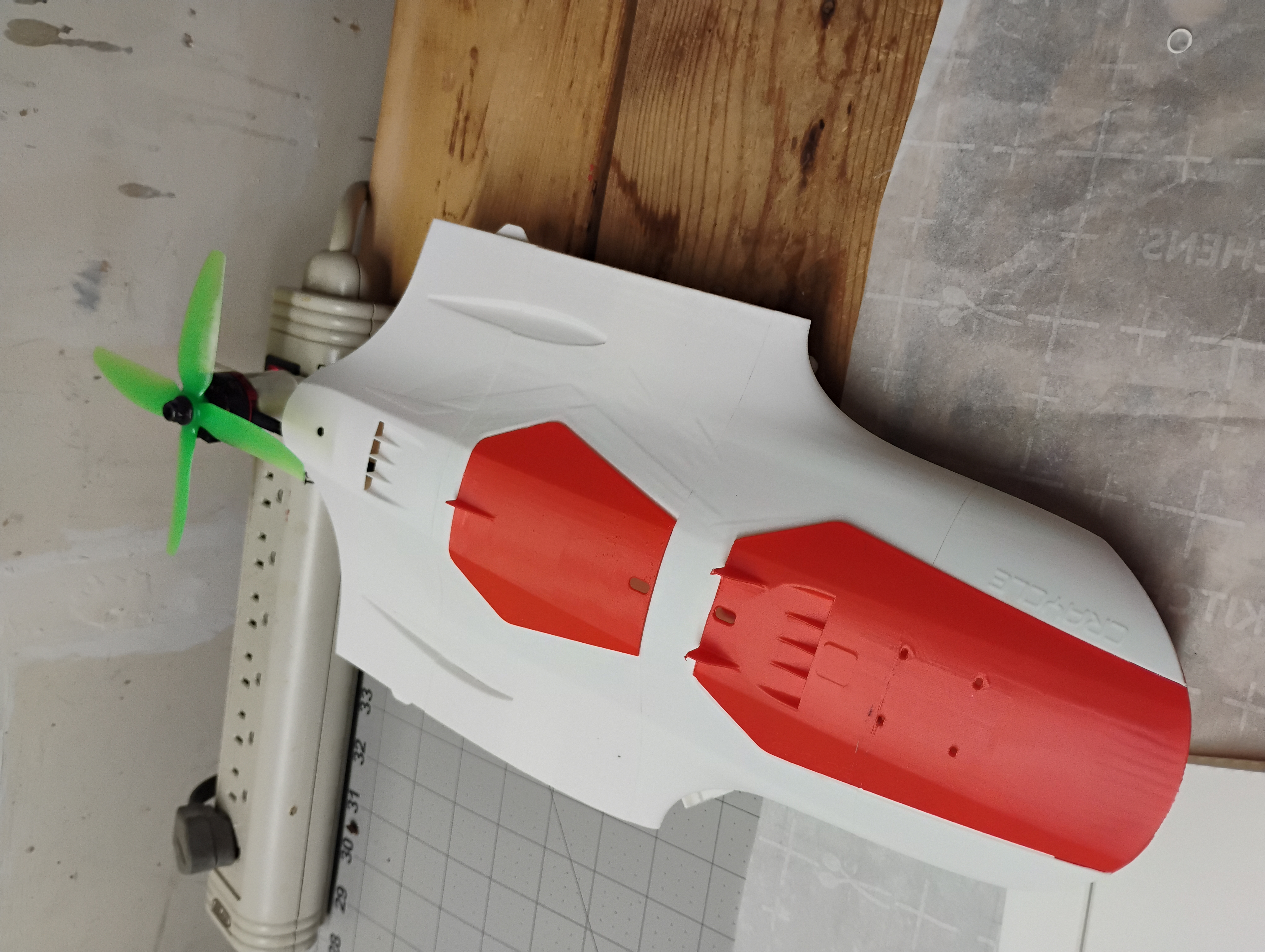

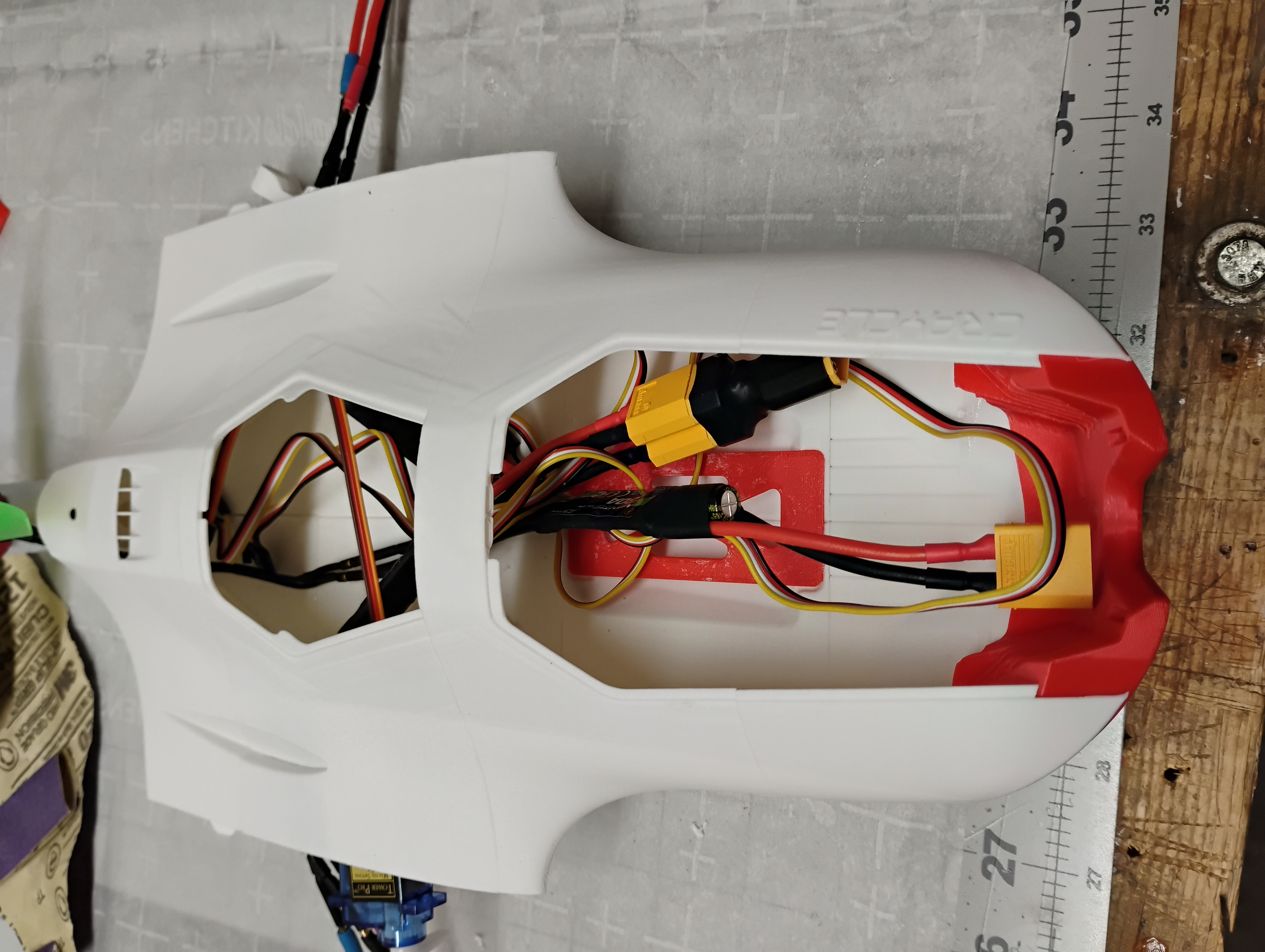

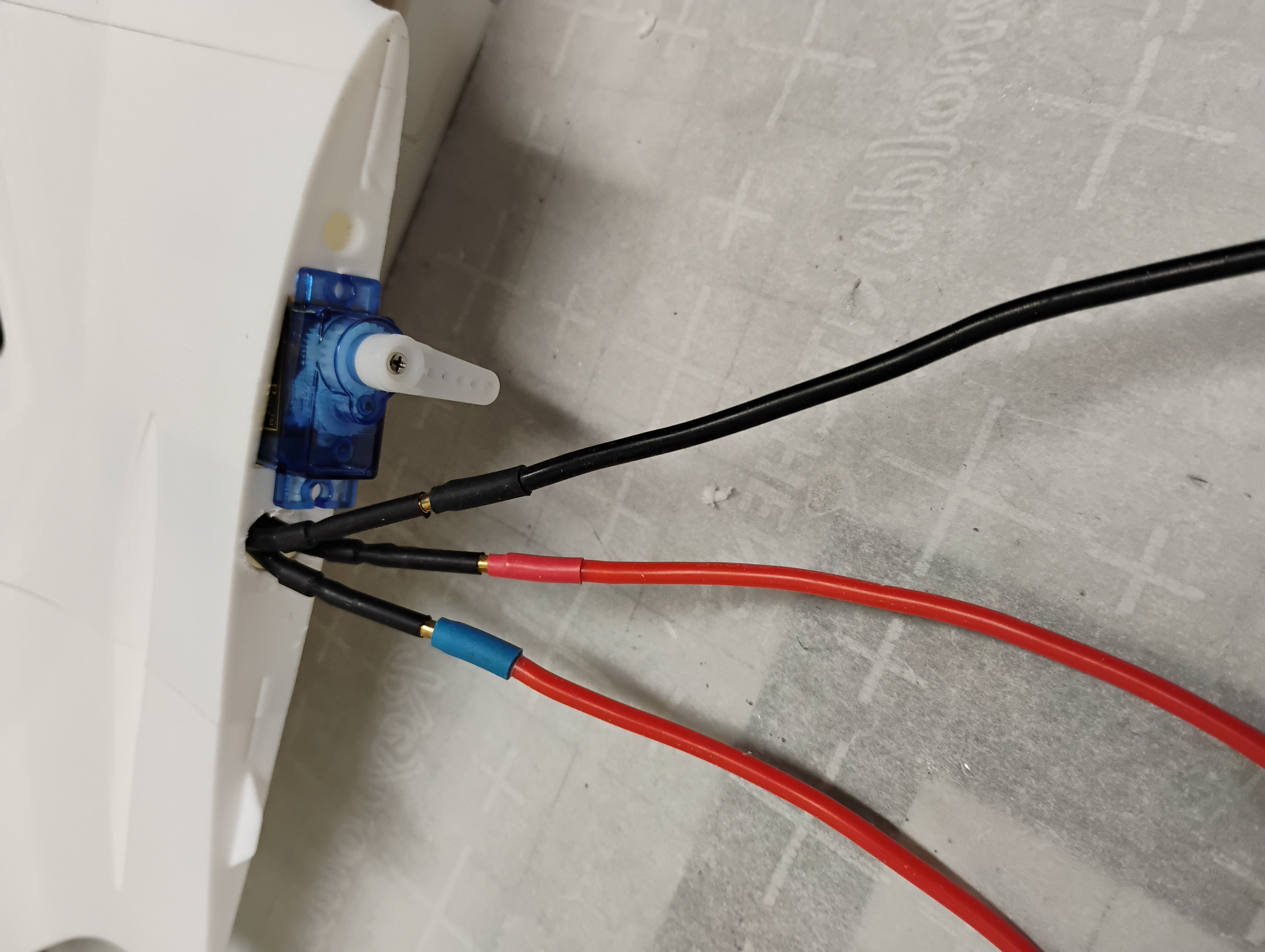

It's an exercise to take someone's proven design and match it to the "what if i did" thought that plagues us who can't leave well enough alone.
How do you get power from the FC to the motors which were not designed to be on this plane? As they say in Texas: "Drill baby drill!"
Prelude to the "wiring closet". 3 more servos to be installed, too. :eek:

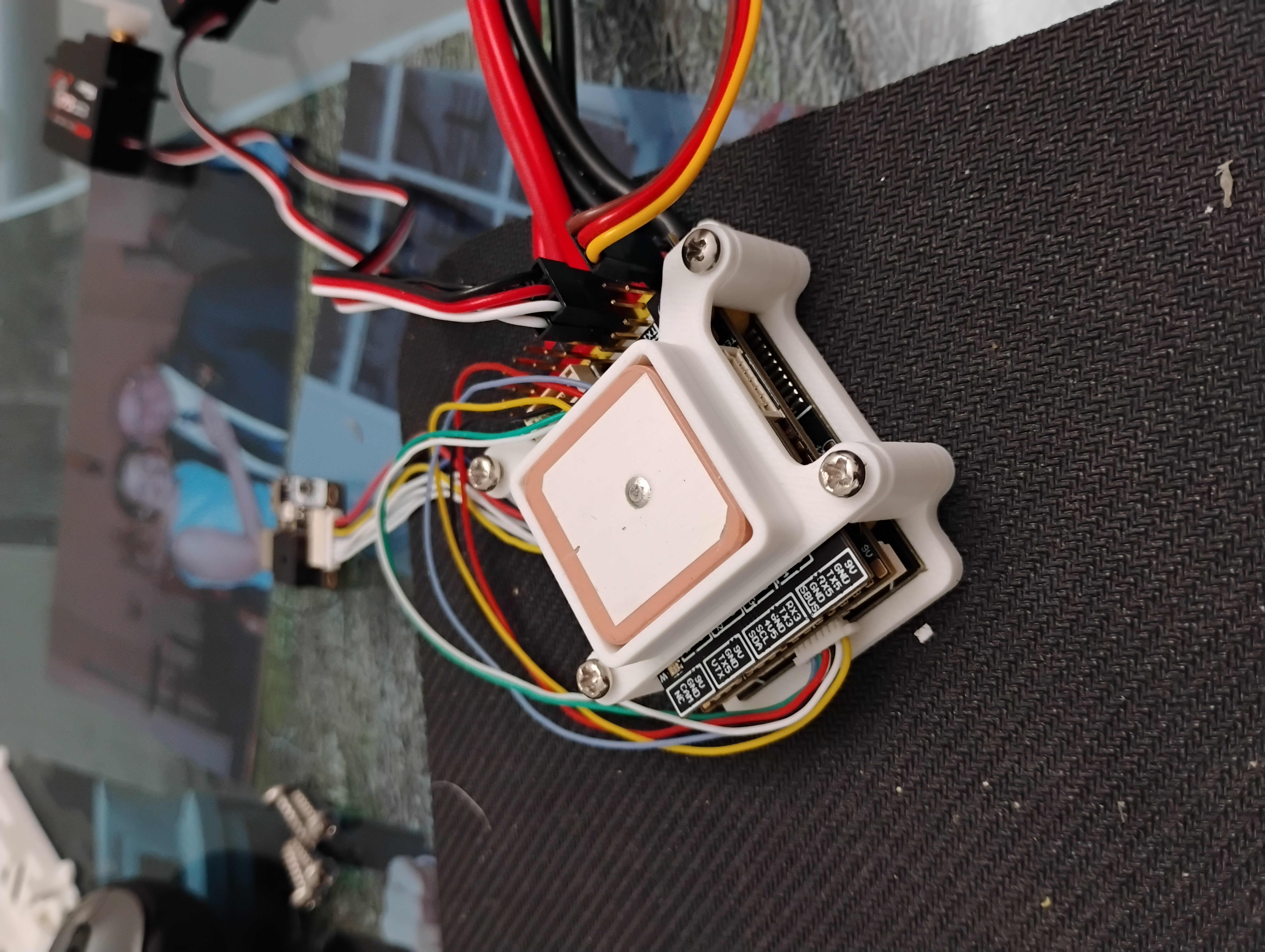

Making progress. All electronics check out. Airframe is complete. FC is programmed. Just need to shoehorn the FC into the fuse. Family health issue will delay maiden for many weeks, but overall we are in good shape.

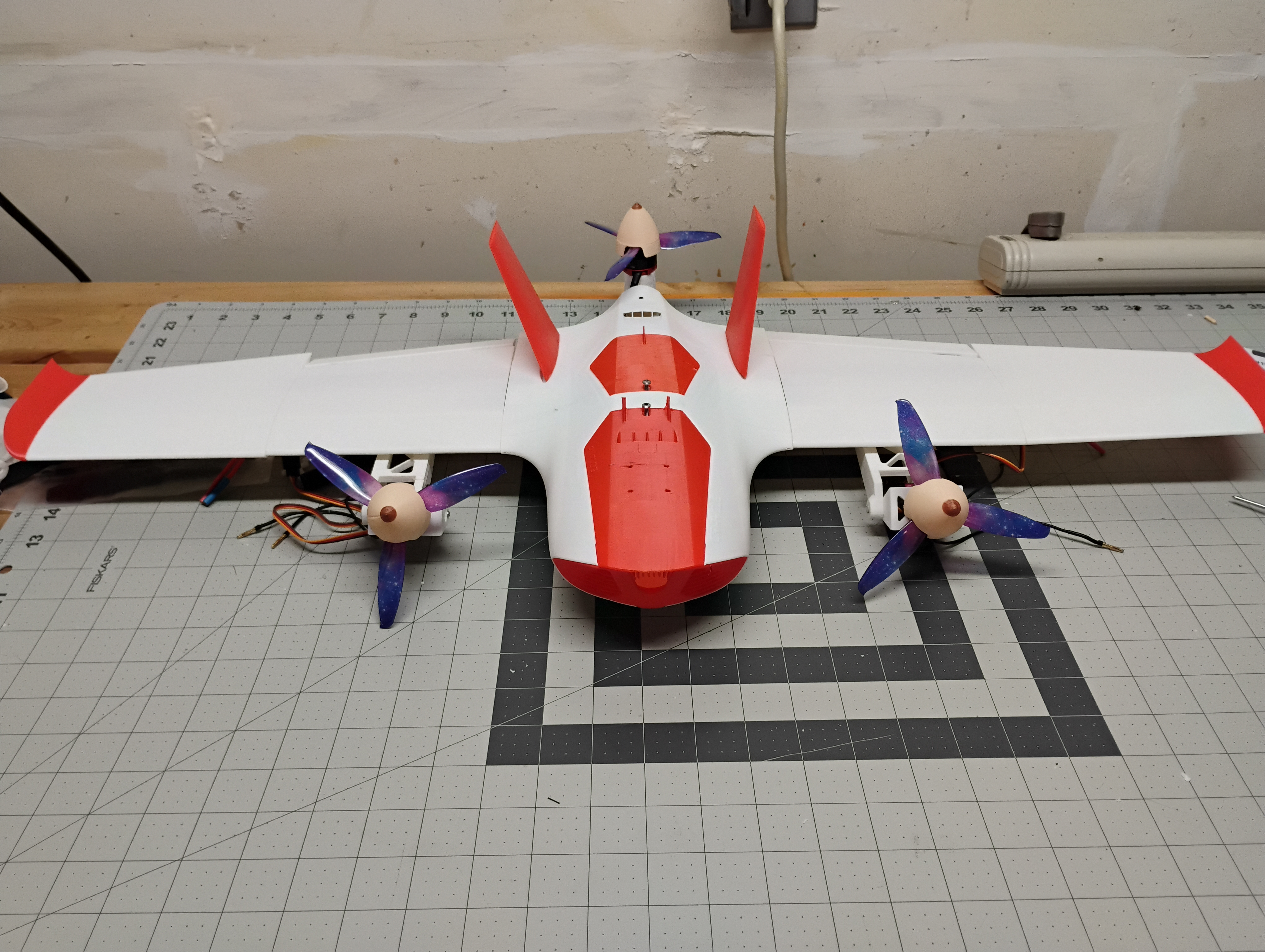

Pulled this one out again after adjust all the PID settings based on something AI gave me. Low and behold all of the excessive auto correction in VTOL mode was gone. Two cycles of VTOL to forward flight and successful landings. Finally time for some decals!
Timmy
What flight computer do you use?
