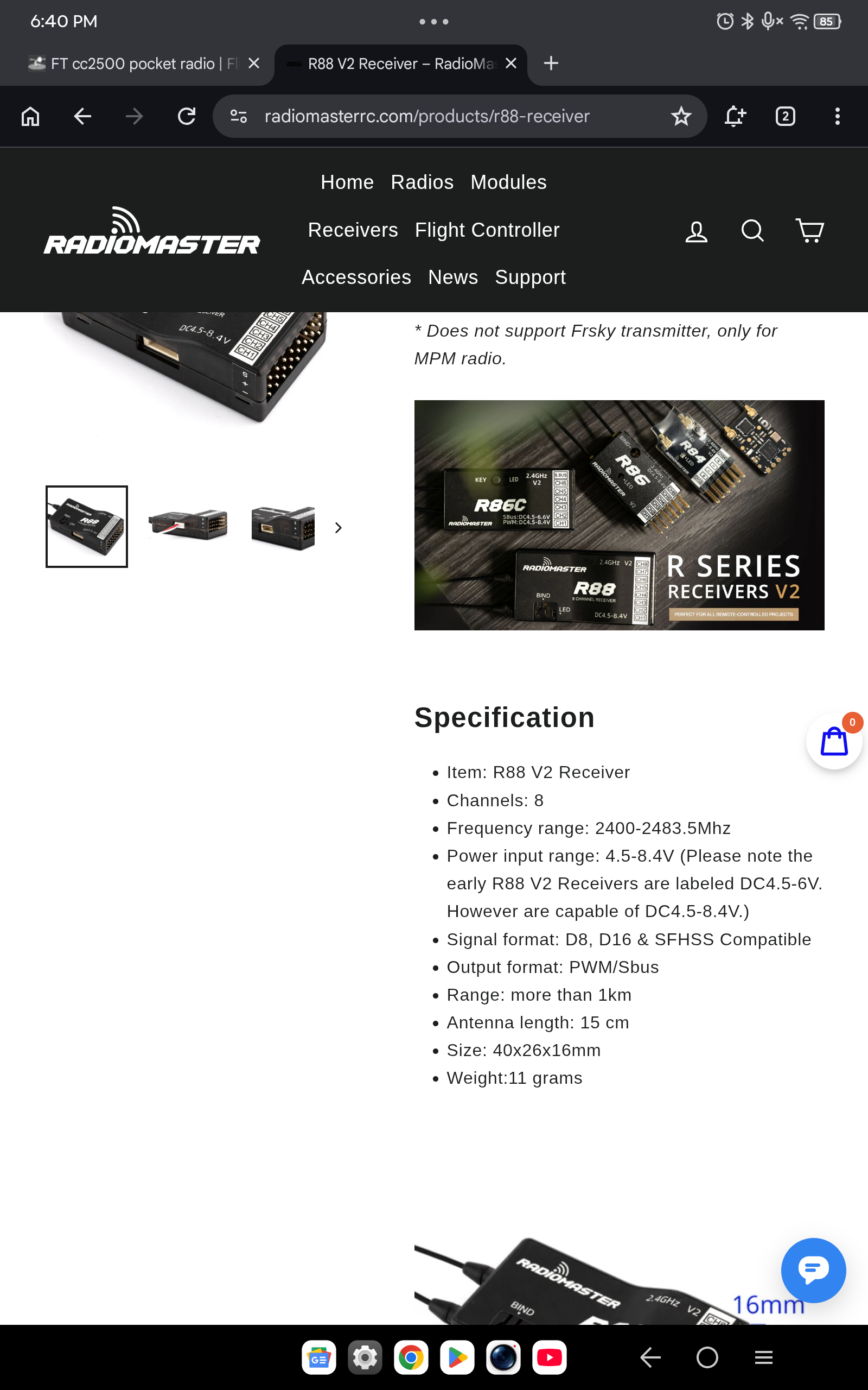

You will need a Futaba SFHSS or FrSky serial SBUS reciever to connect to the FT Aura. it is the function of the reciever to act as the serial port not the transmitter. Default flight mode channel is 5

Yes, you need to use the Sbus serial port as I indicated above. That is a function of the receiver, not the transmitter. The R88 can do Futaba or FrSky, doesn't matter which you use, but you must use the Sbus serial port connected to the Aura5.
You will need to assign a switch on the transmitter to Output on channel 5. The Aura defaults to the flight mode being on channel 5

You do not configure the protocol on the transmitter with the Pocket CC2500.
