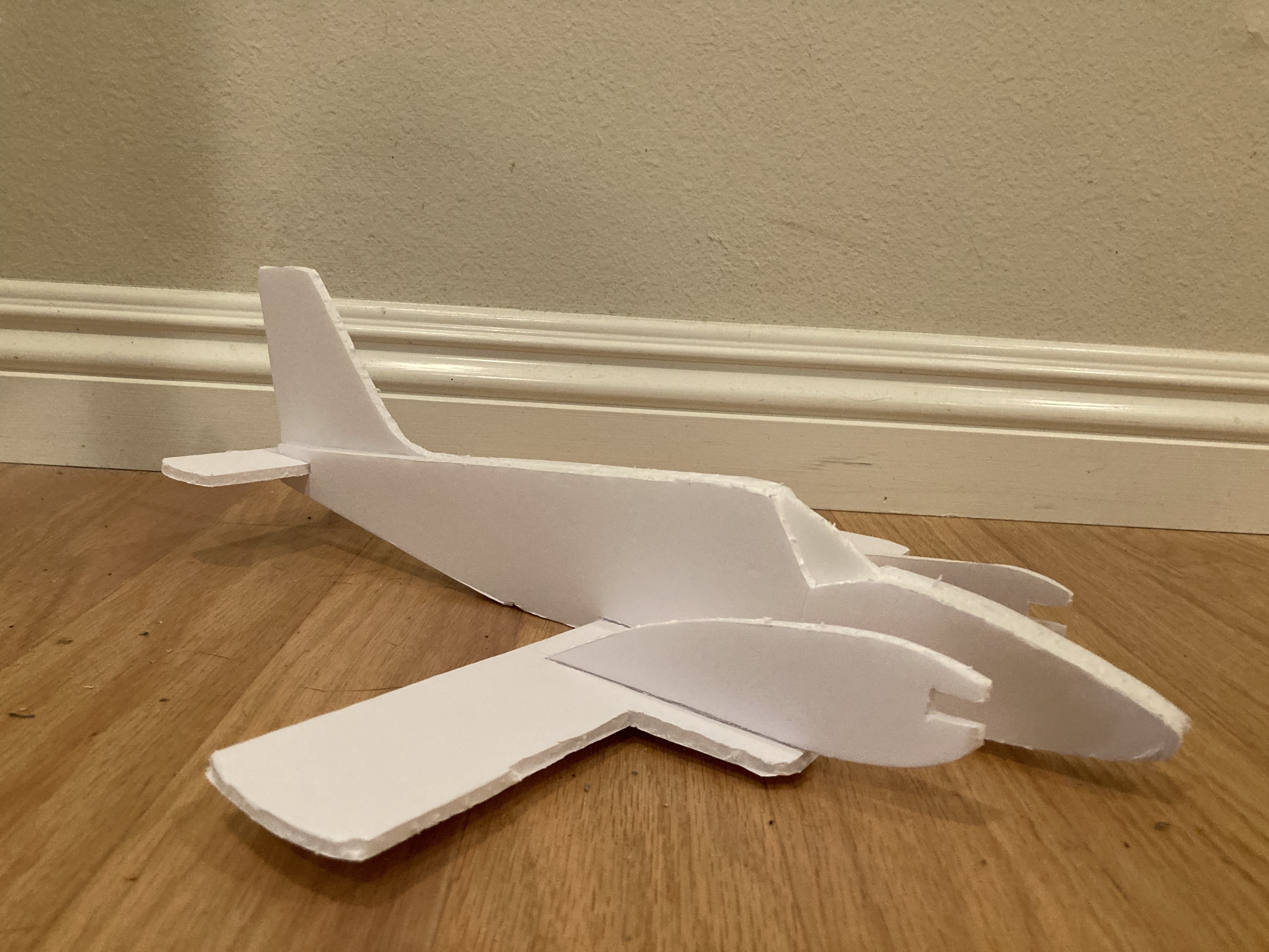

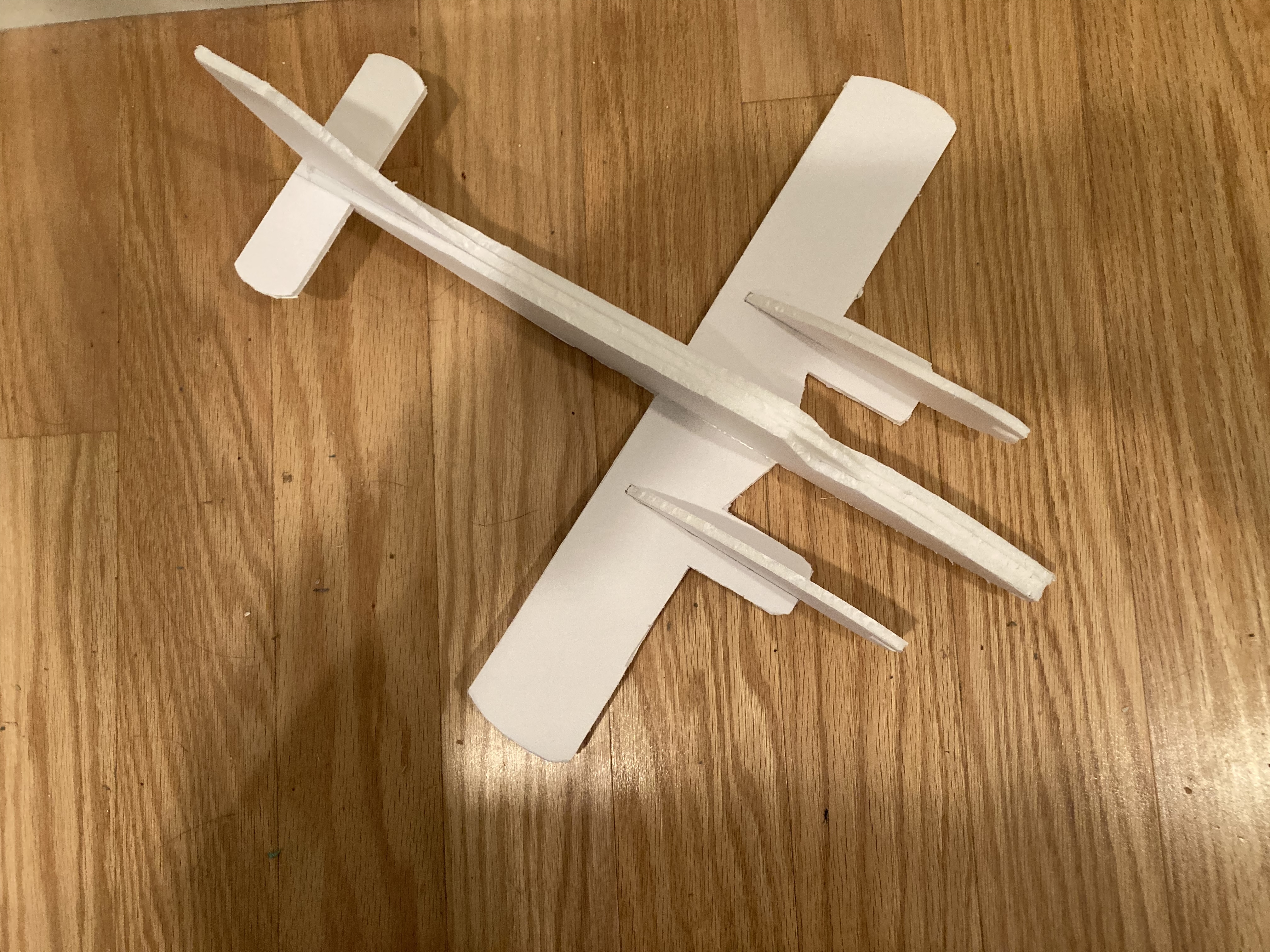

Two more to maiden in the morning: the EZ B58 Hustler, 15" WS AUW 51 grams, and the EZ ME163, 15.5" WS and AUW of 38 grams. I think the ME163 has the best chance. Don't know what the hustler is going to do with all that weight. If I can get it to fly then I'll give it a skin. 747s on the back burner till next week.

Meh. The 747 and ME163 were both dogs and I have abandoned any further testing as a waste of time. The Hustler flew fine in testing but I couldn't get the production version to fly for the life of me. As for plans, probably not. I would start over on them anyway, which, I'm not going to do. These guys have sucked up too much of my life as it is. To many other projects waiting in line. Sorry guys.

The ME 163 maybe needs some reflex at the wingtips, did you try that? ( As per the ez-Plank video) Also when I've made some free flight flying wings in the past they needed some upthrust on them to help lift the nose up when under power. Otherwise they make a bee-line for the ground nose first. On foam board just a little upwards twist of the motors should help.
Cg is also awkward on these, I recently found this good resource for it, hopefully it'll help https://rcplanes.online/cg_wing.htm
CG calculator Works fine for a Delta wing too.
