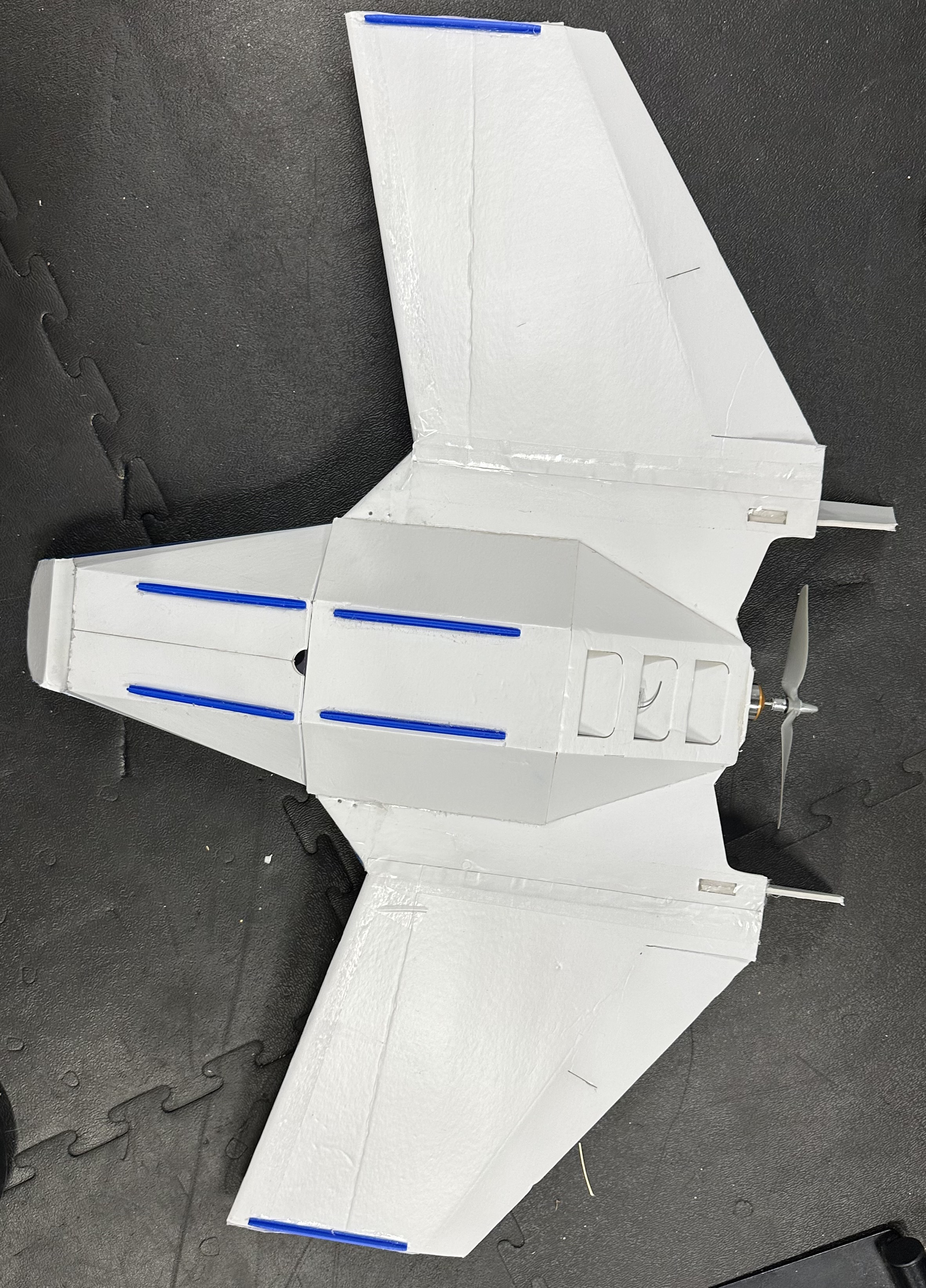

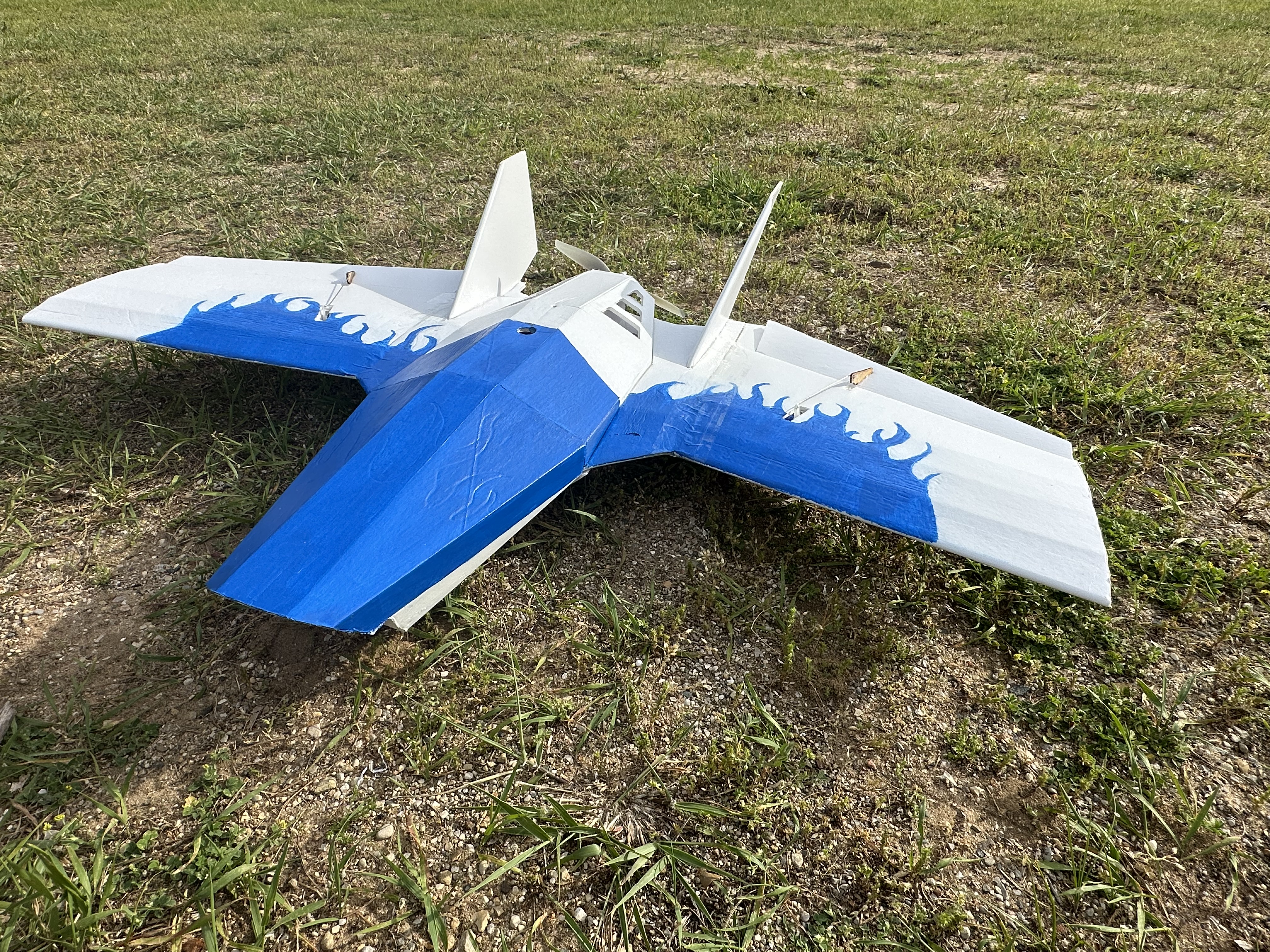

I got to maiden the Flerken last night and well I’ll just say it flew great, untill it didn’t…
I was running a 2212 2200kv motor, a 7x5 pusher prop, a 40A ESC (cheep from Amazon) and a 2200mAh LiPo battery.
I only have a video of the first minute which was mostly trimming it out and getting a feel for it and I loved what I felt,
It was fast and maneuverable but I could slow it down to a more manageable pace!
I did some loops and a few rolls, again no complaints there. But then out of the blue
Around 2 minutes into the flight the motor quit I said to my dad who was standing next to me “huh that’s weird I don’t have any throttle.” Apparently when I said it I sounded calm and in control but on the inside those where the last things I was feeling!

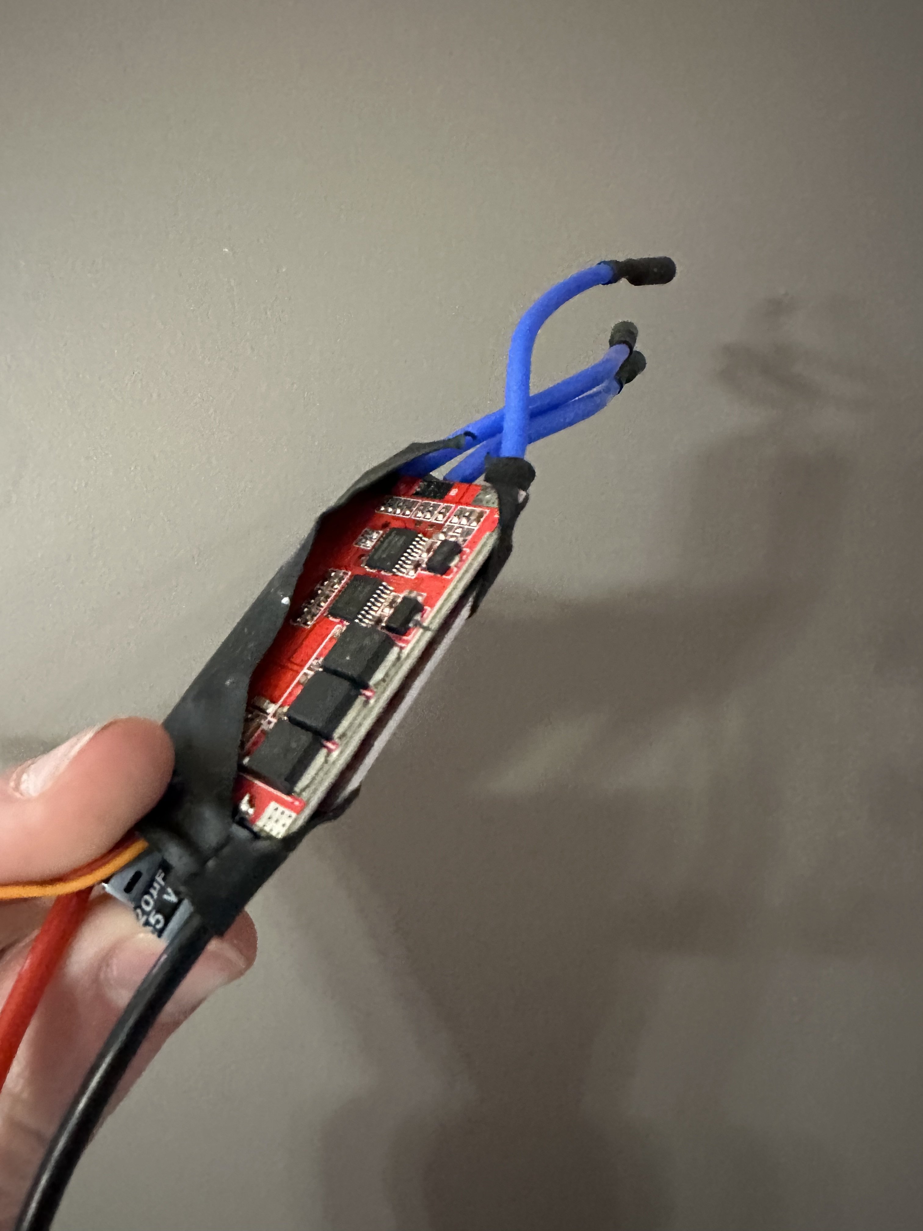

I was able to get it on the ground with just the landing skid falling off and opened the hatch to find a melted ESC luckily nothing else appears to be damaged

How many cells did you battery have?
Foamforce
7x5 is too much for that motor and ESC. When that happens, the amps go up and you either burn out the ESC or the motor. Sometimes both. I’m assuming you’re using a 3s battery. This advice is doubly so if you’re using 4s, and not applicable if you’re using 2s.
