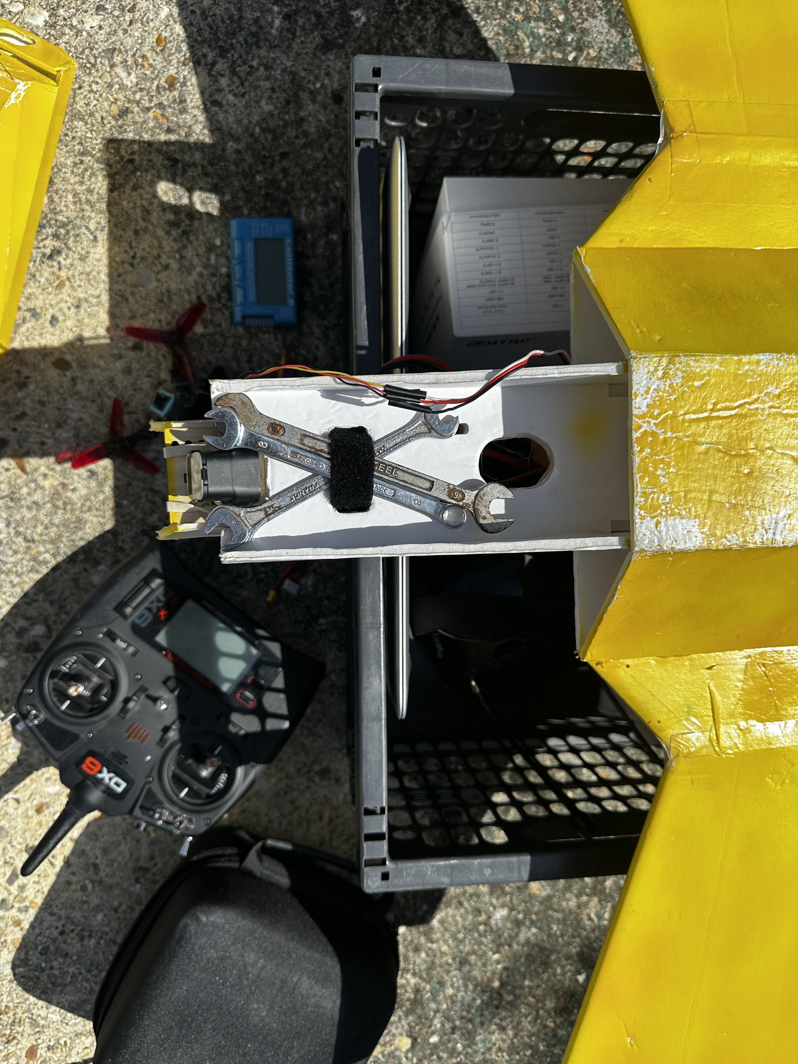

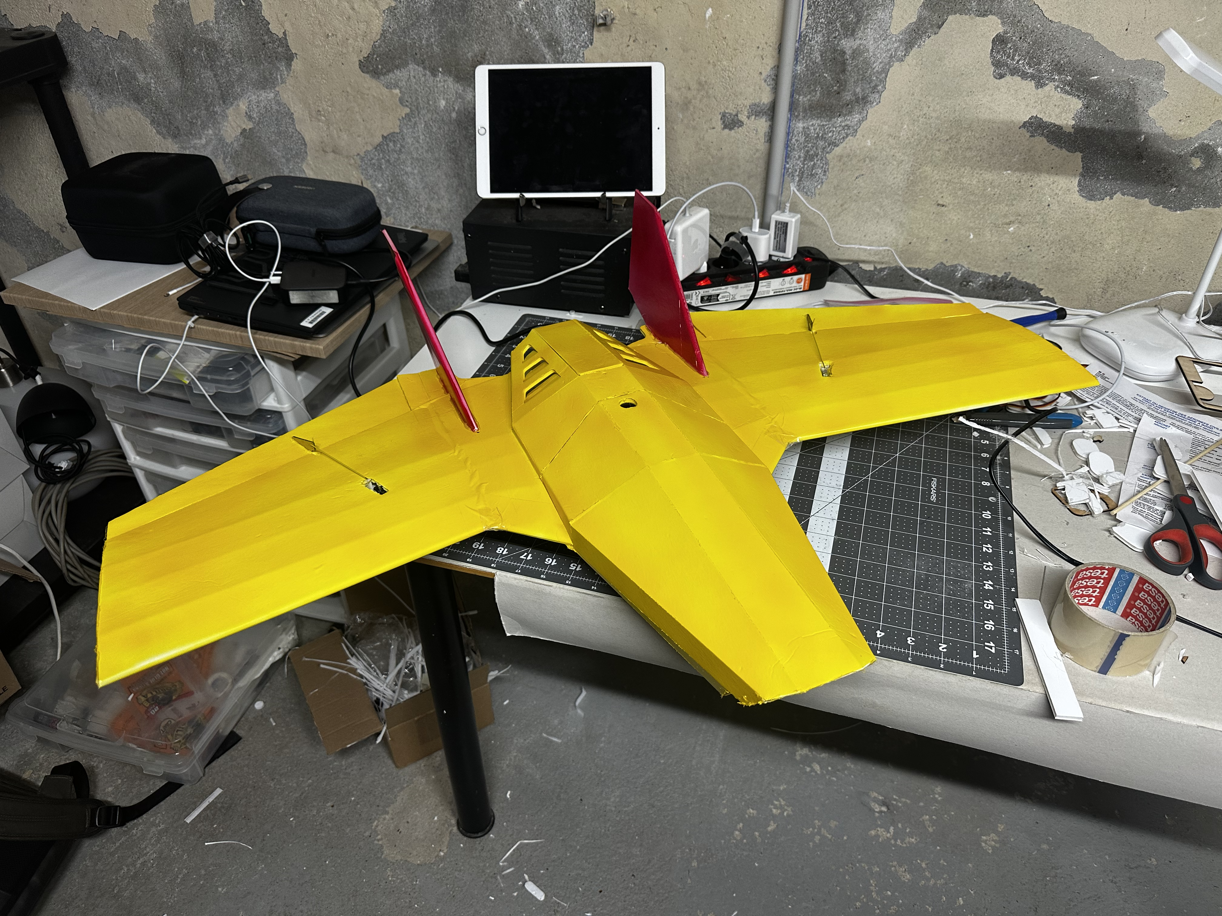

I completed my Flerken two weeks ago, it was a great building experience. I'm flying with a 2200mAh 3S battery and a RunCam Thumb 2. I hat to add quite a bit of weight to the nose (literally added a wrench) to get the center of gravity right, to the position indicated in the instructions. It's easy to hand launch and land and it flies relatively stable straight lines, but is really resisting turns. The turning radius is way bigger than, say, the much larger Mustang from the Master Series. I wonder if I can remove some of the weight from the nose to get a more manoeuvrable plane. But I'm worried of what they say: CG too far to the front makes an airplane fly badly, CG too far to the rear makes an airplane fly not at all. Any advice ?

Nice looking Flerkin. I didn't add any weights anywhere. My struggle came simply with battery placement. Using the COG that they recommended made it nose heavy and I crashed it twice. Then I started measuring cog from leading edge (just a guess) instead of center of those little triangle things by the wing and body and it came out fine using just my battery for weight adjustment. I'm sure it's just the way I build it. It's a really fun aircraft. A little much for me. I can fly it on acro for a bit, but without the Aura (panic button) I'm pretty sure it wouldn't survive me for the entire flight (yet). Have fun! Let us know how it goes.

Thanks for the advice! I guess I‘ll just gradually remove weight from the nose and see if it becomes better. I‘m flying without any active stabilization, just a simple receiver.

I tried again with less ballast in the nose but it was not a great experience.. it was not completely unstable but also much more nervous, often times the nose was pointing upwards much more than it was supposed to. I'll have to add in some more ballast again for the next flight I guess, to find the sweet spot. I was still able to land without major damage.

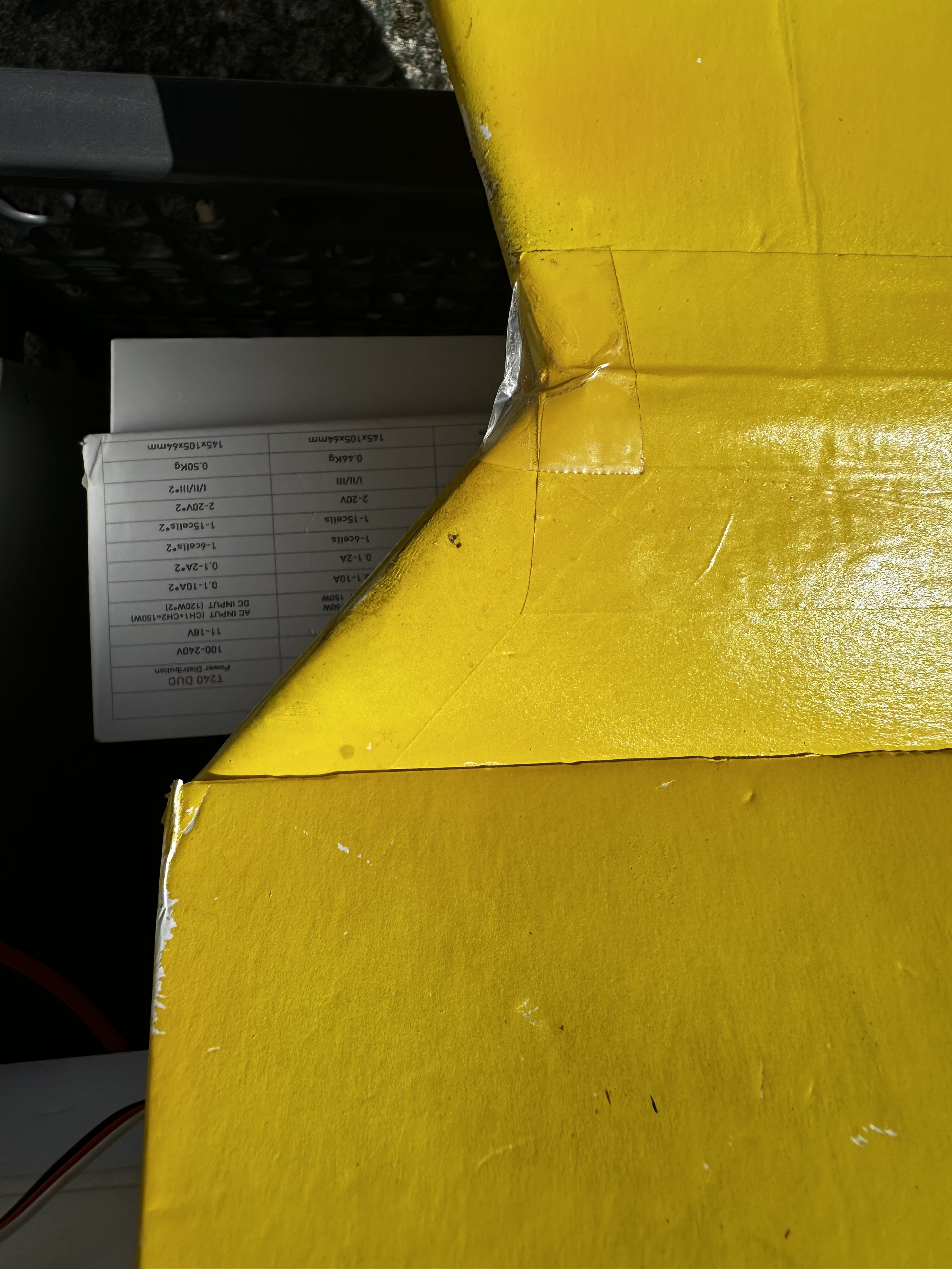

Great, congrats! In finally got my CG right, I think. Turns out the reason for the instability last time was a loose motor mount.. see attached where I marked my CG (blue dot on the small triangle part of the wing) and also my makeshift "ballast".. it is not stupid if it works ! I added some more footage showing the newfound agility.. with full throttle at least half of the time. It goes fast on barrel roll but is starting to struggle on the looping. This time, with more aggressive stabilization of the video.
View attachment 259753 View attachment 259754
Hey, if it works, it works! (I once used a handful of bolts when I put a big motor in the goblin 🤣). Congrats on getting it to fly!
