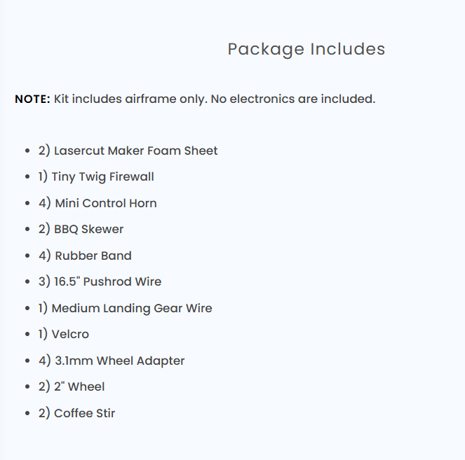

Next question, just started my build,I only got the basic kit. I have no "linkage stoppers." Was that something in one of the add ones or missing in my kit?
AIRFORGE
Make It Fly!
It appears they are not included in the kit.
Danjgug
Got mine fully built. Was missing the rubber bands but no big deal. Was very easy to build following the video. Anybody reading, buy the power pack and linkage stoppers. Maybe you'll save $5 piecing together your own power pack but it isn't worth it.

Just a couple more questions for anyone else who has built one:
1) If I get myself a RadioMaster/Flite Test CC2500 and I want to fly the Tiny Twig as a 4 channel airplane, will the R84 V2 receiver work out fine? If not, which receiver will I need?
2) Will I need to install the shelf for the FT Aura if I'm not planning on using one?
3) Which linkage stoppers will I need? Two different ones are listed in the store, although from the look of things it they may be the same part twice.

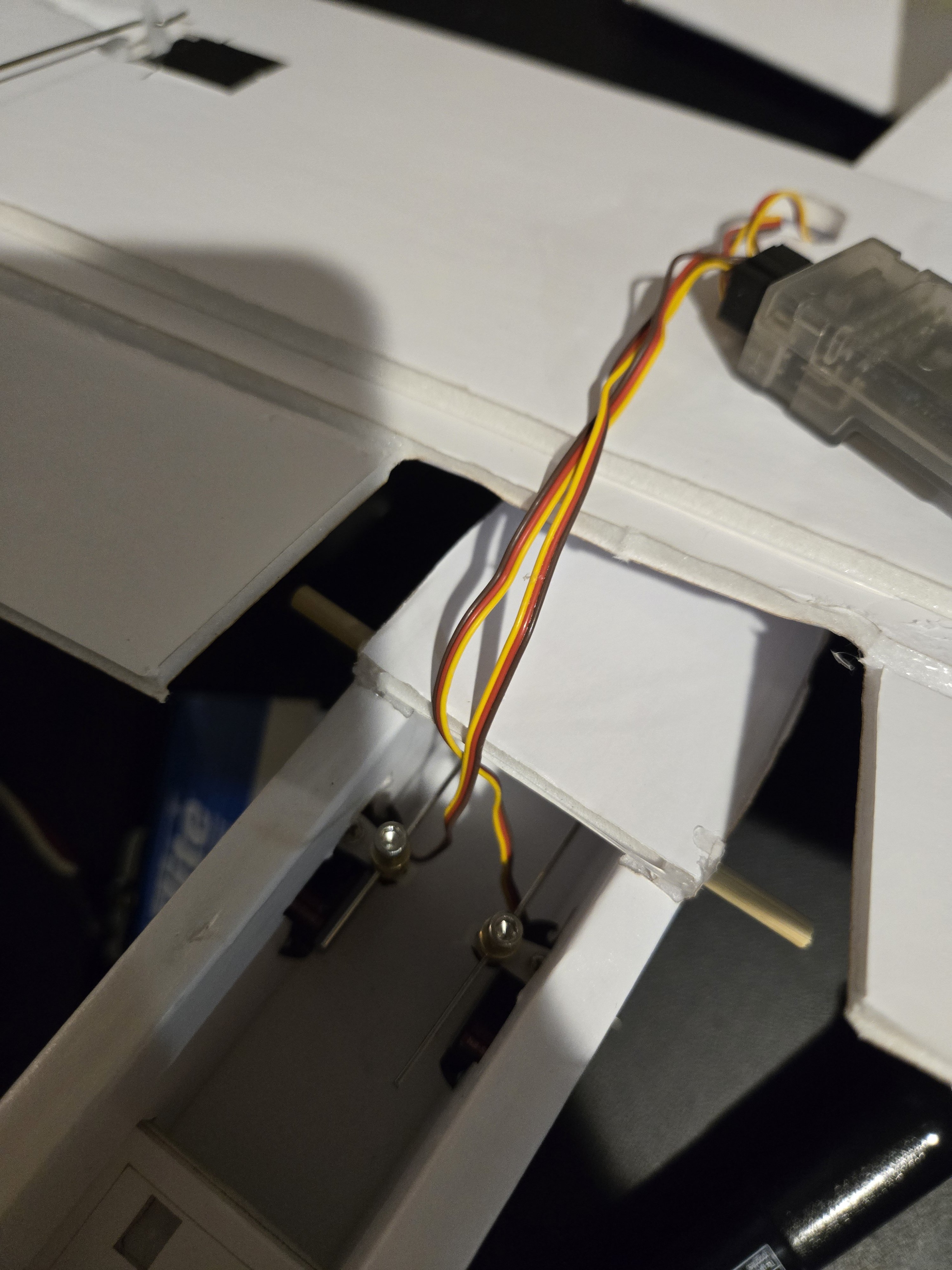

4) How do I tighten the screws on the linkage stoppers for the rudder and elevator once the fuselage is folded up?

I can't help with 1. For 2 I'm not using the aura but I installed it so I had a place to mount my esc and receiver.
I bought and had to slightly modify Dubro linkage stoppers to work. I would buy whatever may be smaller in the ft store.
You'll be able to access the linkage stoppers to center and tighten them once it's folded.
Two things I did learn when building it are make sure all the foam is removed where it tells you to remove it or the fold won't be square. And make sure your wing servos are in the correct spot before glueing them in. I had mine switched and had to cut the wing a bit ago I could access the servo horn and screw.
