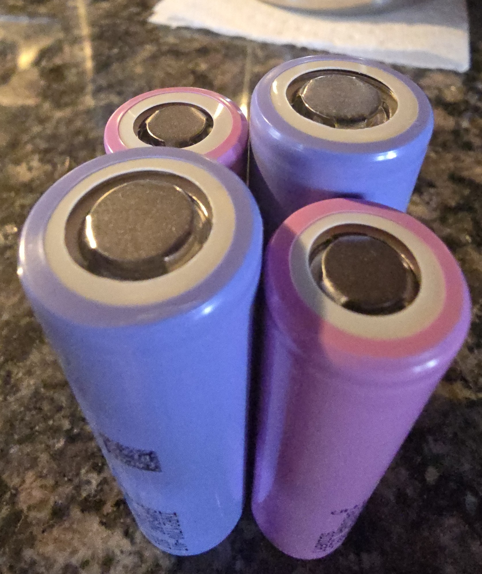

OK. I was basing it on size not weight. I will compare a few of my cells.
2x18650 96g
2x21700 137g
these weights are for the raw cells, not built packs

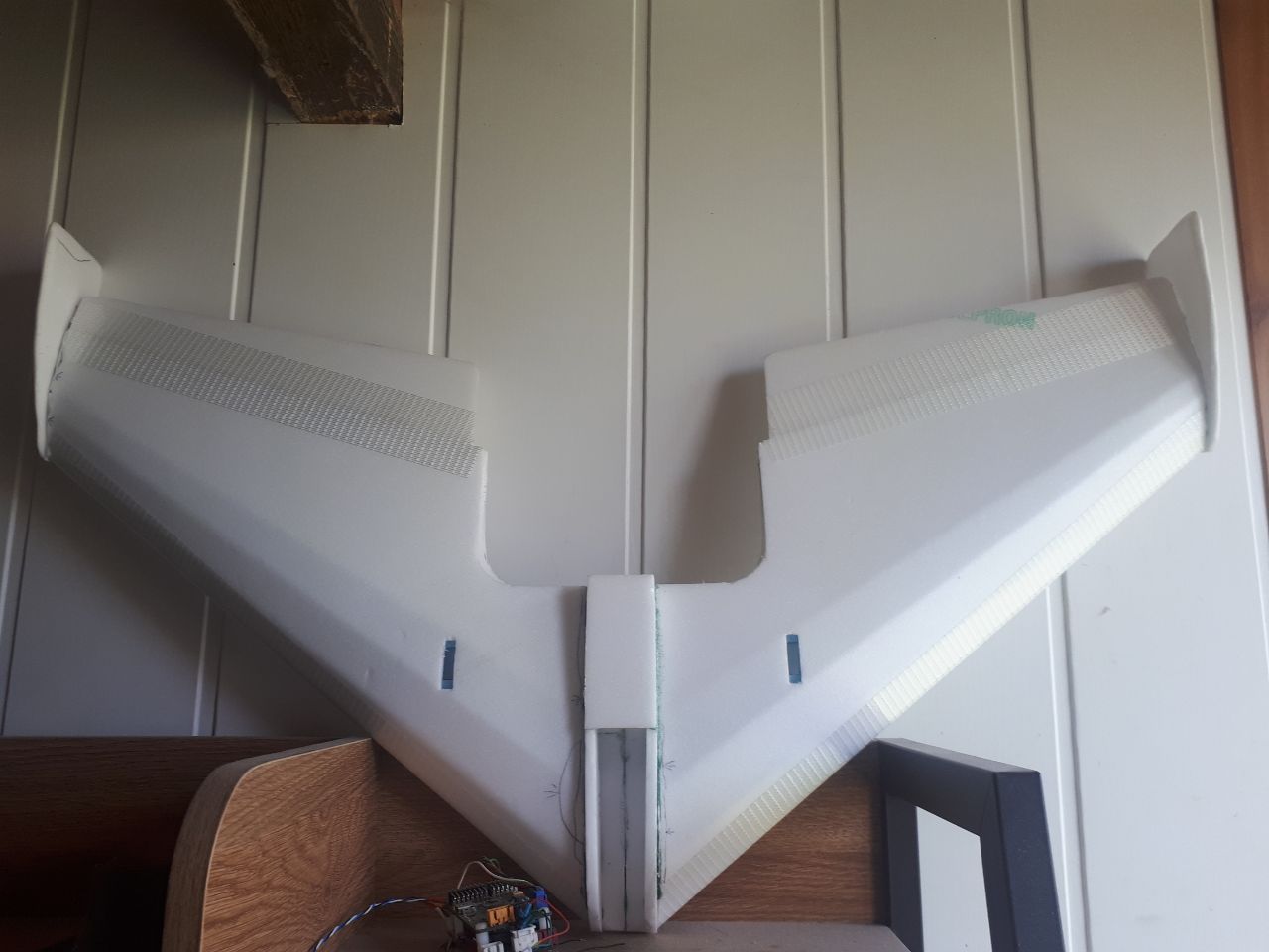

I built it out of 6mm Depron. It's empty so far. It weighs 99 grams. I estimate that with an 1806 motor and 3S 850mAh, it would weigh around 250 grams. If I didn't use hot glue, but a decent one like cyanoacrylate or Uhu-por, and made it out of 3mm foam, I think I could shave off another 50 grams. But that wasn't my goal.

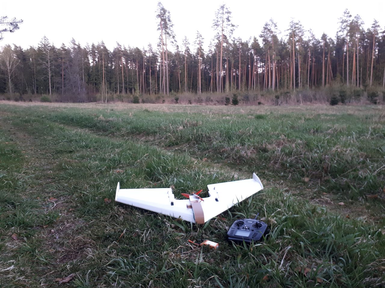

Today was the maiden flight of the Arrow. The elevon reflex was set according to the template, but it was necessary to trim the elevons up a couple more degrees for level flught. There was a slight wind, and the wing is very sensitive to it, flapping around a lot. The entire plane weighs about 260 grams. The motor is an 1806, so it seems a more powerful motor would be helpful.
On the plus side, it's very maneuverable and responsive. The rates need to be cut.
Overall, I think it'll be fun to fly in calm weather, but I expected it to be more stable in windy conditions.
