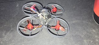

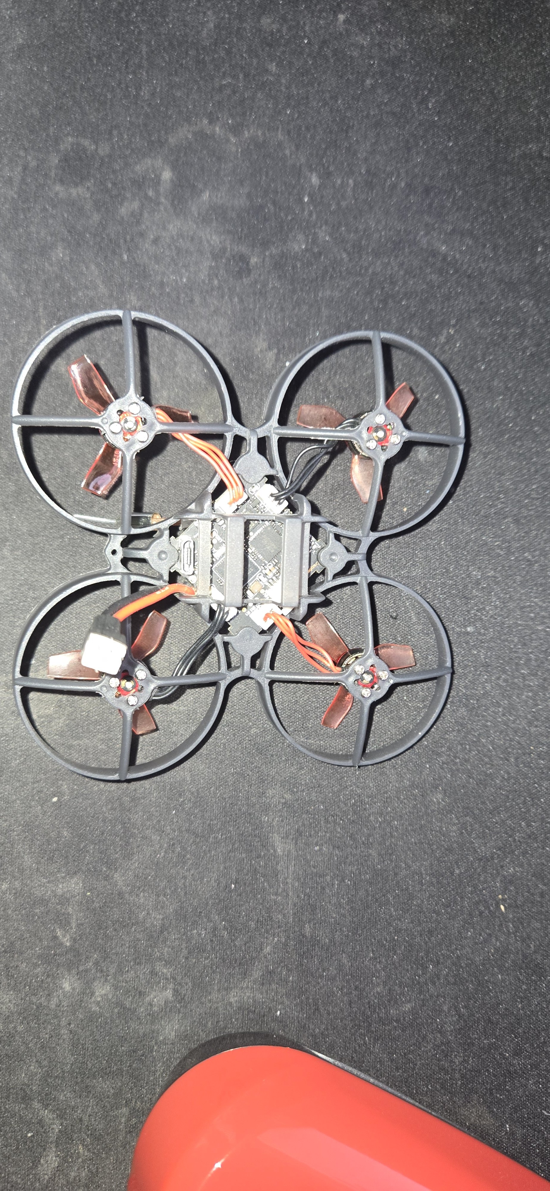

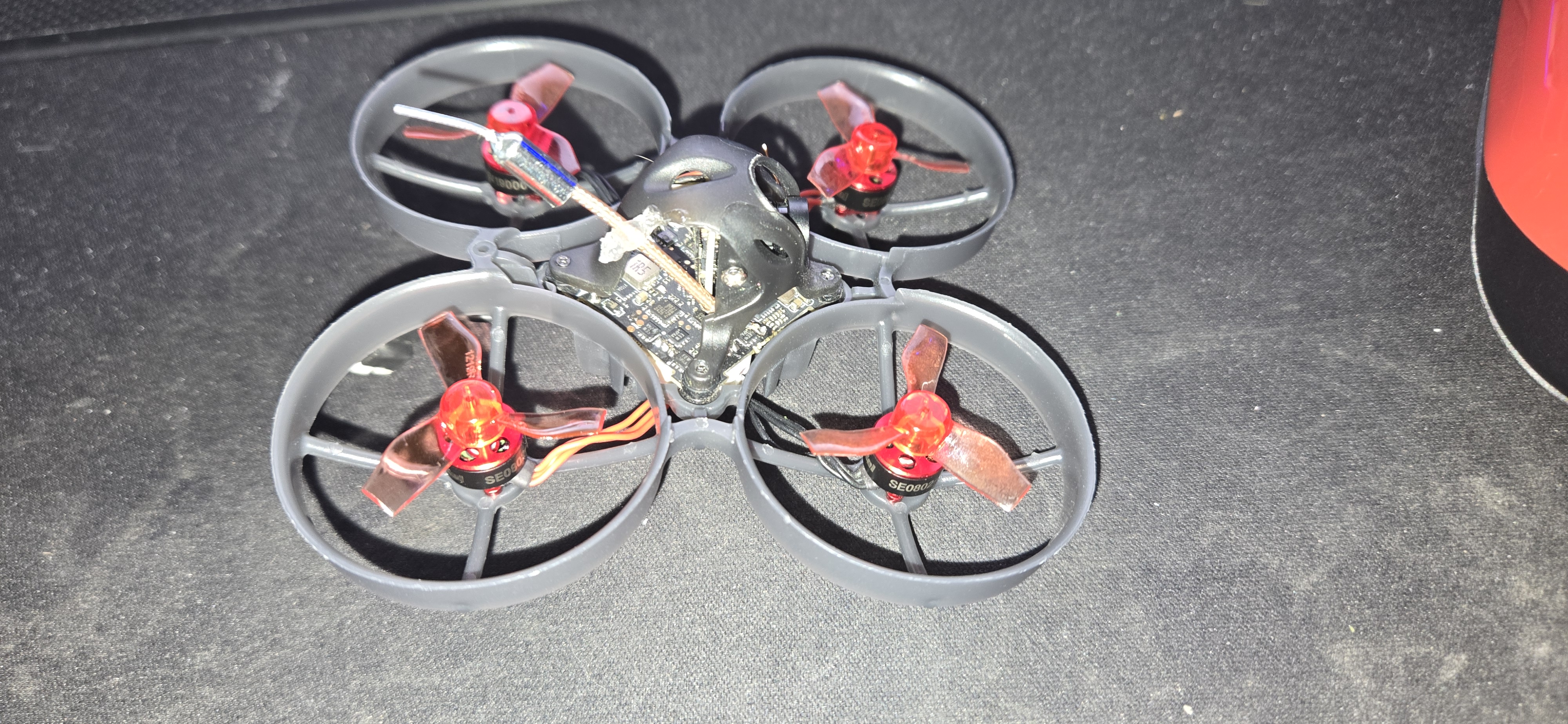

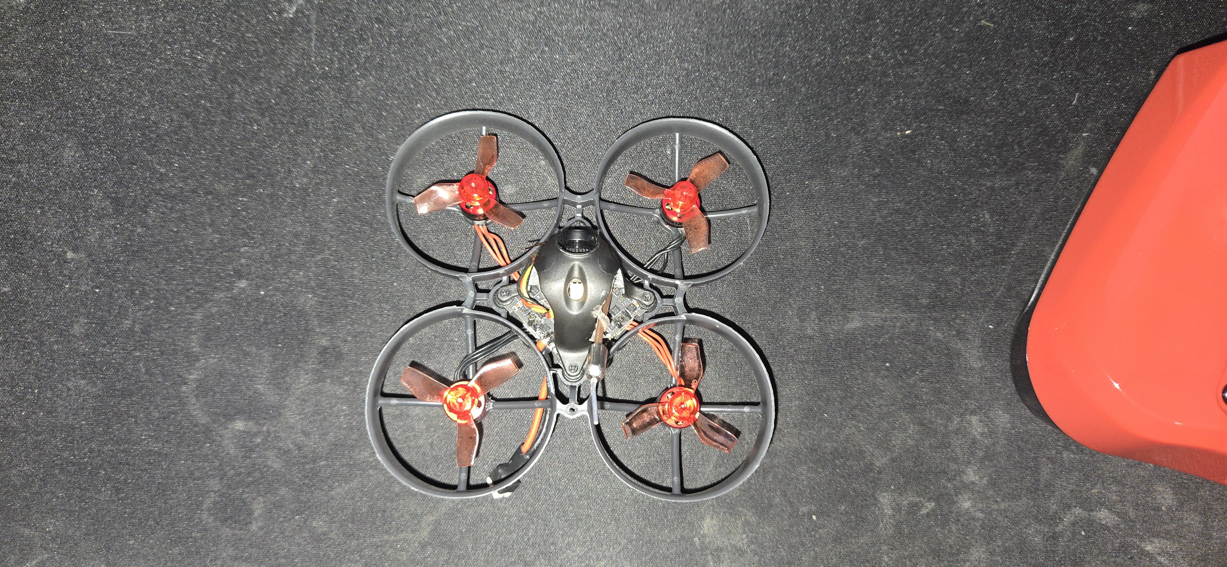

Im getting back into FPV drone.
I bought the kit FT Mobula 6 with everything.
Upgraded the Frame to Modula 7 for a bigger battery. Flew great for one week. Flight time about 4:20 Min.
One of the motor locked up last week, New motor came in from FT on-line.
Put the new motor in. Now I have problem. The drone take off and spin around until I turn the motor off.
Connected to Beatflight. Check the motor wiring.
Im not sure what to do now.
Prop in the correct location, motor spine correct.

Sorry to here about your problem....So I am almost positive that that motor is spinning the wrong direction, because that usually happens because all the other motors are trying to pick up but that one is trying to "push down" so to speak...Try arming it and hold your hand above it to feel if you can feel any air blowing upward...If you feel air being blown like a fan than that motor is spinning backwards (Or if your prop was backward it would do it too, but in this case they are all correct 👍 )
